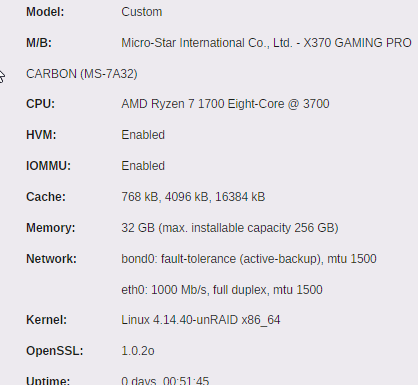

Here is my System Information:

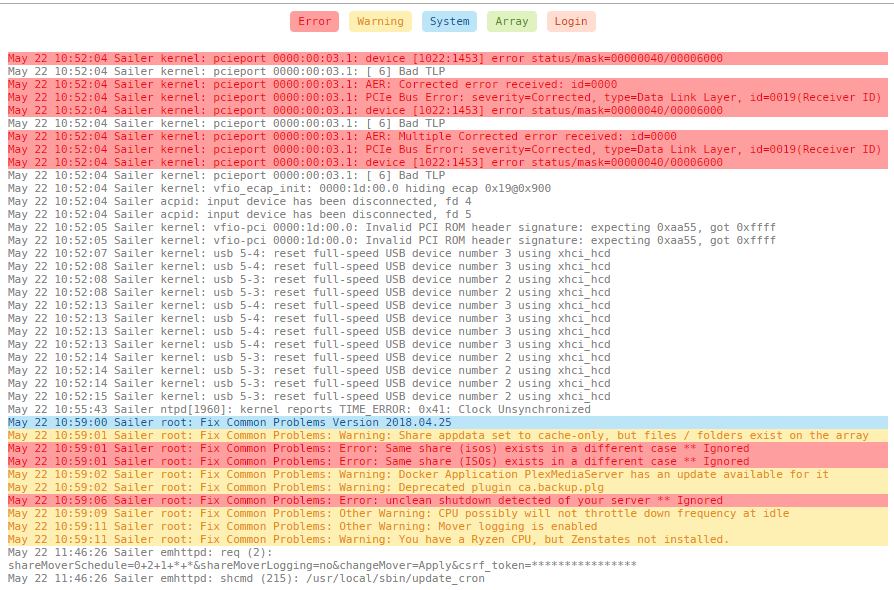

And here is the log:

Bad transaction layer packets between the CPU and PCIe port. You could try the kernel option
pci=nommconf
and, of course, don't overclock.
You need to run zenstates at system start-up.
You can choose a CPU clock scaling governor (such as "on demand") with the Tips and Tweaks plugin.

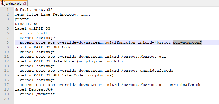

Is that the right file?
The syslinux.cfg file is also configurable from the GUI.
See Main -> Flash Device -> Syslinux Configuration
In unRAID 6.5.2 there is a possbility to switch to advanced view, which should make it easier to do changes to the configuration file.
A system restart is required to make the changes effective.

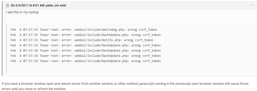

Now i did all that and removed the overclock.
and now the log shows this and there is still no sound.
May 22 14:49:05 Sailer root: error: /webGui/include/DashUpdate.php: wrong csrf_token
May 22 14:49:08 Sailer root: error: /webGui/include/DashUpdate.php: wrong csrf_token
May 22 14:49:14 Sailer root: error: /webGui/include/DashUpdate.php: wrong csrf_token
May 22 14:49:30 Sailer root: error: /webGui/include/DashUpdate.php: wrong csrf_token
May 22 14:49:39 Sailer root: error: /webGui/include/DashUpdate.php: wrong csrf_token
May 22 14:49:46 Sailer root: error: /webGui/include/DashUpdate.php: wrong csrf_token
May 22 14:50:02 Sailer root: error: /webGui/include/DashUpdate.php: wrong csrf_token
May 22 14:50:06 Sailer root: error: /webGui/include/DashUpdate.php: wrong csrf_token
May 22 14:50:10 Sailer root: error: /webGui/include/DashUpdate.php: wrong csrf_token
May 22 14:50:18 Sailer root: error: /webGui/include/DashUpdate.php: wrong csrf_token
