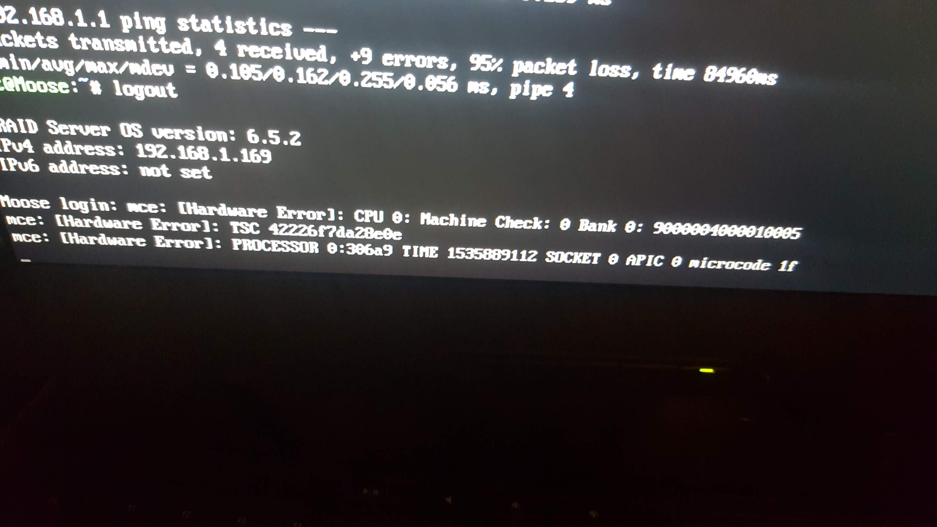

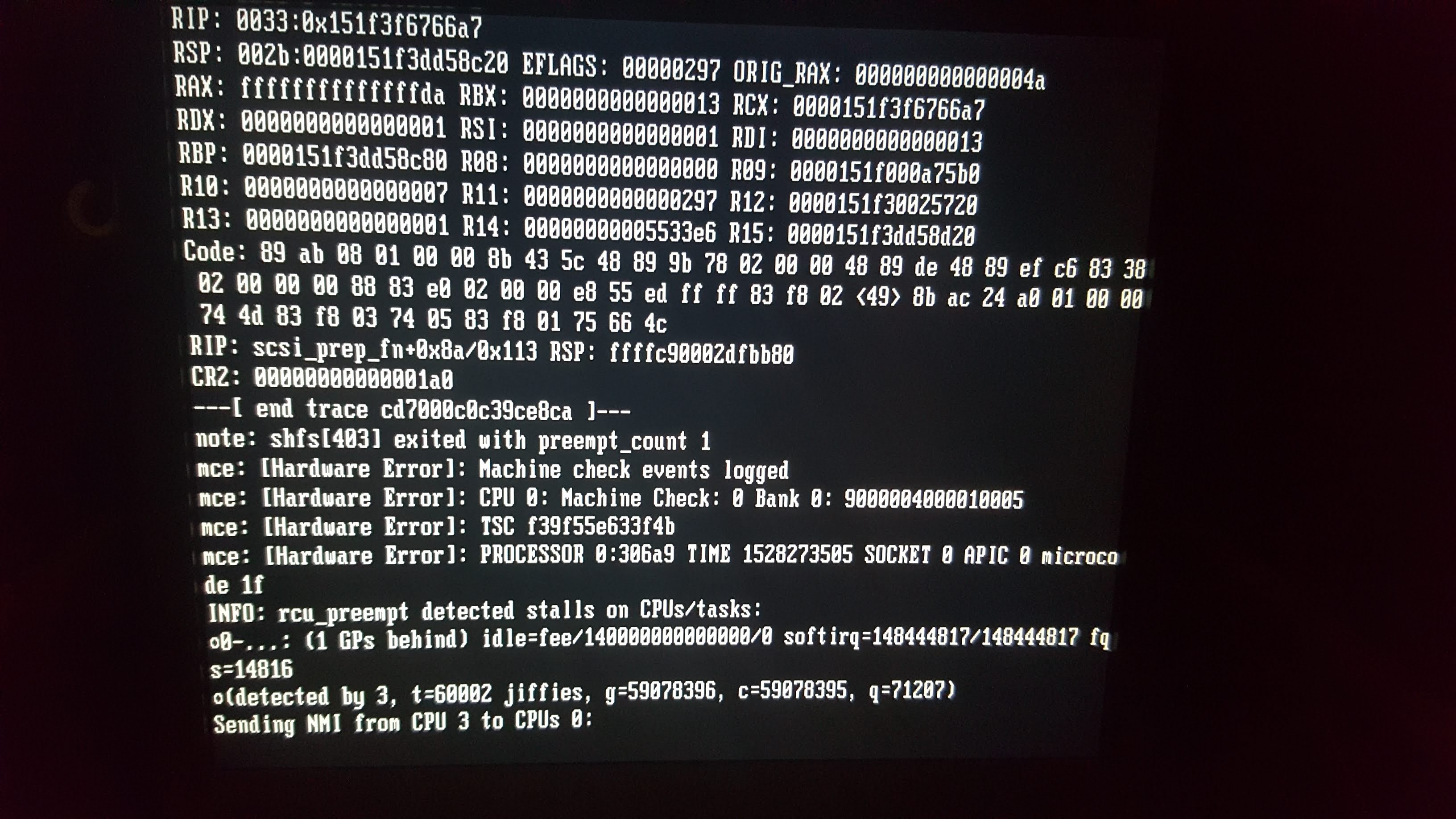

OK had another occurrence of the lockup. This time there is an MCE on the console. I've installed mcelog from Nerd Tools to capture future events if they occur.
I've attached a photo of what was on the screen and diagnostics/syslog taken by FCP troubleshooting mode.
Hope one of you gurus could have a look and see if there is any clues as to what's going on. Some more information which may be useful is that my system was completely stable with 6.3.5, but my problems started immediately I upgraded to 6.4.1. It is happening less often now on 6.5.2 but that may all be a coincidence.

Bump. Wondering if someone wouldn't mind having a quick look and see if there is anything of interest in the above screen grab or the diagnostics.
I'm thinking that my next step is to upgrade the BIOS to the latest version. I am about 5 versions behind, and various ones talk about "improving system stability" or "improving memory stability". The other thing is that there is an unused PCI-E TV card in the server. I'll probably remove that if a BIOS upgrade doesn't help.
Thoughts?
It's an hardware error, so try updating the bios (though doubt it helps), running memtest, and if nothing is detected it may be a failing board, PSU, etc.

Hi Pete,
I can't look at attachments at the moment, but focusing on the stall warning in that screenshot, I came across this kernel document detailing possible causes.
https://www.kernel.org/doc/Documentation/RCU/stallwarn.txt
Now there's plenty of possibilities, and in general your idea to update BIOS and remove unnecessary hardware is a good one, but in this case I don't think that either of those will help (please do update the BIOS though - that's almost always a good thing to have at the latest version). What might be worth trying (regarding the BIOS) is after updating, reset to default parameters, and then go through and just ensure that just the needed options are altered (saving your current BIOS config first would be a good idea if your BIOS supports that option).
The screenshot shows that the stall is on CPU 0, which I understand to be the CPU primarily used by uNRAID. I would suggest that you check any active VMs to make sure that you do not have that core bound to them. Also make sure that your CPU temperatures are ok. Thermal throttling can cause this, though I suspect that's an edge case thing. Doesn't do any harm to make sure that your cooling solution is working though (I.E. clean your CPU radiator of dust, make sure fans, etc are working, check CPU temps in web UI).
Last idea is that you check those log files to see if the stall warning is in there (as I mentioned, I am not able to look at them currently). The stallwarn document linked above advises:
To diagnose the cause of the stall, inspect the stack traces.
The offending function will usually be near the top of the stack.
...so there may be some additional clues.

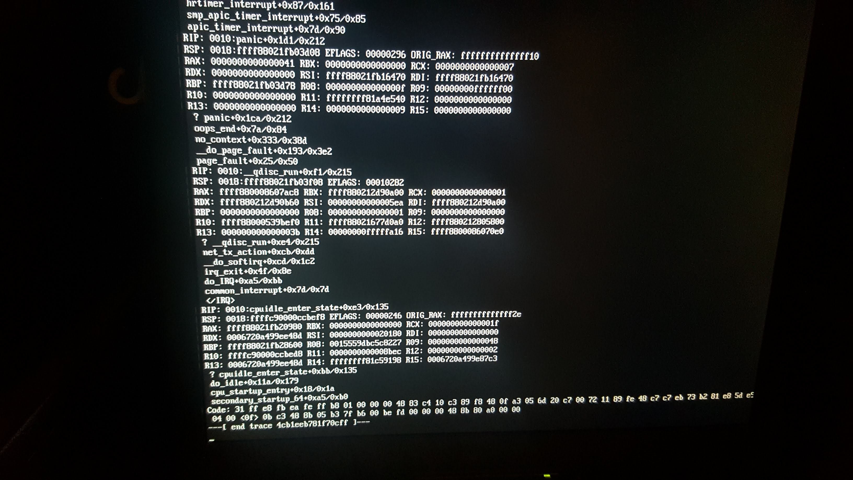

Not sure if it's an improvement or another symptom of the same problem. Once again Unraid crashed. Here is a photo of the console. I'd appreciate it if someone can review and advise.
