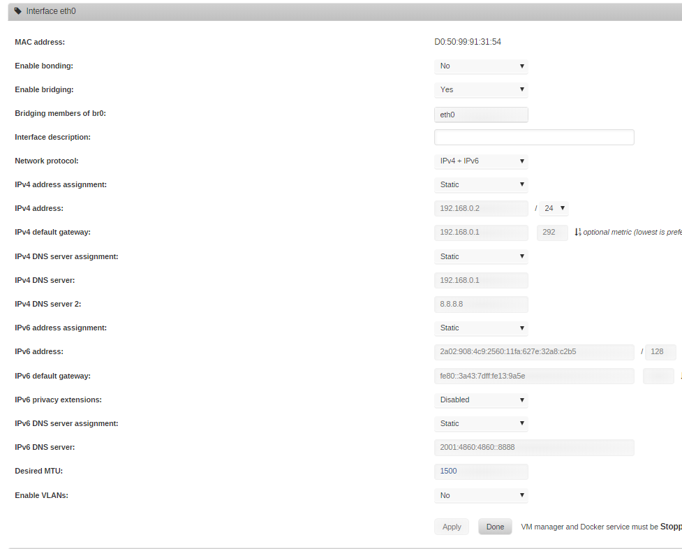

br0 is not created because there is some conflict in the network settings.
Can you post a screenshot of your network settings.
Thanks!
Hope that will make you find the mistake.
Your IPv6 address is wrongly set as a single host address (/128), it has to be defined as a subnet range (usually /64, check also your router settings).
Yay after setting it so some static IPV6 with 64 prefix everythink works fine again, THANKS!!!
