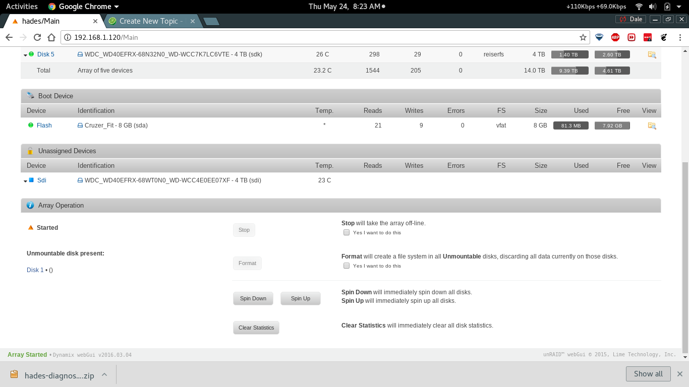

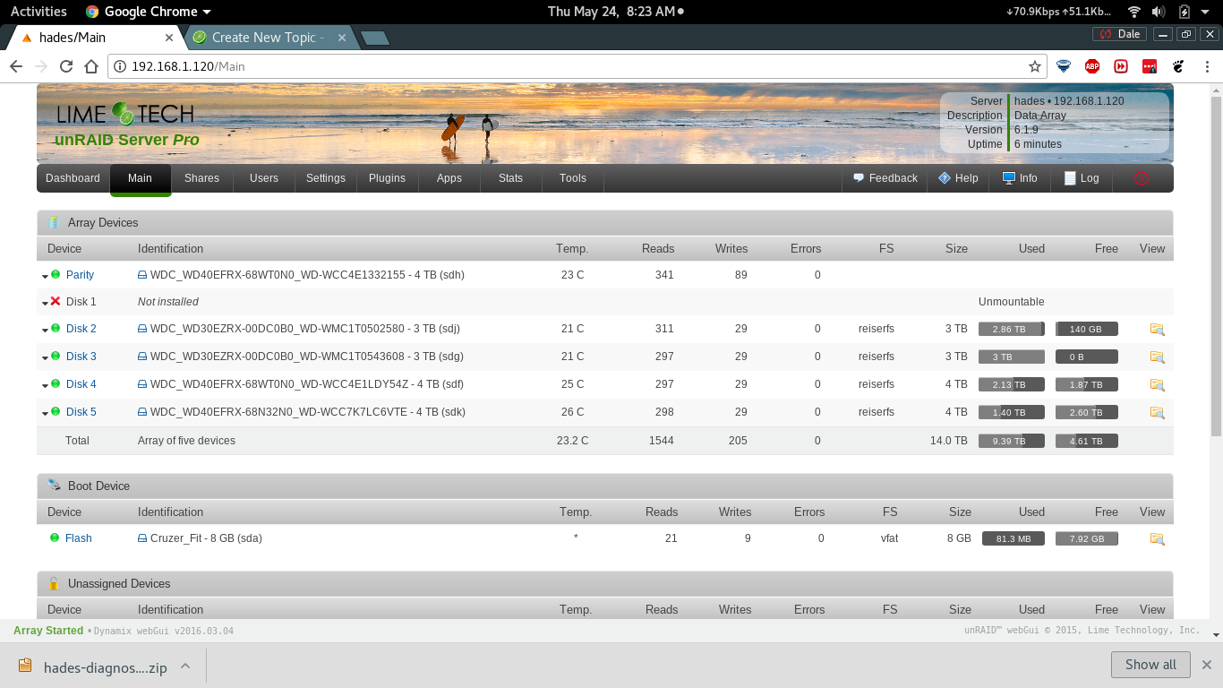

So I was having some HDD issues so I took out the HDD, I didn't stop the array and remove it first... my bad. When I rebooted it with the new HDD I assigned it to the slot and had it rebuild. After it was done nothing was mounted, and it had option to format. So I did that (it's a new drive, still have the old one with data). Which did nothing for me. Now it's at the point where I can't stop the array to change drives, I click and it does it thing but I don't get the usual window where you can assign/unassign drives.
Not sure where to go from here, all the other drives seem to be working, and I can access the data fine.
Thanks in advance for any help.
hades-diagnostics-20180524-0819.zip

SMART for all disks looks OK. The screenshot shows unRAID still offering to format the unmountable and missing (emulated) disk. So it is unclear what happened when you tried to format.

The screenshot also shows the Stop button is disabled because you haven't checked the box to enable it. Could you maybe explain exactly what you mean by this part I have quoted below?

Ya, I know you have to click the check box to get it to stop... I did solve that by disabling auto start, and can get on and assign HDDs again.

Your screenshot doesn't show a disk assigned to slot 1, so when you say you assigned it and it rebuilt the disk, that was after you took the screenshot?
Perhaps posting current screenshots and more information about exactly what is the current state of your array would be helpful. Right now it's very confusing trying to parse what happened and what the current situation is, and without accurate information telling you what to try is risky.
The old disk is out of the array, I can still access it in another machine, as well as the data on the array is still intact, the only thing that's missing is Disk 1. I do believe after playing with it more I am facing a DOA HDD. That's why I'm having trouble with the unmountable error, I did not preclear this one. I have ordered a new one.
Disk 1 has the brand new 4TB HDD in it, that is apparently not working. I assigned it, and rebuilt it (or I thought anyways, as it didn't work) the screenshots are of the array as it is right now.
