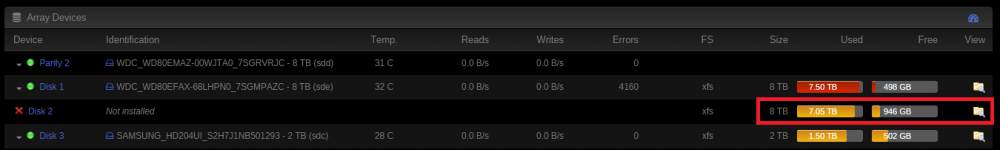

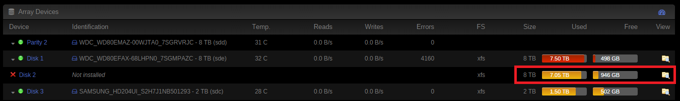

I had an 8TB array disk fail.  After restarting my server I noticed that a lot of my library was missing(Had 1500 movies, can only see 500). Plex couldn't see an number of my folders and about a third of my media was visible through windows. Upon further investigation, I found that when I went to the "Shares" tab and drilled down through my media folder everything was missing from there as well. This had me confused because the size of my array hadn't changed. I went to the "Main" tab to confirm what I was seeing but it seems that my missing files are still there and visible on a drive-by-drive level. To summarize; drive died, can't see most of my files on the "share" but files still exist if I look at each drive on the "Main" tab. Any help would be greatly appreciated. I have no idea how to get my media share to show all of my files again.

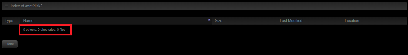

Should I be able to view the files of an emulated drive from the "Main" tab? unRAID is showing the capacity but when I click the view icon there is nothing there.

You have filesystem corruption on disks 1 and 2, you need to run xfs_repair, but before that you need to figure out why so many read errors happening on several disks, disks 1, 2 and parity2.
Do I run xfs_repair on each drive?
