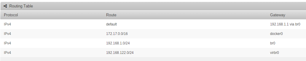

I'm not sure what that means but here are my network settings:

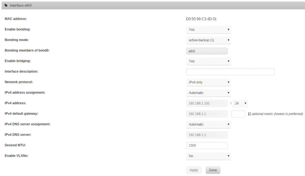

@dnLL Would you mind trying something for me, please? Go to Settings -> Network Settings in the GUI, and under the heading Interface eth0 set Enable bonding to Yes. You'll need to stop the Docker and VM services first to be able to do this - probably the easiest way is simply to stop the array. Leave the bonding mode set to active-backup and leave eth0 as the sole member of bond0, like this:
Now click the Apply button, then restart the array. Now do your ping test again and report back.
I notice your motherboard has two main NICs (plus the IPMI one). At the moment you're only using eth0 (the one using the i210 chip), and eth1 is unplugged. Have you decided how you want to use this second port?
EDIT:
I should add that my reason for suggesting that you enable bonding is because that appears to be the default unRAID setting, even if only a single NIC is present. One of my servers has only one NIC and has bridging enabled, but it also has bonding enabled (per the screenshot) and I have no problem pinging.

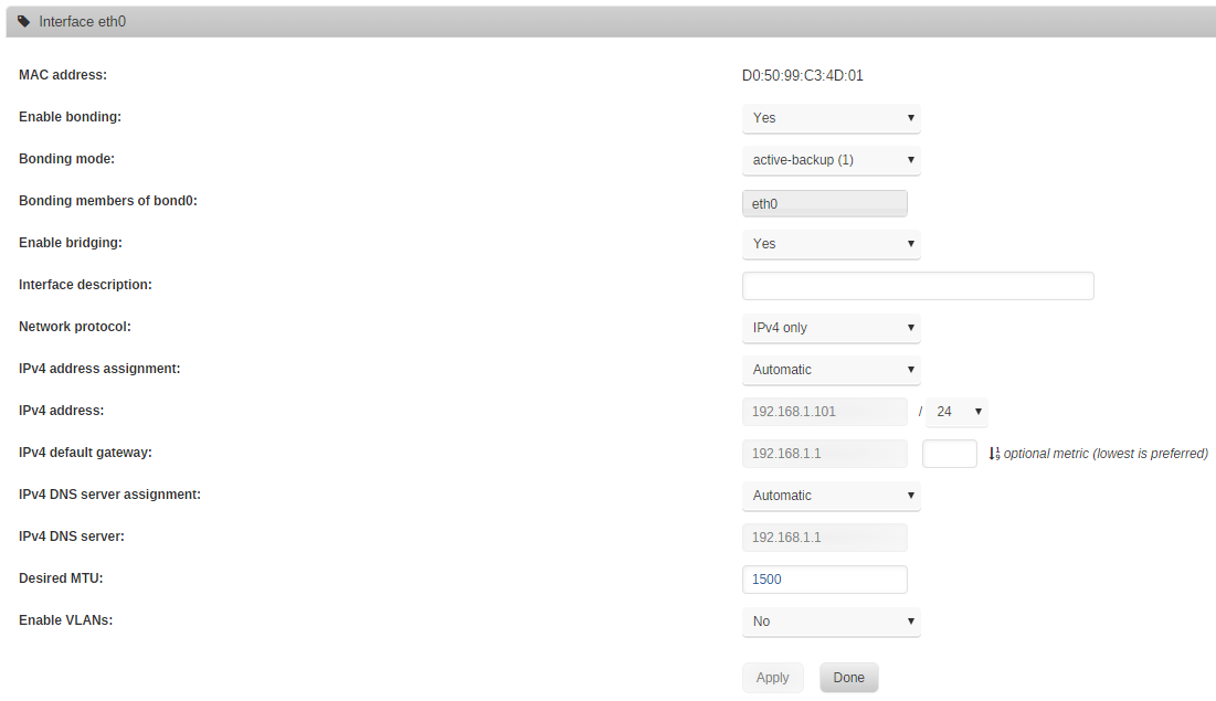

EDIT:

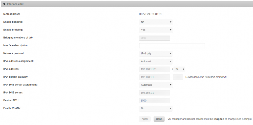

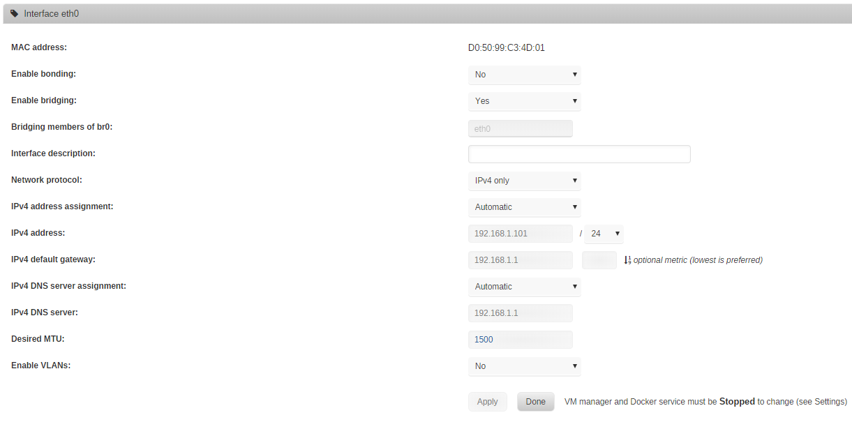

I'm a first time poster. I'm struggling to get my network configuration correct. So, the default setting of bonding starts up okay. What I've been trying to do is turn off bonding, and have bridging enabled for both ports.
Currently, my server's two gigabit ports are plugged into a Netgear wireless extender connecting to my router. This is temporary until I can find time to wire in more network ports at home.
What I'm attempting to do is have dockers running for typical services. Example:
  • Nextcloud
  • Calibre
  • Sonarr
  • Kodi
Ideally these would be running on the first ethernet bridge. I would then like to have another dedicated ethernet port bridged with a static ip address that will act as reverse proxy, multi factor authentication, etc. Would this be better served through a VM rather than a docker,  I wonder??
When I attempt bridging each port, it only recognises br0 and cannot see br1. br0 appears as custom br0 under docker network configuration. I've read up as much as I can. I have deleted my network configuration, tried setting my br0 as a static ip address, and br1 with no ip address so that it can be added in each docker instead, as suggested in a separate post. I've also tried more typical scenarios of assigning br1 with an ip address, etc. What isn't clear is that the second ip address cannot be assigned dns and gateway settings separately to br0. Not through the GUI anyway. The most I can get it to do is come up with an automated route of 'link'. I'm assuming to use br0 as a gateway to the router's gateway. Have I got this part wrong?
Currently, I've just deleted my network configuration and am starting again.
