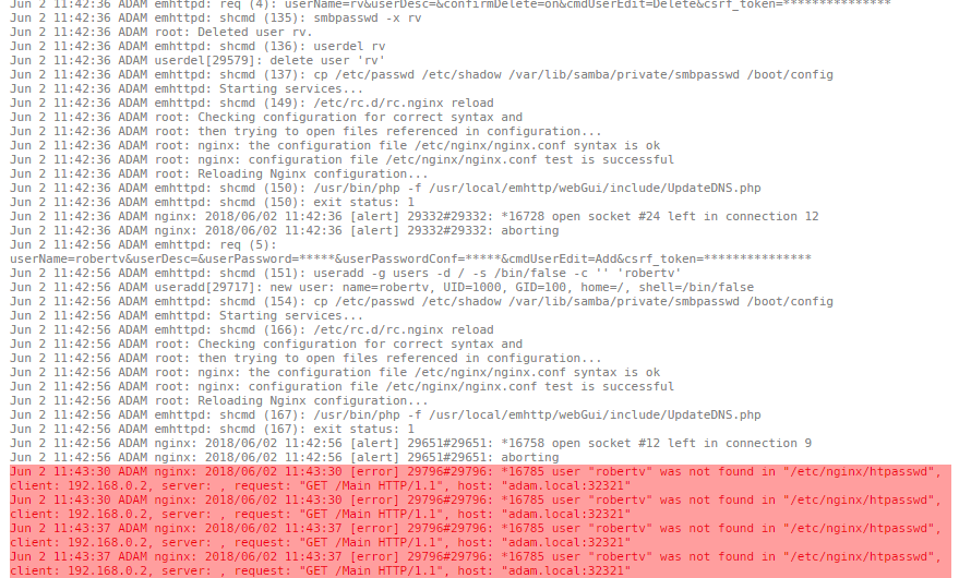

I create a new user and it appears to save fine.
When I try to login to that user it never works and throws an error:
Jun 2 11:43:37 ADAM nginx: 2018/06/02 11:43:37 [error] 29796#29796: *16785 user "robertv" was not found in "/etc/nginx/htpasswd", client: 192.168.0.2, server: , request: "GET /Main HTTP/1.1", host: "adam.local:32321"
Video and Log output below. I'm not a Unix person so I'm not getting what this could be. Any ideas?

Sorry about the video stuttering and glitching. Ther terminal wasn't being recorded at all well. Hopefully the log file will show what's needed.
Unraid users are for file access, not WEBGUI. Only root can log in to the WEBGUI, and root is not allowed network file access.

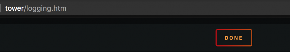

@Wisnaeme How do you get the scrolling logging.html page? When I try that, it just shows a DONE button and if I go to /log/syslog, it just downloads the syslog file.
The log button on the menu bar displayed on every page. If it isn't working for you maybe you have something blocking it. Whitelist your server and/or try another browser.
Thanks. I see it now. It opens a popup to that URL and works (displays the log) but if I enter that URL in a new tab, I get that DONE button. Weird:
Another way to see the syslog is this:    Tools   >>>   System Log    That will allow you to see the entire syslog from the start of the bootup.   You can also use your browser's search function to find specific nomenclature/words in the syslog.
