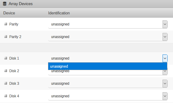

Disk's are unassigned
Hello I've just installed unraid and just flashed the Dell H200 to IT mode. So I put an SSD and a 2TB drive in to the drive bay, and unraid doesn't seem to see them. is it possible I flashed the H200 incorrectly?

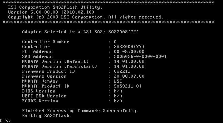

When I power the server on it will say the VGA accelerator, then it will display a POST screen allowing me to access the regular BIOS, then it will boot to unraid. Before I flashed the card it did present a screen about configuration but I never did anything there and went straight for the flash. I've included the information about the card when I ran " sas2flsh.exe -c 0 -list" if it helps. I followed this guide roughly.

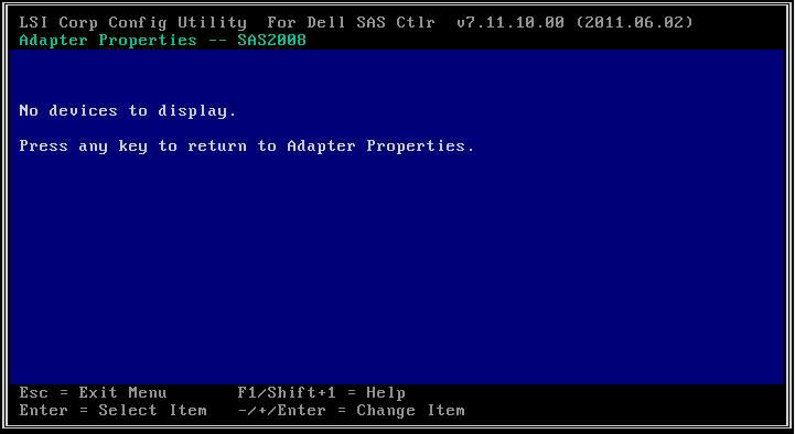

Well I reflashed the card and I installed the BIOS for it. So it now displays that image. When the server is powered on the drive activity light will flash once on the hard drive bays but that is all they do.
You'll need to test with other cables, disks or enclosures to try and find where the problem is, if you have a breakout cable connect a disk directly to the HBA.
