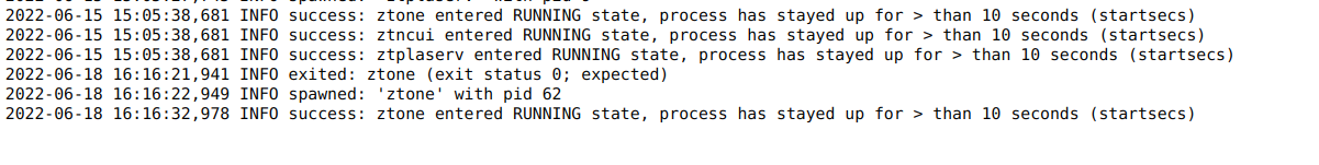

Using ZTNCUI my zero tier server is crashing at random intervals. "exited: ztone (exit status 0; expected)" is the last thing it says before going offline. Restarting the container makes it work again until the next random crash. Any ideas?
I think I've figured out a solution. I'll create an update if I'm still getting issues.
First go into your ztncui appdata folder and create a file called supervisord.conf. Open it and paste in the contents of your container's "/etc/supervisord.conf" file. You can get the contents by: Opening the console, cd /etc/, cat supervisord.conf
Edit your appdata supervisord.conf once more and add a line to the [program:ztone] section that says 'autorestart=true'. This should in theory force ztone to restart whenever is exits expectedly(which I was getting) or unexpectedly.
Finally navigate to your container and add a new path:
Config Type: Path
Container Path: /etc/supervisord.conf
Host Path: /mnt/user/appdata/ztncui/supervisord.conf
Press apply and it should all boot fine. You can check the container has picked up your supervisord.conf file by doing what we did previously using cat inside the container console. It should show our new autorestart line.
Edit: A few days later after these changes ztone tried to exit and it auto restarted. Everything working normally as if nothing happened.
Edited by jimrummy101

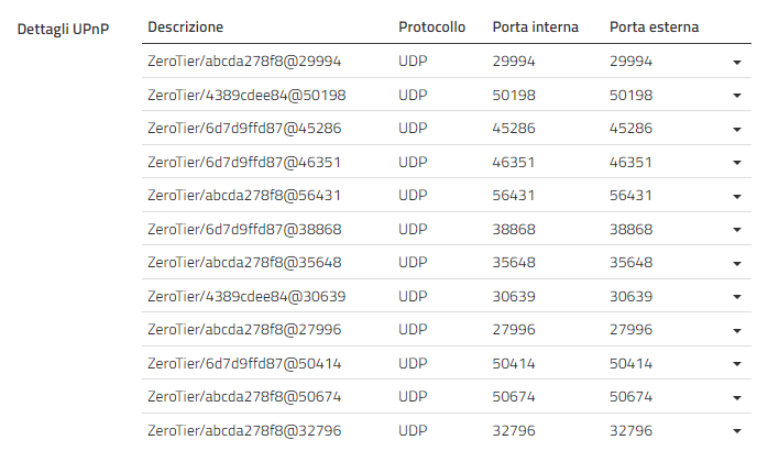

Hi, for a few days my unraid no longer connects to the zerotier VPN or does it for a few minutes and then goes offline.
I have not made any changes to the server or to the router, I accidentally noticed it while trying to connect from outside the home.
I enclose some information, hoping it will be useful:
From the logs of the docker:
connect: Operation timed out
connect: Host is unreachable
/ # zerotier-cli info
200 info abcda***f8 1.10.2 OFFLINE
/ # zerotier-cli listnetworks
200 listnetworks <nwid> <name> <mac> <status> <type> <dev> <ZT assigned ips>
200 listnetworks a0cbf4b****1148 IlPixelMatto 4a:ba:63:**:ce:0c OK PRIVATE ztc3***j3c 192.168.191.12/24
/ # zerotier-cli listpeers
200 listpeers <ztaddr> <path> <latency> <version> <role>
200 listpeers 62f865**71 - -1 - PLANET
200 listpeers 778cde**90 - -1 - PLANET
200 listpeers cafe04**a9 - -1 - PLANET
200 listpeers cafe9e**b9 - -1 - PLANET
The router has automatically created:
There are no changes on the zerotier website
Anyone have any idea what may be causing the problem? My provider is fastweb which is under NAT.
Thanks!

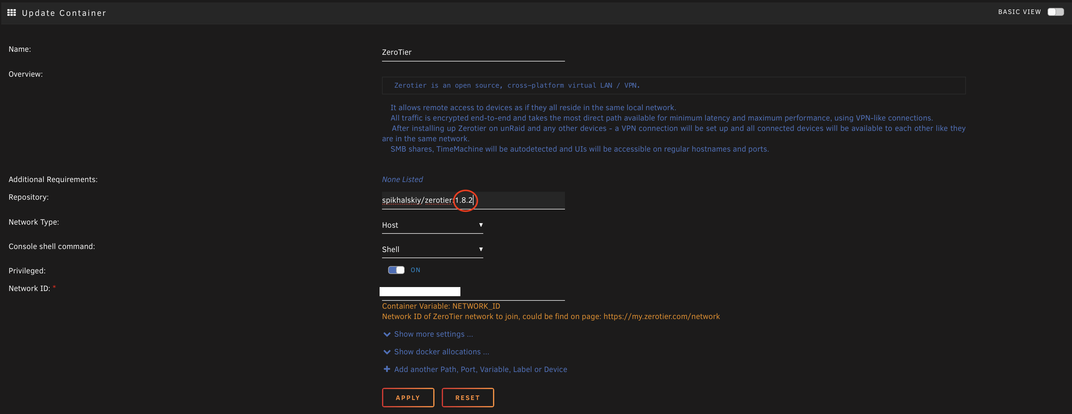

@ilpixelmatto 4 days ago I upgraded the container from 1.8.2 to 1.10.2. If you want to check if that is what causes your instability, you may downgrade by specifying a tag "spikhalskiy/zerotier:1.8.2" and see how it behaves.
723041920_Screenshot2022-11-11at10_54_34AM.thumb.png.0bf167af26768e9c96d563a4339e88d2.png
Edited by Dmitry Spikhalskiy

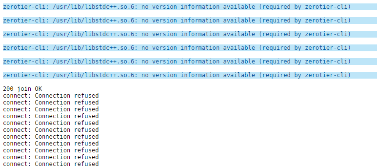

I try with the "old" 1.8.2 but I have the same problem, I don't understand where is the problem, I don't have made any change in mounths.
But now the zerotier-cli info tell me this:
zerotier-cli info
zerotier-cli: /usr/lib/libstdc++.so.6: no version information available (required by zerotier-cli)
200 info abcda278f8 1.8.2 TUNNELED (on my.zerotier is offline 1H 34M)
