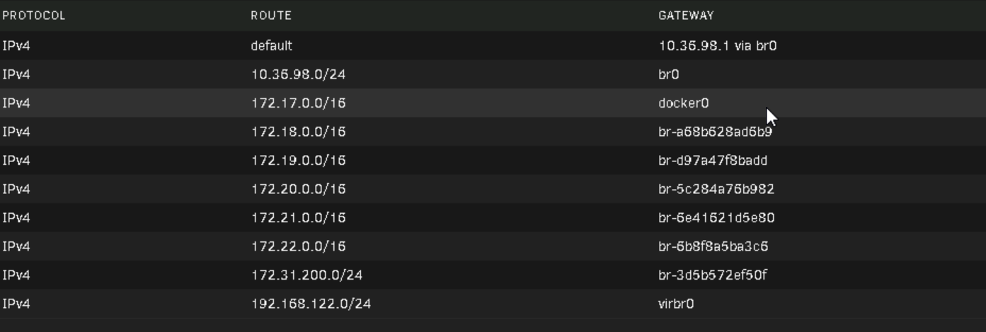

  • For anyone looking for a solution, I was able to connect to my unraid 6.12.2 from a phone on zerotier 1.10.6.   Just go to settings -> Network Settings. In Routing Table section find your

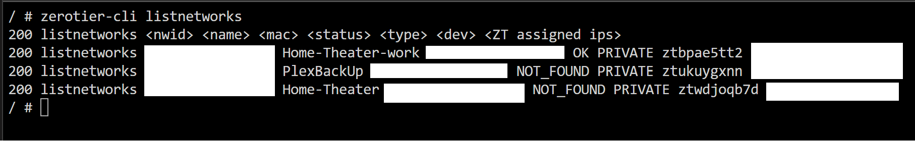

Hi Everyone
any idea on how to delete/remove the unused networks
I already deleted them from Appdata/..../networks.d
but they still show in docker cli and Unraid network setting
Thanks In Advance
Just go to settings -> Network Settings. In Routing Table section find your zerotier ip and copy interface name from gateway column. Paste the interface name into "Include listening interfaces" field under Interface Extra section, hit apply, and it should all be working.
