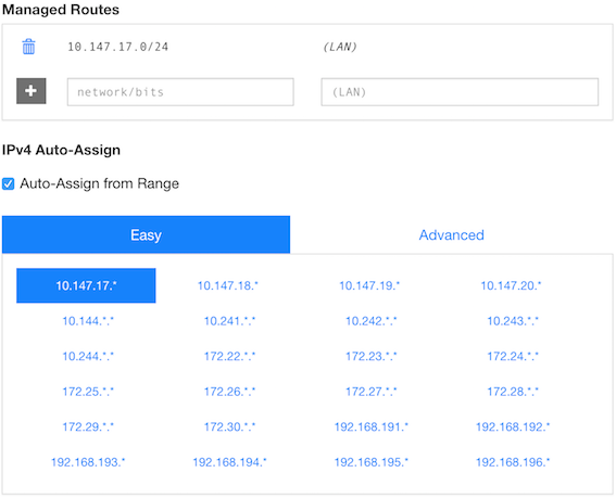

  1. Create a https://my.zerotier.com/ account and create a Network there.
  2. Get an ID of the created network (looks something like b4da7454b271902c).
  3. Install this docker image on your unRaid using a template or from Community Applications and put that ID as a NETWORK_ID parameter of the container.

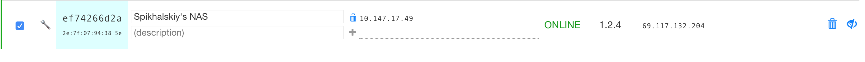

  4. After a start of the docker go to https://my.zerotier.com/network/<NETWORK_ID> to “Members section” area. Check “Auth” checkbox for the new device. Assign a meaningful name to it, copy an IP from "Managed IPs" column - it will be a static IP of your NAS in your virtual network.
  5. Install a Zerotier client to your laptop/phone/other devices, join a network with the same id and repeat the previous step for them.
Now, when you connect Zerotier on any of your devices - a VPN connection will be set up and all connected devices will be available like they are in the same network. SMB shares/TimeMachine will be autodetected, UIs will be accessible on <ip from the step 4>:<usual port>.

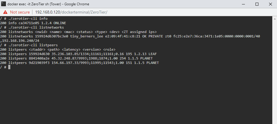

If you post about an issue, it will be helpful if you open a console of the docker from webGui, run and include in your post an output of the following commands:
./zerotier-cli info
./zerotier-cli listnetworks
./zerotier-cli listpeers

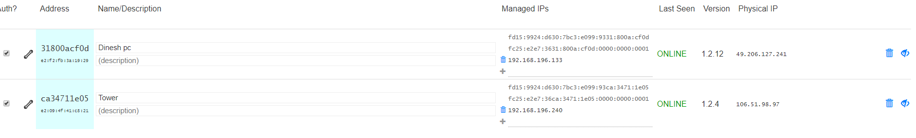

It was working before but its not now. I tried to connect my tower to a remote pc today and i cannot access my tower. Not sure what am i missing here. Assistance please.
Edited by ThePhotraveller
Adding extra console info.

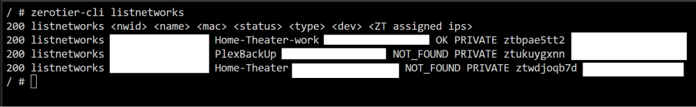

Is this container still maintained? I'm unable to connect to my server from my phone with zerotier running... Attaching my setup.
