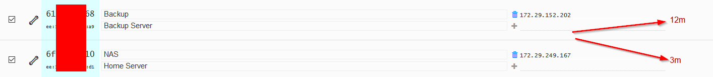

I keep having my main and backup server drop offline:
473212675_2019-09-0813_19_15-ZeroTierCentral.thumb.png.57c5bdf8e71d6da28cf20a5813e0227a.png
If I restart the docker, they will, of course come back up. On a couple of occasions, I've browsed to the ZT IP address from Win Explorer, and the server has responded, and my.zerotier will then show that it's online. Of course, this is NOT very helpful if I'm not at home and am trying to get access to the server.
This is all I see in unRAID's log for the ZT container:
200 join OK
200 join OK
200 join OK
200 join OK
Again, not very useful...
I'm running the default 1.2.12 build version on both of my servers. Any idea why this is happening or what I can do to fix it?

Thanks for that suggestion @spants. Unfortunately, this seems to be bouncing at random...
It now reads:
Backup            Online
NAS                 Online
I had not restarted either docker, and when I first looked a minute ago after seeing your response, NAS, was 13 minutes since it had last been seen. By the time I'd quoted your message and typed that first bit of mine, it had come back online.
Is there any logging anywhere that is going to show me something more useful than "200 join OK" that might help diagnose the issue?
Update: Now they're showing offline for 6 and 4 minutes...

@FreeMan It's really hard to tell, never had anything like that. You can get really a lot of useful information about the zerotier current state running these 3 commands:
./zerotier-cli info
./zerotier-cli listnetworks
./zerotier-cli listpeers
But Zerotier client doesn't produce a lot of logs at all, so it's hard to get a history of states and reasons of their changes. There is a build flag that allows to build Zerotier in a "trace" mode, but it's PITA.
Can you get an output of these commands when your servers are shown as off in Zerotier console? You obviously need to be in a local network for it. Also, are you sure that it's not legitimate network disruptions? Did you check this theory?
You also can give it a try and check 1.4.2 tag that I published for testing:
 It works stably for me for a long time already.
Edited by Dmitry Spikhalskiy
