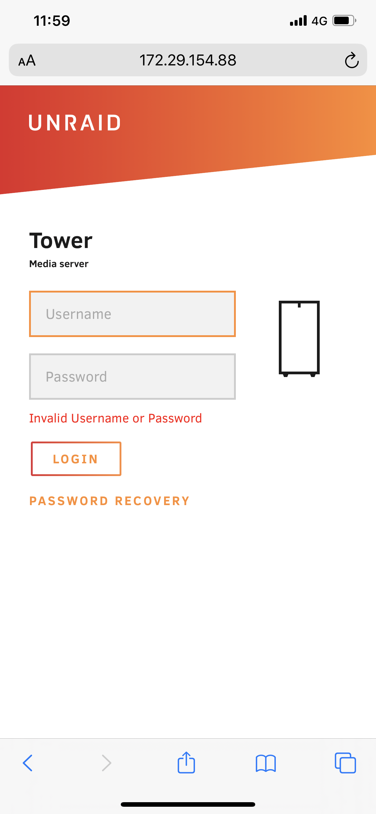

Works a treat to connect my iOS devices to the unraid server shares with apps like Files and VLC.
I've encountered a problem though. When using a web browser on my iPhone and trying to open the unraid web UI with the ZeroTier ip adress I can't get past the login screen. It doesn't matter what user I try, It only comes back as invalid.
Any idea what's causing this? It would be nice to remote access the server UI as well as just the shares.

  • For anyone looking for a solution, I was able to connect to my unraid 6.12.2 from a phone on zerotier 1.10.6.   Just go to settings -> Network Settings. In Routing Table section find your
There is only one user that will work and that is the root user/pw. Anything else will fail.
OK, but root didn't work either?!
Can you log into the webui from a web browser locally with root, or ssh into the server ok? If not, you should maybe google how to reset your root password. Can't remember the specifics right now.
Yes, no problem logging in as root to webUI. Just realized that its not possible to login to the webUI with other user than root. But still couldn't login to webUI using root in iOS safari over ZeroTier.
OK now I got it to work. When I disabled the SwiftKey keyboard on the iPhone and used the built in it worked. Weird!
Just now, kim_sv said:
Weird!
Indeed :P

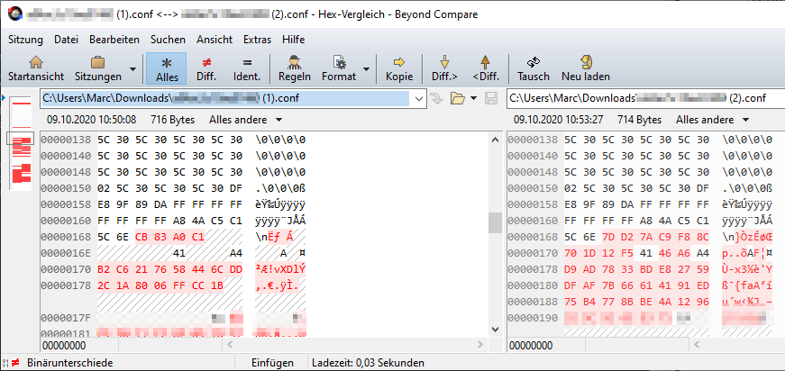

@Dmitry Spikhalskiy
Do you know why /mnt/user/appdata/zerotier/zerotier-one/networks.d/*.conf is updated every minute? This totally hinders disk spindown / sleep states.
I compared the recent file version with one that is 3 minutes old and the content is different. But what is so important that it needs to be updated every minute?
Or this is an issue which I should post at ZeroTier's GitHub Page?

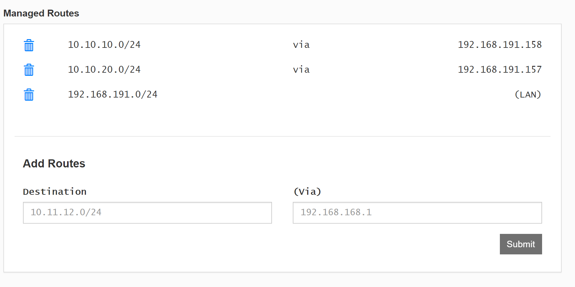

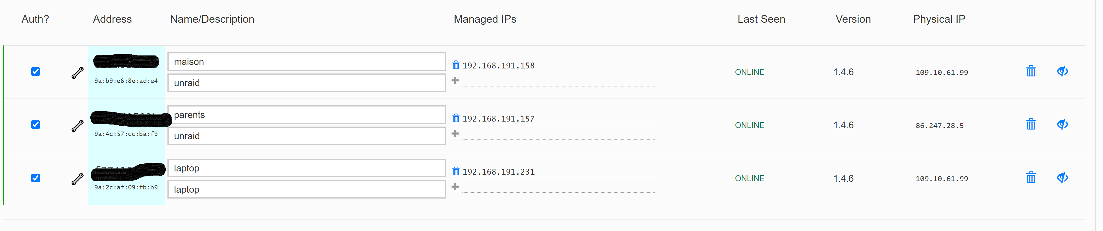

I am trying to setup a lan to lan access. But it constantly fails and I am running out of solution.
I have 2 unraid servers with docker zerotier installed. Zerotier is working correctly. All peers can connect to other peers. In this network, I have 3 peers, 2 servers and my laptop with zerotier installed. Then I have dozen of computers, routers, NAS and printers on each LAN.
Each server is in a private LAN. 10.10.20.x and 10.10.10.x
10.10.20.10 is the server running docker in the LAN 10.10.20.x
10.10.10.10 is the server running docker in the LAN 10.10.10.x
My laptop is also in 10.10.10.x (the weekend) or 10.10.20.x (during the week). And sometimes during the week connected on external network (cell phone or private wifi).
My problem is that I can only connect to servers, and not to peers in LAN.
On both servers I have enable ip forwarding and update iptables as following:
PHY_IFACE=eth0; ZT_IFACE=ztmjfbsomh
iptables -t nat -A POSTROUTING -o $PHY_IFACE -j MASQUERADE
iptables -A FORWARD -i $PHY_IFACE -o $ZT_IFACE -j ACCEPT
iptables -A FORWARD -i $ZT_IFACE -o $PHY_IFACE -j ACCEPT
the ZT_IFACE is the name of my net adaptator.  and it is the same name on the 2 servers.
for example, when I try to ping my WAN router of the LAN 10.10.20.1 :
failed from 10.10.10.10
failed from 10.10.10.160
works from 10.10.20.10 (of course, in the same LAN, no zerotier)
when I ping the zeroteir server of the LAN 10.10.20.1:
works from 10.10.10.10
works from 10.10.10.160
so both servers are inter connected succesfully on zerotier network. And from my laptop I can access succesfully unraid http interfaces.
only LAN access is not working. ZeroTier works well to interconnect peers having zeortier running on.
What do I miss ?
Zerotier dockers are running on host network.
please help.
Not sure why you enabled NAT on eth0 of your server, when there is already an WAN Gateway (that should do that).
...for site-2-site routing, you need to add corresponding routes to either side, not just enabling/unblocking the firewall between interface.
For all LAN-clients to do use this, this setup configuration should be done on the main gateway of each LAN, aka the WAN router.
Each client will use their default gateway to address traffic outside their own network, which is the WAN router (or whatever is configured via DHCP anyway).
So, like you did in zerotier-central configuration, add a corresponding route on each side.
You'll need two routes.
  1. enable the route to your network in zerotier central (192.168.191.0/24 with gw 10.10.10.10 (and 10.10.20.10 on the other LAN)
  2. enable the route from 10.10.20.0/24 to 10.10.10.0/24:  add route to 10.10.10.0/24 with gw 192.168.192.x  where x is the IP of your zt interface on 10.10.20.10)...do likewise on the other side/server.
...and allowing to pass traffic for "inside-LANs" though the WAN-routers Firewall (no nat), like you did on the unraid servers (there, you do not need/want this ).
But since you enabled NAT on eth0 of your servers, maybe they are the WAN interfaces in your network?
