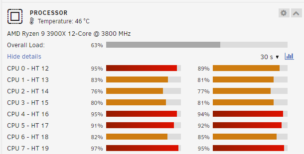

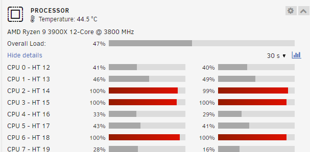

Why does ESPHome utilize all the processors available to my docker service when building the firmware to update an ESPHome device?
Probably due to all the disk I/O and that's the UnRaid not the container. You can try mapping to the folder /cache in the container to say /tmp/espcache on the host. If of course you have enough memory to hold the temp files. It speeds things up quite a bit.
Yup it's dialed now. Thank you sir. is this worthy of a template update? I feel like this should be standard.

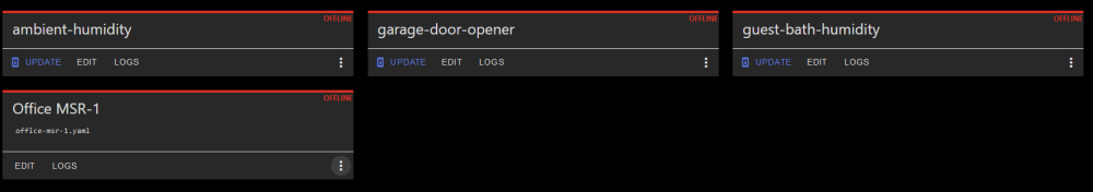

I have been running the ESPHome docker for quite some time now. I managed to build 3 ESP devices of my own, but when I look at them in ESPHome, they always say OFFLINE.
What am I missing here? Is it a network config issue? I've got it set to HOST, which, I believe, is the default...
Please LMK what other info you need to help me out.
Host should work but if you have vlans involved mdns might be me making it across and need an mdns repeater enabled. You can turn on the ping option environment variable
That was all Greek to me, so I'm gonna say "no". The only time I've changed Host to Bridge or vice versa is on direct instructions from someone trying to help me fix something. No VLANs MDNSs or anything else fancy. All devices (except internal dockers) have a 192.168.*.* IP address.
Took a look at the ESPHome config page and don't see a Ping option. Is that something that needs to be manually added?
UPDATE: Yes, sorry, I do see the use ping and it is set to 'true'. I set that a week or so ago, and things remain offline.
Edited by FreeMan
Host is what it should be set to. Can you hit the logs on the devices and do they show?
No dice:
INFO ESPHome 2023.11.4
INFO Reading configuration /config/ambient-humidity.yaml...
INFO Starting log output from ambient-humidity.local using esphome API
WARNING Can't connect to ESPHome API for ambient-humidity: Error resolving IP address: [Errno -2] Name or service not known (APIConnectionError)
INFO Trying to connect to ambient-humidity in the background
1 minute ago, FreeMan said:
No dice:
Sounds like your network has mdns issues and can't resolve the names. You will have to go the route of giving them reserved IPs on your router. Then doing a use_address in your wifi section of the yaml of each device.
Unbelievably, I had it set to `bridge`. Changing it to `Host`, however, hasn't fixed the issues.
Remove the use ping maybe?
Winner, winner, chicken dinner!
Amazingly, that fixed it. I must have, for some odd reason, initially installed this in bridge mode and just never realized it. I've never had this ESPHome docker recognize any of my ESP devices. I'd built a couple, used this to edit the YAML, but then installed it through an ESPHome installed on my desktop...
TYVM!
Esphome is finnicky about networks and such. Probably the biggest down fall of the project but once you get it working it isn't an issue.
