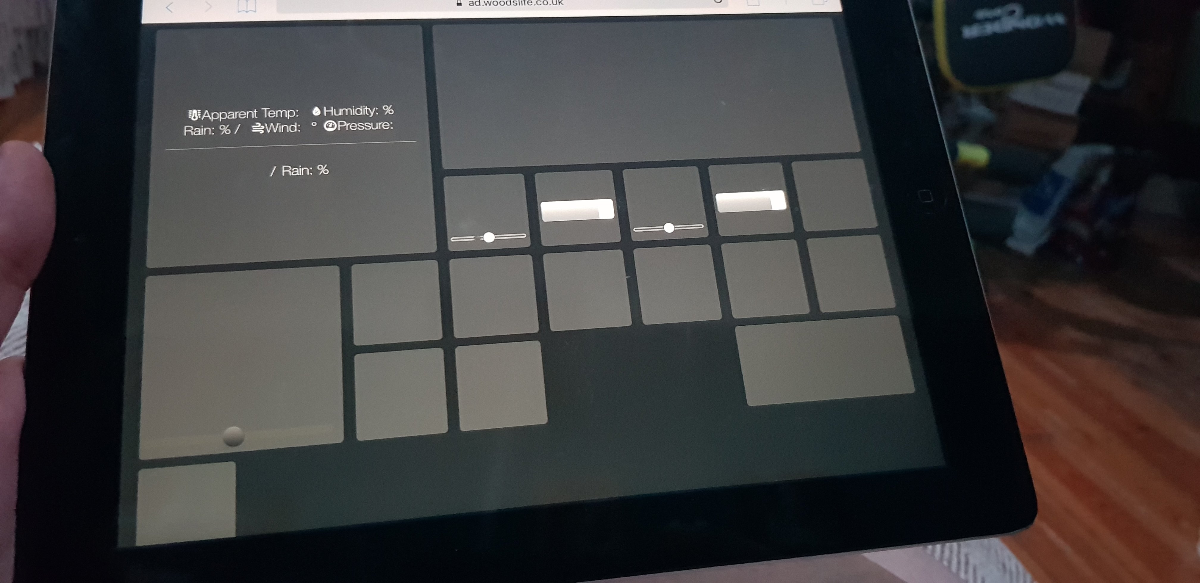

April 7, 20197 yr RESOLVED! Evening all, Any idea why all my squares on my dashboard have become blank in IOS 9? Seems to be working fine on android / PC, having the same problem in IE11, but working in chrome and edge. TIA. Karl 2019-04-07 18:31:31.243829 INFO Compiling dashboard '- Downstairs' 2019-04-07 18:31:31.397454 INFO Loading custom widget 'climate_select.yaml' 2019-04-07 18:31:31.397601 INFO Loading custom widget 'media_select.yaml' 2019-04-07 18:31:31.397667 INFO Loading custom widget 'media_with_volume.yaml' 2019-04-07 18:31:31.397723 INFO Loading custom widget 'baseclimateselect' 2019-04-07 18:31:31.398216 INFO Loading custom widget 'basemediaselect' 2019-04-07 18:31:31.398715 INFO Loading custom widget 'base_media_with_volume' 2019-04-07 18:31:31.399072 INFO Loading custom widget 'base_light_with_colorpicker' 2019-04-07 18:31:31.399378 INFO Loading custom widget 'light_with_colorpicker.yaml' 2019-04-07 18:31:31.399436 INFO Loading custom widget 'baseslider_new' 2019-04-07 18:31:31.399742 INFO Loading custom widget 'new_input_slider.yaml' 2019-04-07 18:31:31.399803 INFO Loading custom widget 'light_with_brightness.yaml' 2019-04-07 18:31:31.399864 INFO Loading custom widget 'base_light_with_brightness' 2019-04-07 18:31:31.400168 INFO Loading custom widget 'baseiconsensor' 2019-04-07 18:31:31.400462 INFO Loading custom widget 'baseiframe' 2019-04-07 18:31:31.400759 INFO Loading custom widget 'baseradial' 2019-04-07 18:31:31.401053 INFO Loading custom widget 'baseselect' 2019-04-07 18:31:31.401344 INFO Loading custom widget 'baseslider_vertical' 2019-04-07 18:31:31.401637 INFO Loading custom widget 'basetemperature' 2019-04-07 18:31:31.402099 INFO Loading custom widget 'camera.yaml' 2019-04-07 18:31:31.402178 INFO Loading custom widget 'heater.yaml' 2019-04-07 18:31:31.402235 INFO Loading custom widget 'iconsensor.yaml' 2019-04-07 18:31:31.402289 INFO Loading custom widget 'input_select.yaml' 2019-04-07 18:31:31.402340 INFO Loading custom widget 'radial.yaml' 2019-04-07 18:31:31.402397 INFO Loading custom widget 'readme.md' 2019-04-07 18:31:31.402454 INFO Loading custom widget 'temperature.yaml' 2019-04-07 18:31:31.402509 INFO Loading custom widget 'vertical_input_slider.yaml' 2019-04-07 18:31:31.402562 INFO Loading custom widget 'swipe_light.yaml' 2019-04-07 18:31:31.402605 INFO Loading custom widget 'baseswipe_light' 2019-04-07 18:31:31.402937 INFO Loading custom widget 'baseheater' 2019-04-07 18:31:31.467830 INFO function [get_dashboard] finished in 224 ms This issue turned out to be related to "baseswipe_light" All Sorted now. Edited April 9, 20197 yr by karldonteljames Added Image
