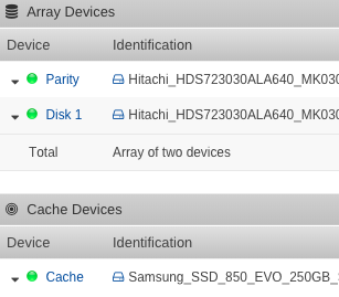

I am using unRaid on a trial basis at the moment and the biggest hang up is the transfer speed. I've performed a search on the form and there are plenty of threads on the subject and I still cannot arrive at a solution.
I have an N54L with 16Gb RAM and currently it is running a 3Tb Hitachi  Deskstar parity, a single Hitachi Deskstar 3Tb data drive and a Samsung Evo 850 250gb for cache. Previously running W2012 server with transfer speeds up to 110Mb/sec.
Initial sync was between 32-38Mb/sec.
Internal Transfer from Unassigned 2Tb WD Red to parity storage peaking at 50Mb/sec. My understanding is that with a cache drive this should be at 90Mb/sec especially as there are only two drives in the array (parity and data). The cache drive is doing didley squat apart from hold the apps/vms.
I have read about an N54L build with Cache enabled in the BIOS which yielded a decent throughput but I don't want to do that as I don't have a UPS.
I plan to add a second Hitachi 3Tb drive to array to increase storage to 6Tb total, run Plex server, and a few VMs (linux distro testing and one for VMS (CCTV, which will record to the unassigned 2Tb WD Red drive).
Screenshot attached of setup. I'm hoping that adding another drive does not half the speed again... I'm would like to test turbo/reconstruct write but I'm not sure how it works yet, ie. the risks involved. Am I expecting too much of my N54L?
