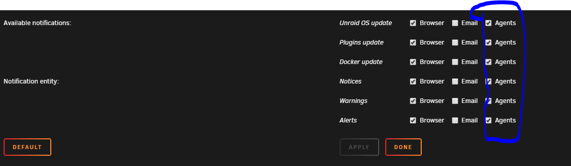

found out , that this part had to be enabled also

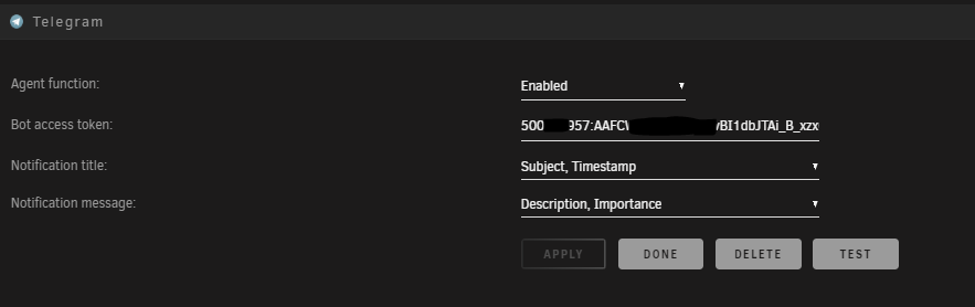

So, i tried to set up my telegram for notificartion, i created the bot and got the "token to access HTTP API.
Configured in Unrad notifications:
Disabled it, re-enabled it.
Test.
Nothing.
Any clue?
Thanks.
EDIT: some hour after it started working.
Edited by dhstsw

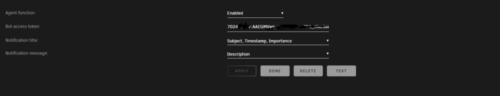

Hello,
Telegram Notification doesnt work:
I've copy the bot token & APPLY but with pressing TEST nothing happened....
Also i've try these (posted before), but no working more....
