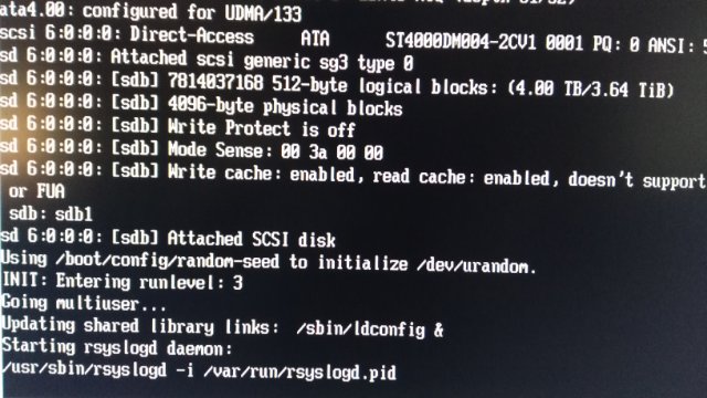

I don't have any directly helpful advice, although I can confirm your problem, AND I can tell you that it has nothing to do with plugins/add-ons.  I had the same issue when attempting to go from 6.3.5 to 6.5.3, and I was using a freshly formatted (licensed) flash drive.  Mine consistently stopped at the point shown below.  So don't rip your system/configuration apart in the mistaken belief it's your specific combination of plugins/dockers/add-ons.  It happens even with an empty flash drive.
I had a brief exchange with Eric at L/T and there was another user who had the same issue.  This user later reported he'd corrected his problem by relocating a Seagate Constellation drive to his motherboard SATA instead of his server's controller cards.  Eric was also concerned it might be my IPMI card.  Ultimately I abandoned the attempt to go further with my server hardware.  I don't have any Seagate Constellation drives, and my server is headless, so axing my IPMI is not an option.  At this point, I'm just hoping the problem will be fixed (intentionally or accidentally) in a future revision....otherwise I'm stalling at 6.3.5 for the time being.
