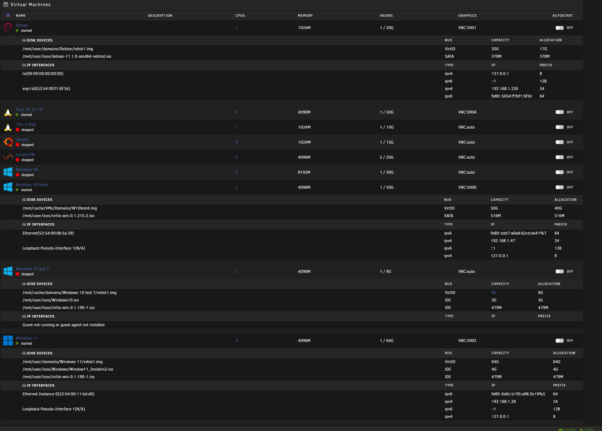

This has now been added and should be in RC5. Below is on an internal test release and loopbacks are not shown now.
Edited by SimonF

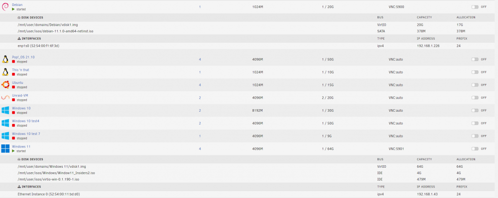

Since there's lots of room, is it possible for us to get this shown by default in a column?
