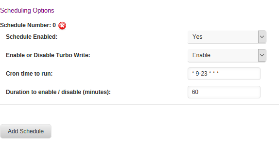

3. The reconstruct write option can lead to have all the time all disks spinning up, therefore into the CA Auto Turbo Write Mode plugin was added the option to define your own schedules for enabling/disabling the TurboMode.
I have added the following schedule:
then received the following errors into syslog:

My best guess, but I could not find this anywhere documented, is that we should use a fixed hour, minute, second time instead of interval. - Is this assumption correct ?

Runs Command every minute on hours ...
It overlaps.  The command to turn on turbo runs every minute, and you've also set it to last for 60 minutes.  There's 59 overlaps in every hour.
