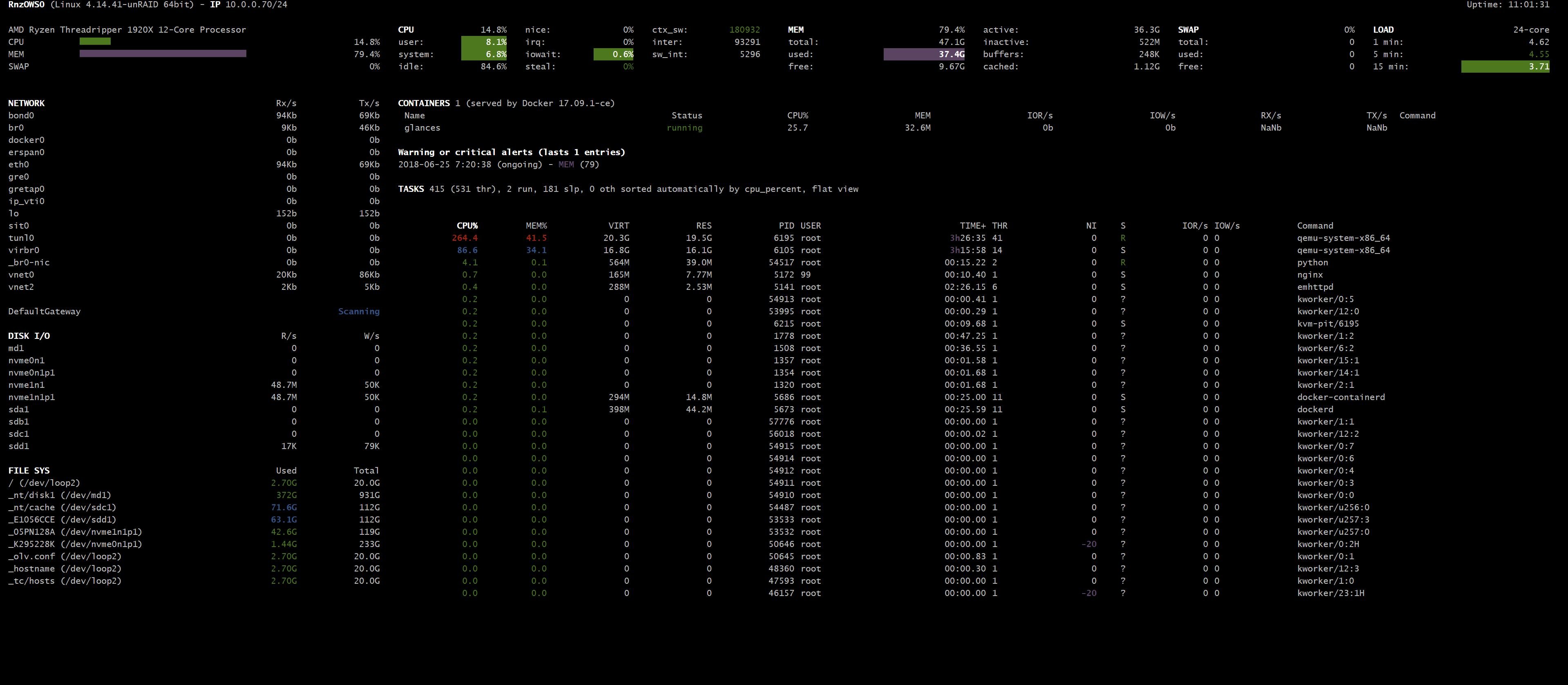

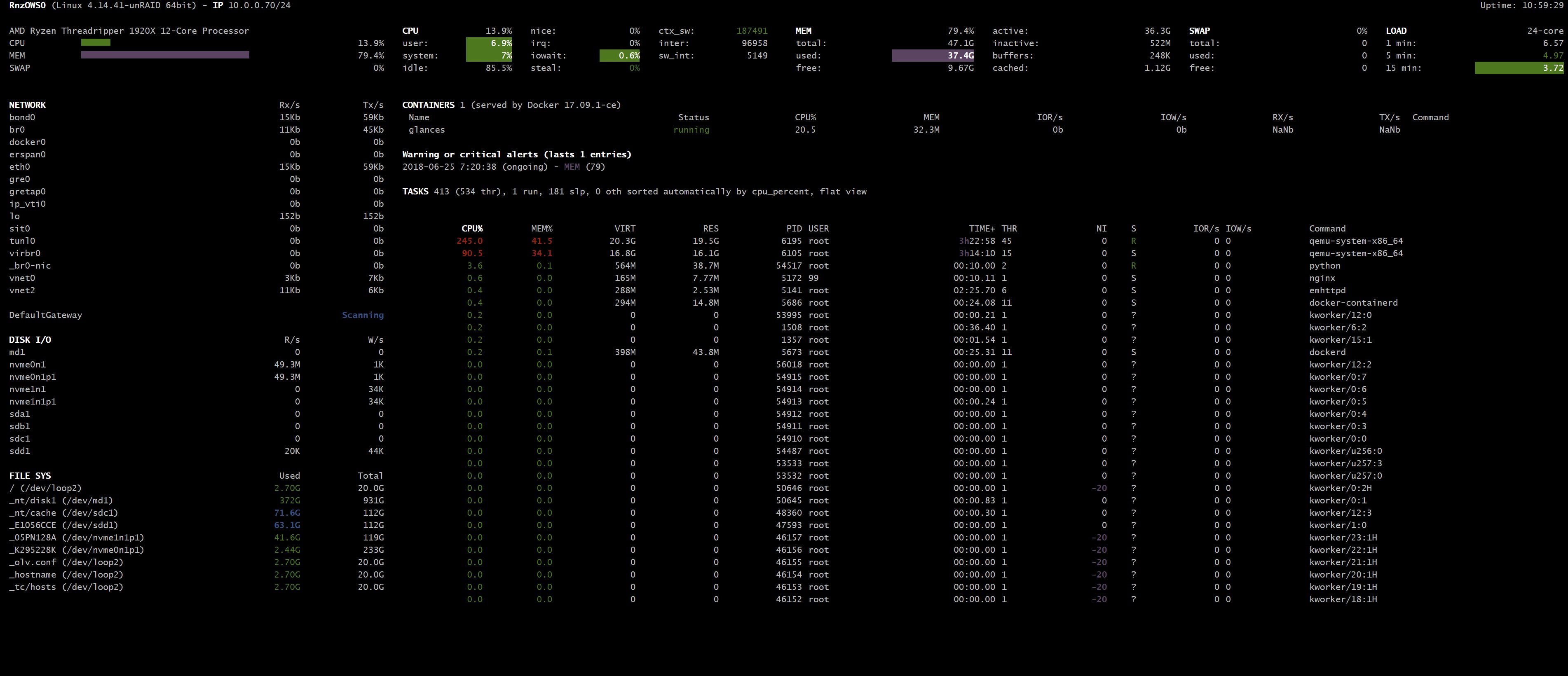

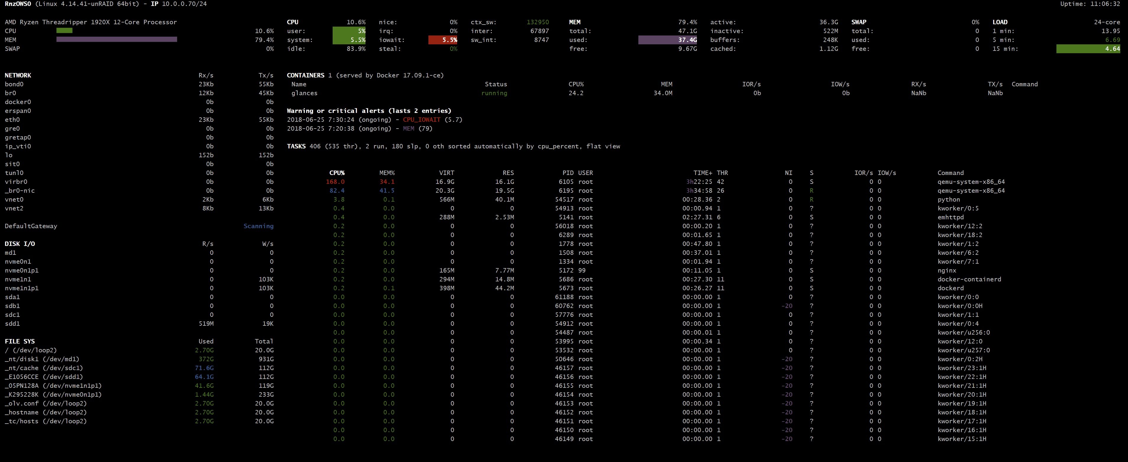

I've got this single frustrating problem: my VMs (not unraid, only the vms) stutter during file transfers and high disk usage in general, originating inside the VM (synology cloudstation syncing from the main NAS, manual file transfer, crystaldiskmark running, lightroom reading 100+ MB raw images, etc.).
I've got three workstations in my office that are managed by unraid, three W10 VMs with dedicated gpus (two small quadros and a 1070FTW), on a x399-1920X-48GB ECC machine.
When the disk usage spikes, one of the logic CPUs spikes to 100% usage, and all the system stutters for a few seconds (the mouse pointer freezes for a few seconds, etc.).
It happens for transfers on the C volume (1 dedicated ssd for VM, but not passed through), on the array network shares, on other shares mounted on unassigned ssds.
Using crystaldiskmark inside a VM on a share mounted on an m.2 unassigned device, a phisically different disk from C where the VM image is not saved, the problem is still there.
Today I tried isolating the cpus (already assigned in phisical core pairs to the vm from the beginning), and using emulatorpin, pointing it to the first phisical core for all VMs (the same two logical cores that i left for unraid). Nothing changed: the load on the first CPU significantly increased, obviously, sometimes reaching 100%, but meanwhile also the same VM core that was reaching 100% usage before, still does, and the stuttering is still there.
I've read that changing the machine to q35 from i440fx may solve this issue, but I'm scared that all the licenses I've activated on the VMs may be compromised.
I can easily replicate the issue 100% of the time, and I'm attaching the latest diagnostics.

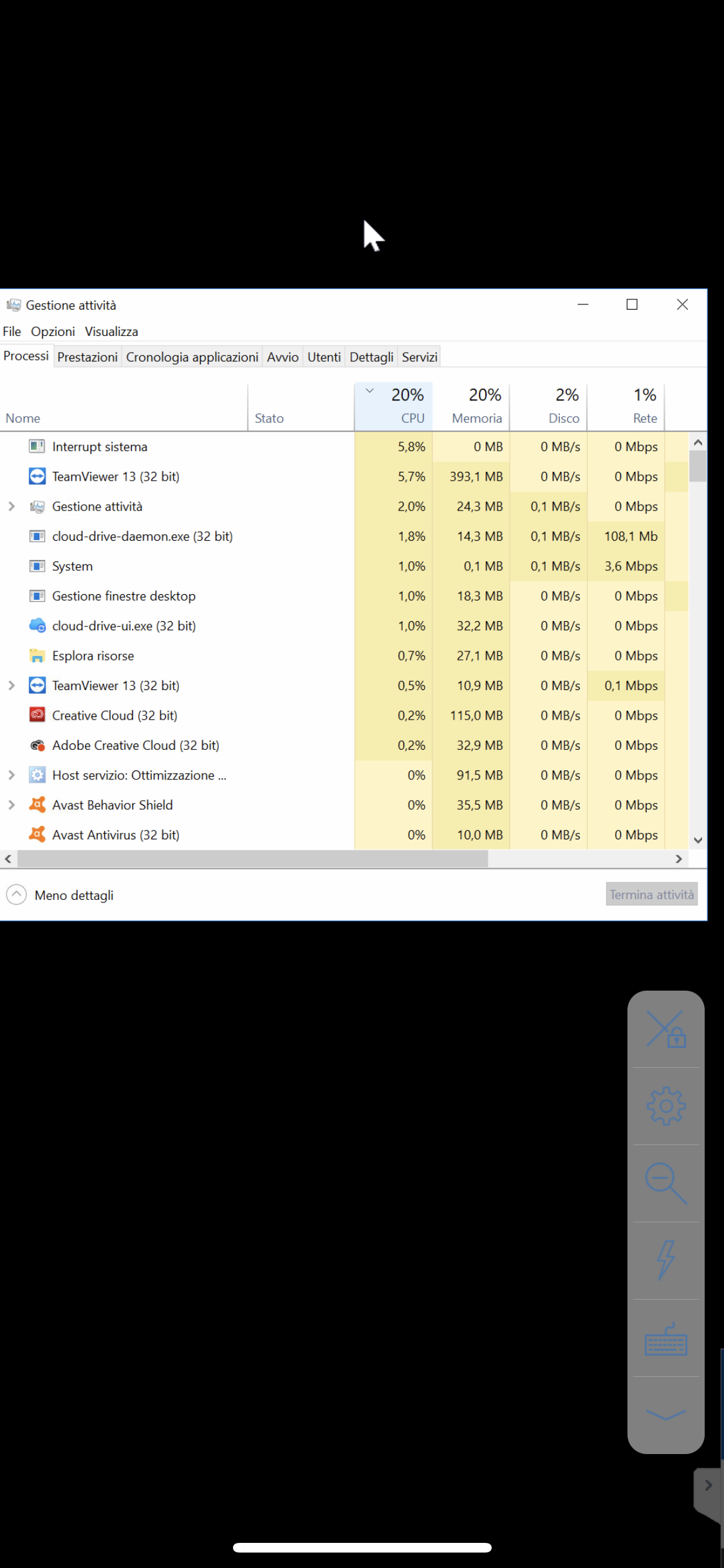

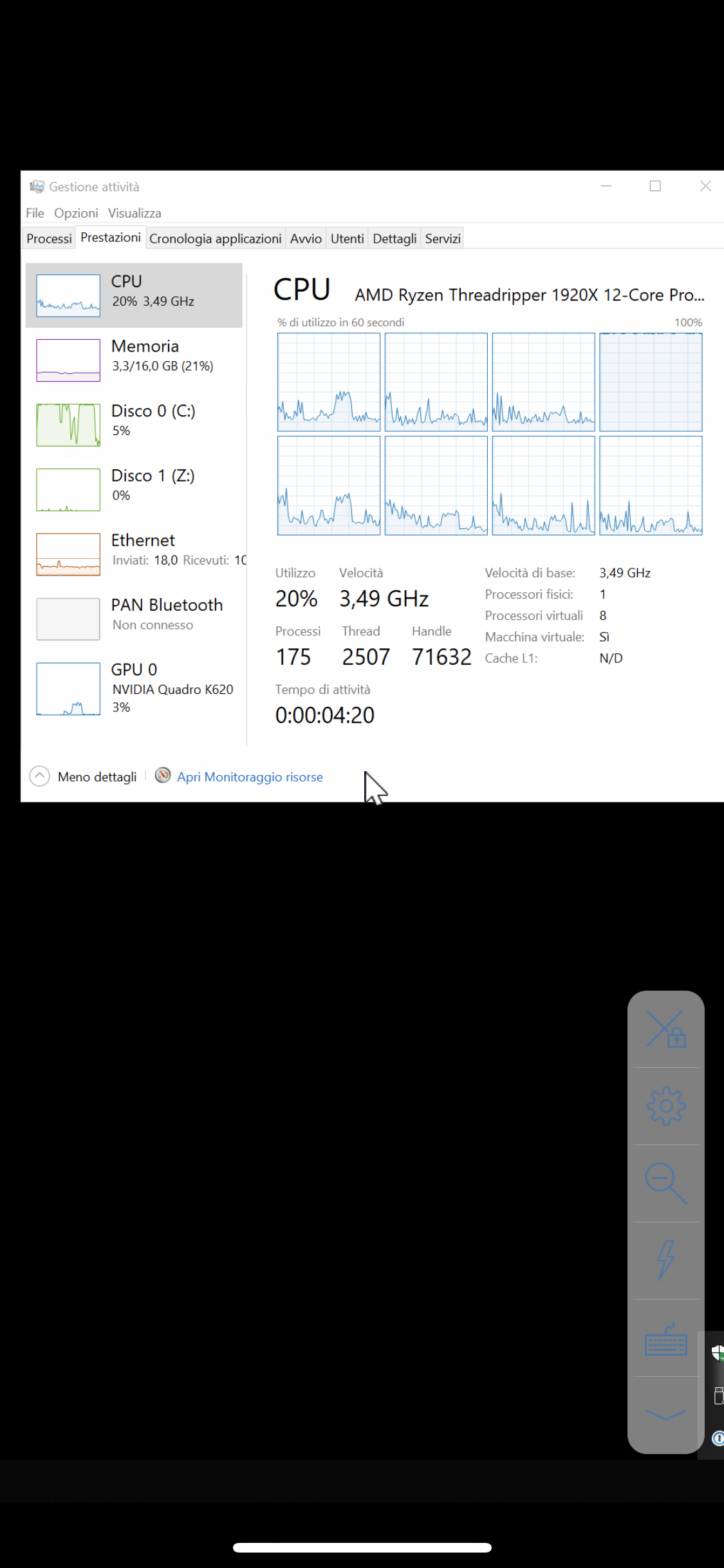

Attaching the vcpu situation inside the vm during a file transfer - sorry about the quality, screenshotted with TeamViewer on the phone.
I’m guessing that the stuttering is due to that high load on the cpu during file transfers: why is that and how can I avoid it, seen that it’s happening on all my VMs?
With a bare metal W10 installation on same machine I don’t see similar spikes in CPU usage during file transfers.

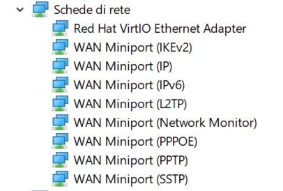

On 6/23/2018 at 2:29 AM, 1812 said:
this is odd behavior. are you using the virtio driver or the e1000 for network?
Checked, it should be the virtio one (see attachment).

This is probably the wrong direction, but to eliminate a virtio driver issue causing load, change the network to
<model type='e1000-82545em'/>
Did you also try reducing the ram usage on the server? Or alternatively, how does it act when only 1 vm is running? Have you tried (as suggested) to use only 1 isolated emulator pin per vm?
I’ll try thanks!
Ok I now tried both
Changed the adapter model type
Pinned a cpu for emulator pin that is both isolated from unraid and not assigned to any VM. Test conducted @ 79% total ram usage in unraid.
The situation seems a little bit better during sequential read (maybe placebo), but it still stutters heavily during other activities.
The cpu that boosts to 100% is always cpu0 or cpu3 inside task manager, even if I change the physical cpu pinnings.

If only I could isolate what is causing that cpu load, I think we’ll be getting really close
Unfortunately as you can see above, the task manager is not helping me.
It seems like the process that is causing that load isn’t “inside” windows (and I guess this is why windows stutters) but the load is still detected by the task manager.

11 hours ago, 1812 said:
you can install the glances plugin which is like a version of top, it will show you what on the server is pulling high cpu load. another general one is netdata. it looks nicer but in some ways is less nitty-gritty details.
I'm attaching three screenshots made during a crystaldiskmark run on VM1 and VM2, the first one on VM1 with single, isolated emulatorpin, targeting the scratch ssd,  second one same VM and conditions but targeting C, third one on VM2 with two not isolated emulator pins and targeting C
All of them caused stuttering, but the tests conducted on C always bring more of it.
Edited by Kronos69

Guys, @1812, I'm really, really stuck with this.
I also tried the two combinations of io (native and threads), without noticing differencies.
The things that seem to somehow mitigate the issue are pinning the emulator to an isolated cpu, and having hyper-v enabled (did that on a new vm, because i'm not able to enable it for old vms), but maybe it's placebo.
Cache none also seems to help, but it really impacts performance (I've got a huge UPS so power losses don't scare me that much).
I still suffer of bad stuttering and 100% cpu load during disk i/o, especially with random i/o.
The problem doesn't seem to reside inside the guests, but inside the unraid host (maybe some misconfiguration made by me).
What other steps can I do to help you/anyone to isolate what may be causing this issue on every vm I create?
May it be that my cache is btrfs, and that all my vdisks were created first in a btrfs filesystem and later transferred onto an xfs formatted drive? I'm really running out of ideas.
I'd really like to use unraid to manage more WSs inside my office, but I've got to get rid of this problem first. :(
Attaching again the updated diagnostics
rnzows0-diagnostics-20180628-0007.zip
Edited by Kronos69
