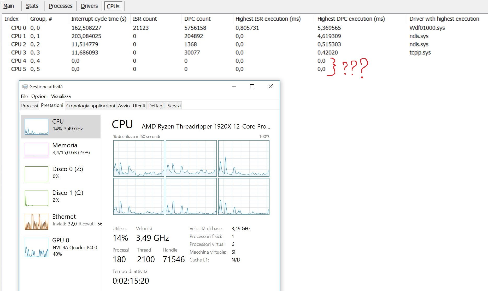

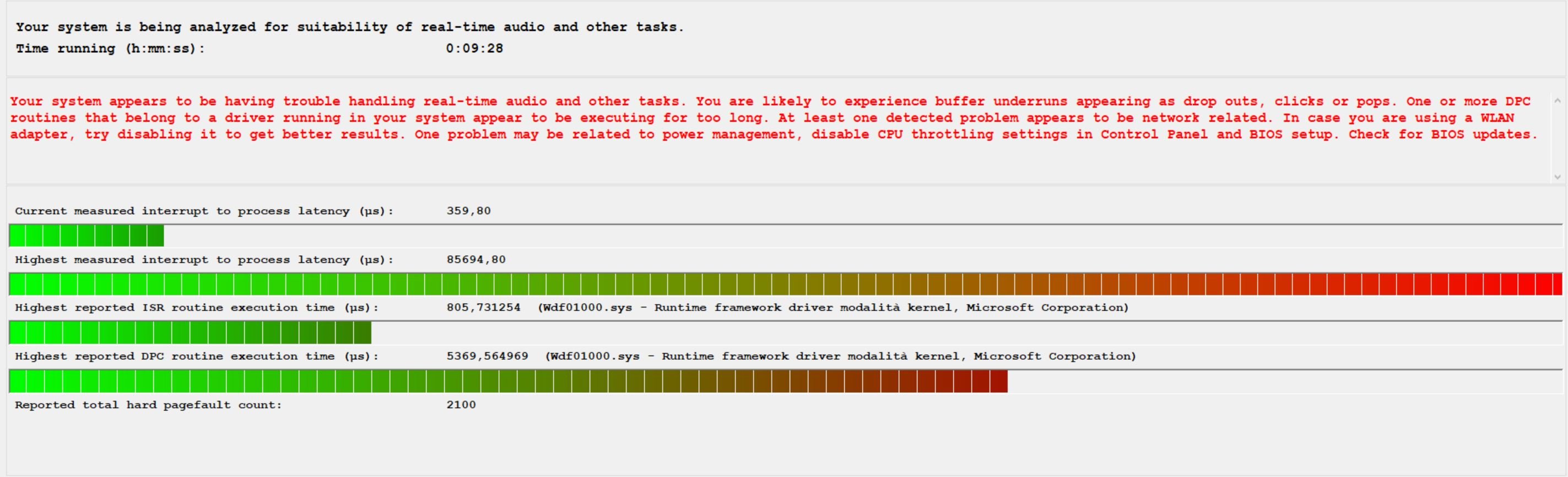

In the meantime, it seems an issue for other people as well - same symptoms - changing an existing vm to q35 didn’t help me, but maybe installing from 0 with q35 will, I’ll try that, too.
@1812 thanks to ssds it was quick to set it up - unfortunately the cpu spikes and the stuttering do seem to be there with the intel platform, too.
1 vcpu for unraid, one for the emulator pin, two for the vm (the 7700 isn’t generous with cores). 8GB ram to the VM, with a total 16GB ram.
Vdisk mounted via scsi, discard=unmap, cache=none or writeback, io=native or thread
I’ll do other tests tomorrow morning to be 100% sure, but I think it’s not an amd related issue. With intensive random I/O on ssds with crystaldiskmark, it seems to always happen. The cpu spike starts and stops with the disk access, and it doesn’t happen on the bare metal windows install on the same machine.

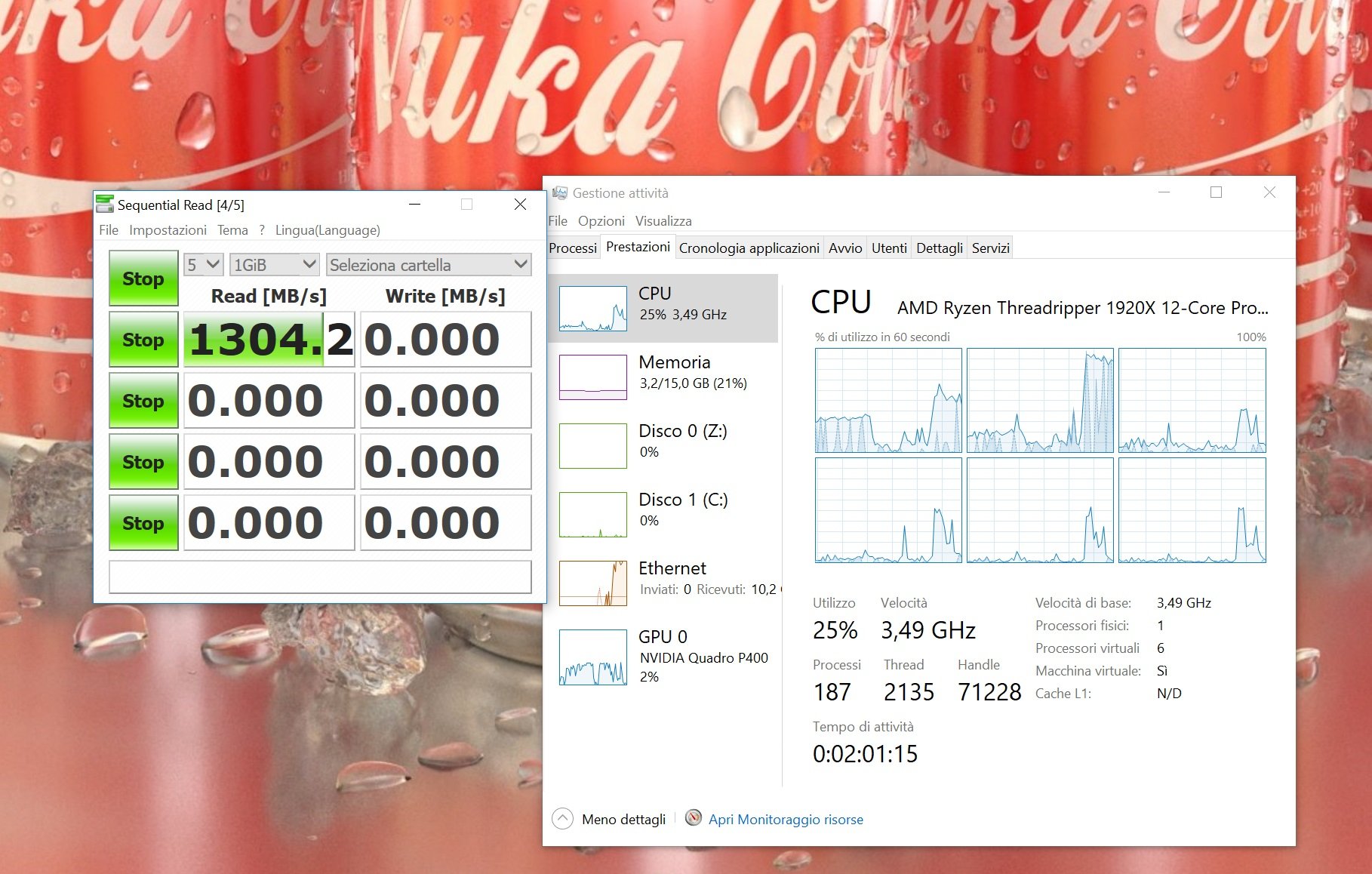

Any visible spikes of cpu activity during those transfers?

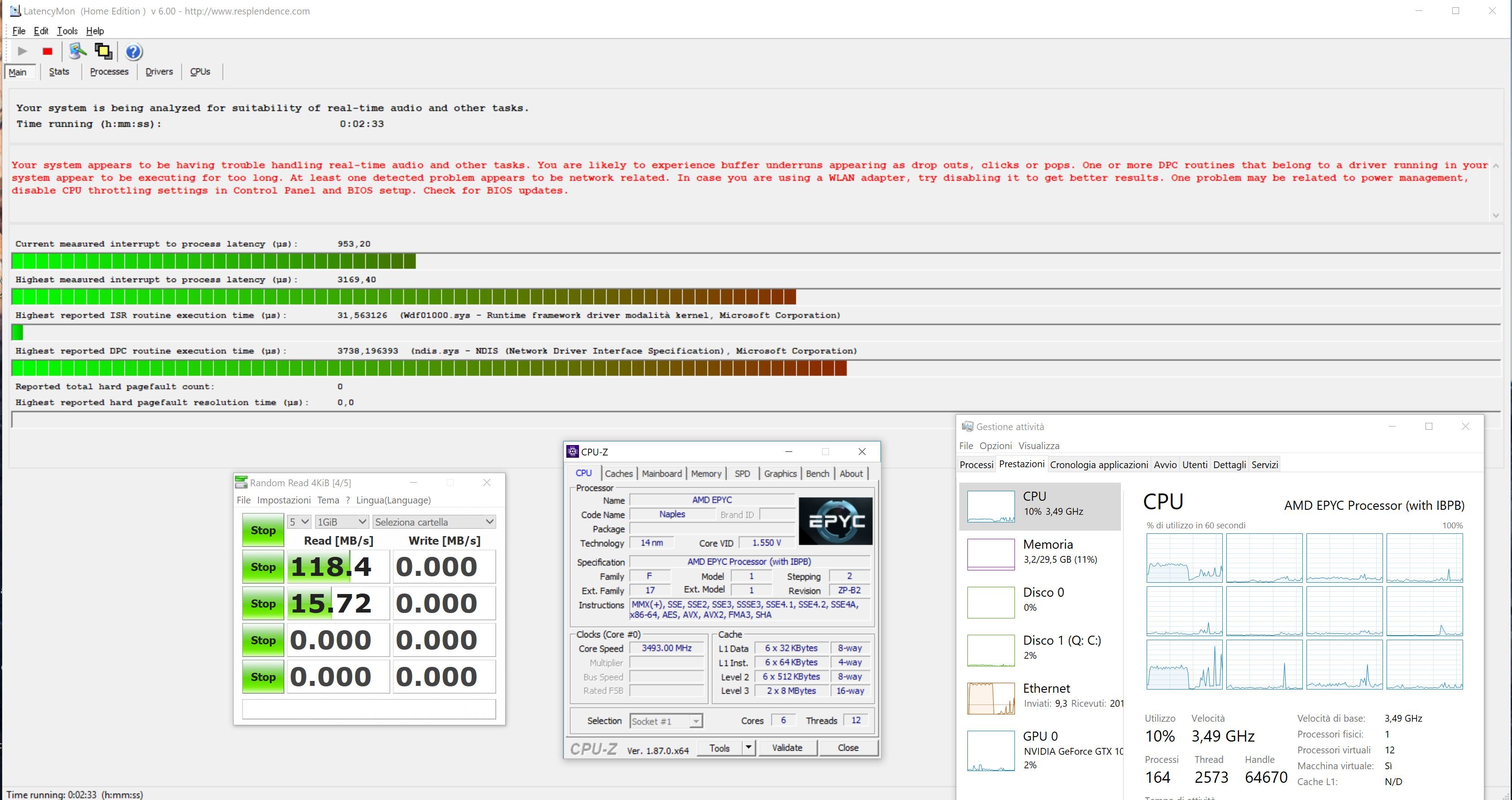

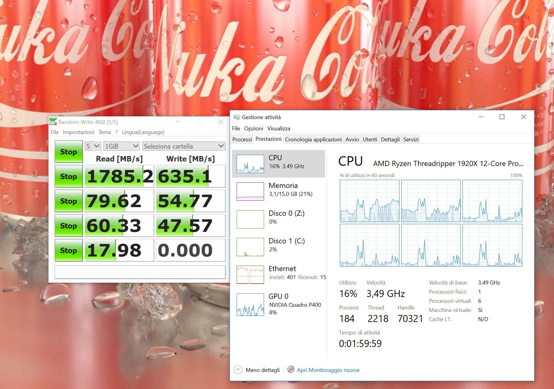

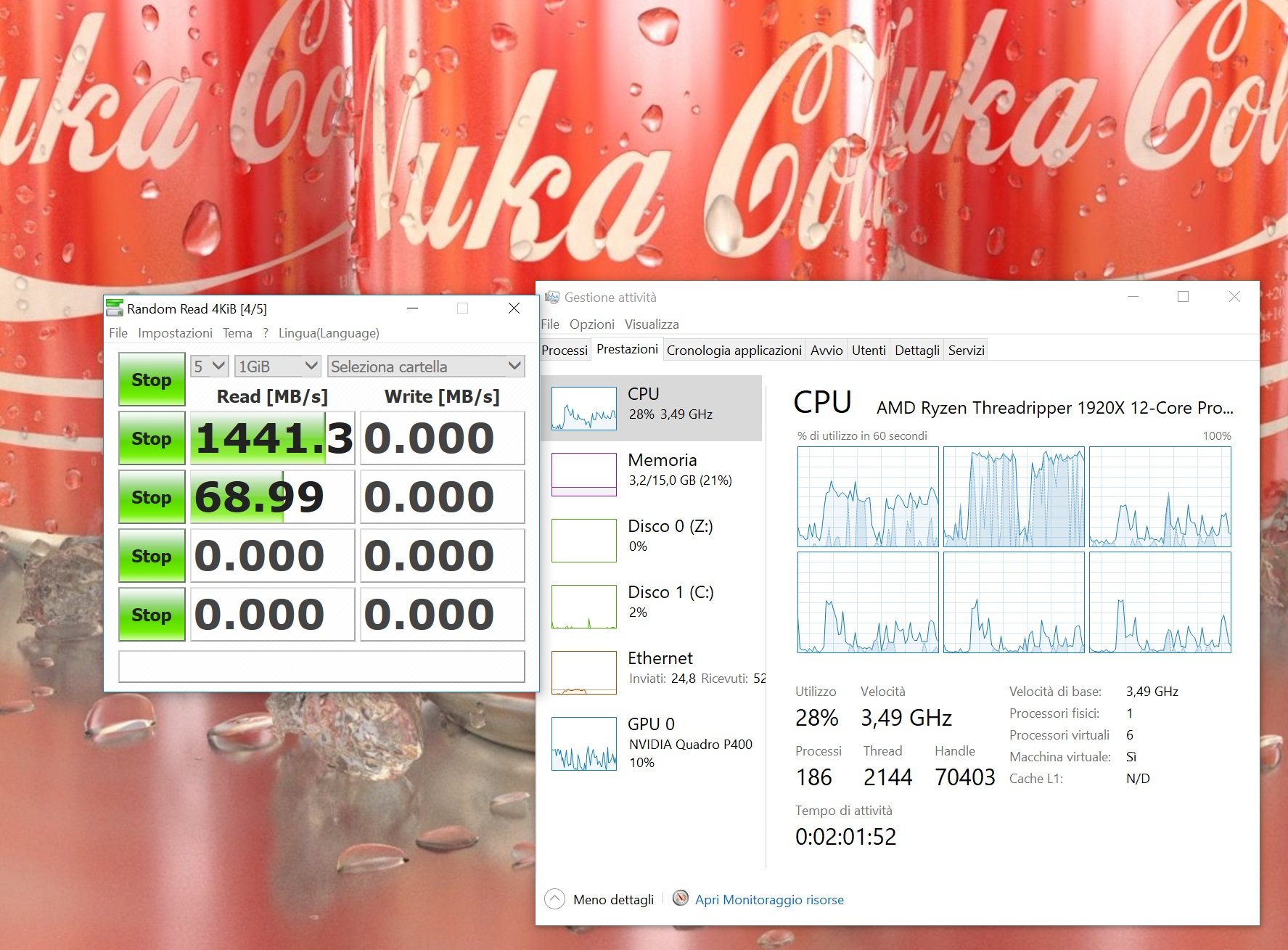

May I ask you for your VM XML and unraid syslinux?

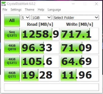

May I ask you to run one test with crystaldiskmark and see if you notice stuttering of the pointer during the random read test (the second one after launching "all" tests)?
Edited by Kronos69
Another thing that I could try: following one of gridrunner's tutorials for ryzen systems, I have got rcu_nocbs=0-23 inside my syslinux as an added measure to avoid system hangs, but I'm not fully aware of what that command does. I'll try to disable that and see if it changes something.
No spikes during file transfers. CPU usage graph in resource monitor just bounces around 34 to 44 percent. I tried to run Crystaldiskmark the other day and it could not detect a hard drive. Probably because I use a vdisk instead of passing through an SSD like you are doing. If you have something else you'd like me to try, let me know and I'll give it a shot.

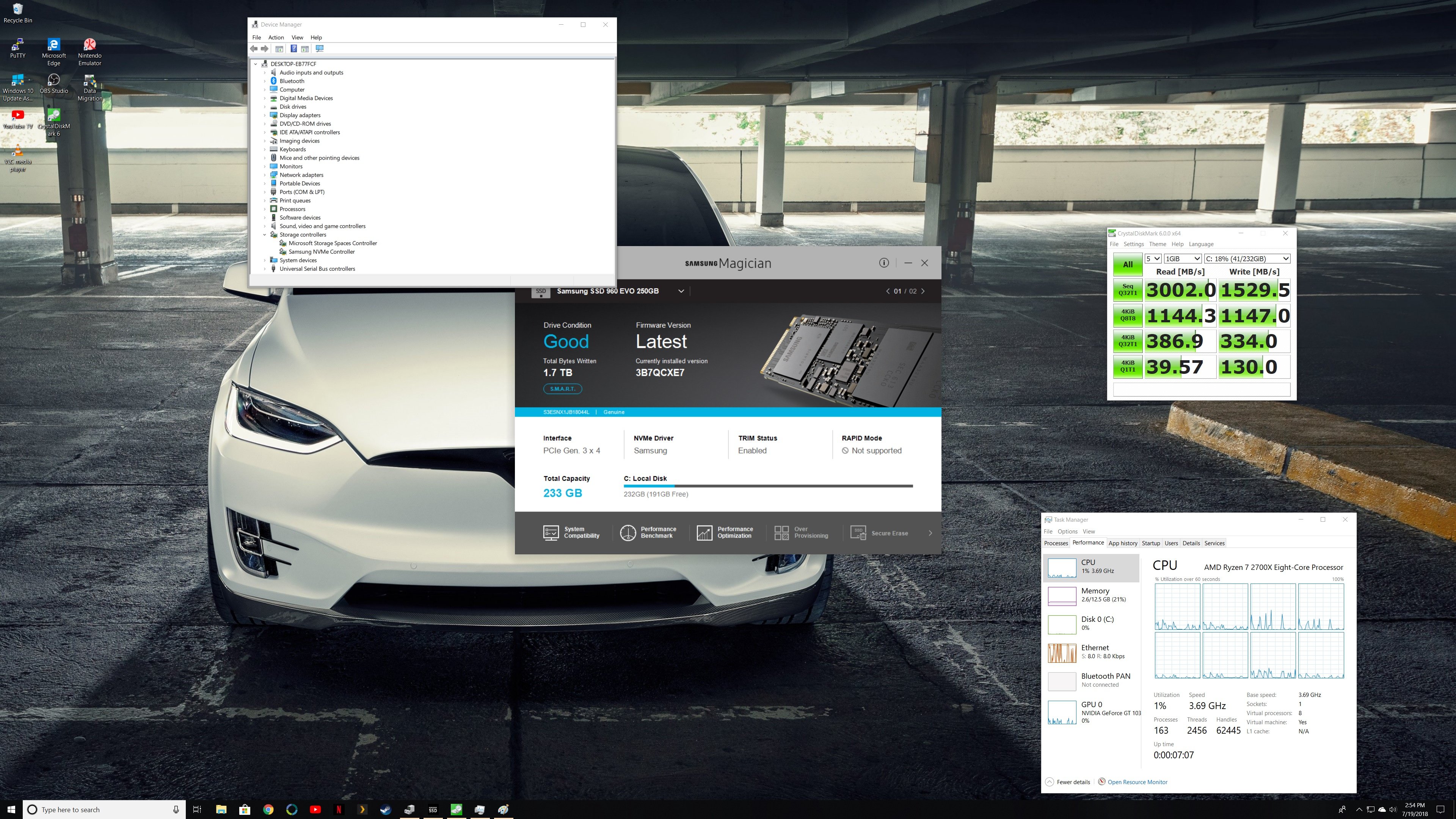

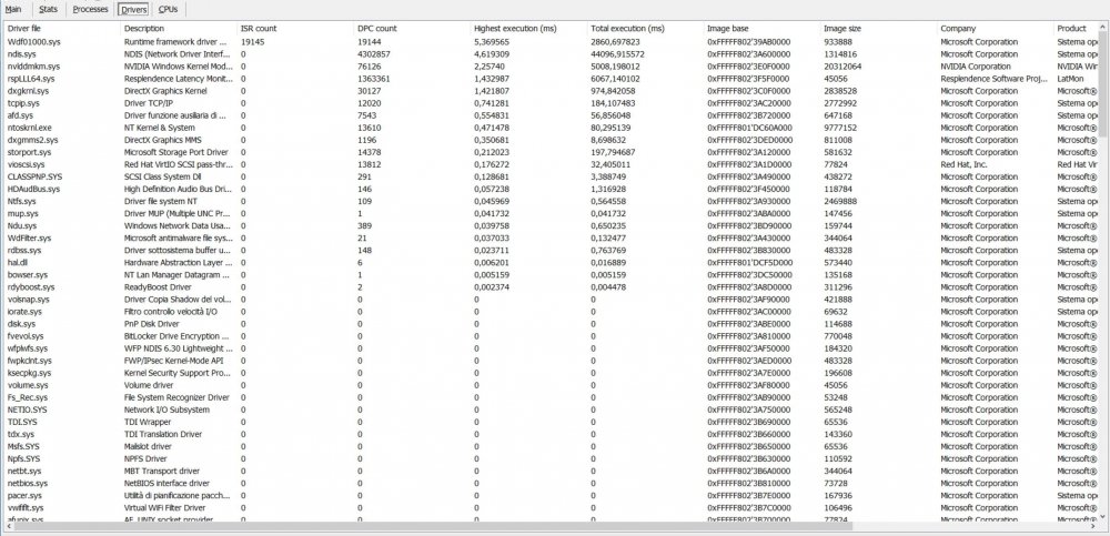

Ok i found i had this issue with my vm as well, all sorts of cpus would ramp up with doing a disk speedtest. Im using a r7 2700x on the gigabyte gaming 5 board and everything else works perfect. I picked up one of those samsung nvme drives on sale at best buy to test and with the drive passed through to the vm and cloned the vm to it....i no longer have the issue. I passed the entire controller through as well, no block device passthough. I see no cpus going crazy or anything.
beware 4k screenshot
Edited by david279
details
I finally had the time to try this, and a few blue screens of despair later, it WORKS! Even without applying any previous optimization I tried before in this topic, the overhead that was causing stuttering is gone. Thanks!

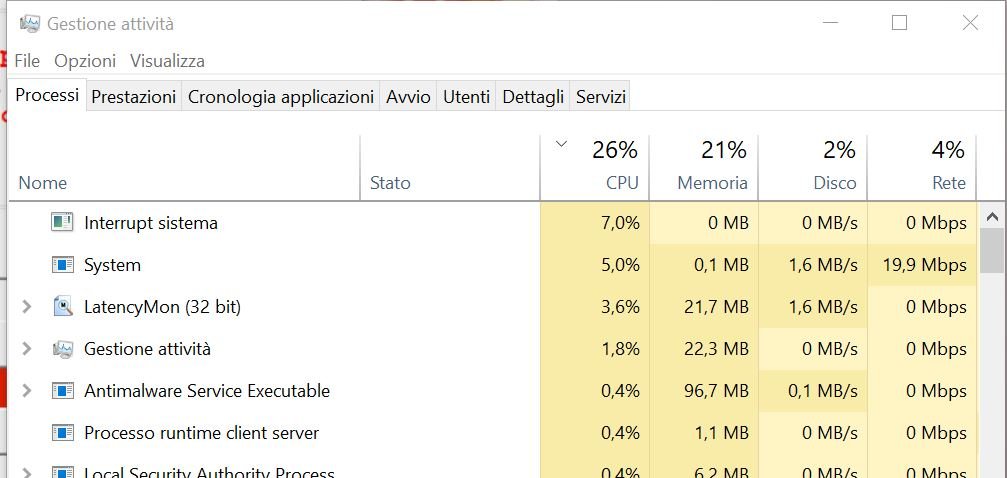

High single thread cpu usage is seen for all intensive network usage, and again it's not the emulator pin, but one of the VM cores.
I'll open another topic about this problem, but I feel that the bug is somehow related.

To easily trigger the stuttering/hangs, I just need to perform a sequential read test with crystaldiskmark on ANY network folder, even folders that aren’t unraid related (for example, a smb share on the central nas)
Bypassing emulation passing through the ssd controller solved the issue with the ssds, but the problem still remains because I cannot pass through the Ethernet adapter having to share it with 3+ vms and unraid.
Because of this, anytime I move files between the VM and the network, I still experience heavy stuttering

Update, hoping to be helpful to other ryzen/threadripper users.
Now I’m pretty sure that the problem with network file transfers and the hiccups is due to system interrupts.
The single core almost 100% utilization spikes are correlated to a spike in “system interrupts” resources usage inside the windows resource manager (it’s less than a 10% usage, but with 10 cores, it’s enough to saturate one core).
After upgrading to 6.6.1 and creating again a new VM from scratch using q35 quemu 3.0 as the machine, enabling hyper-v and using the msi interrupts tool that I downloaded from one of gridrunner’s videos, to select msi interrupts for the video card, the sound card (!) and the vfio eth adapter, the problem SEEMS to be vanished
On a W10 VM
With only two cores pinned
Even without an emulator core pinned
Even using a standard vdisk image on the cache drive, and not passing through anything beyond the gpu
I’ll test it further, no news = good news.
I’m now trying to convert at least one of the old VMs to see if I can manage to not reainstall every VM from scratch.
I managed to change the machine type to q35 without deactivating windows - I created a new vm in the GUI with q35, assigned the passthrough nvme where the VM was installed, and copied the old uuid inside the new xml (but left the new uuid in the file address just below that).
Windows automatically updated the missing drivers after a while, and after a few reboots it’s now working.
But the stuttering isn’t gone.
So I guess that the culprit is the hyper-v that needs to be activated (I had it turned off because older Unraid versions had problem with hyper-v enabled and non-quadro GPUs passthrough).
I’m not able to enable hyper v without running across an endless boot loop of blue screens of defeat, does anyone know how to do that, or I have to reinstall all VMs from scratch?
Edited by Kronos69
  • Kronos69 changed the title to Freeze/Stuttering - Threadripper 1920x - Windows 10 VM

  • When moving/accessing files inside a W10 VM on this threadripper 1920x build, a strong stuttering occurs. It's bursts of continuous micro/macro freezes, ranging from a fraction of a second to 4-5 seconds, and it's really noticeable because even the pointer gets stuck.
  • Having a storage device passthrough by id via scsi helps a lot, and an nvme controller "bare metal" passthrough almost solves the problem regarding local files (latency is still high but no perceivable stuttering). I still can't for the life of me solve the issue with network (LAN via ethernet AND local Unraid shares mounted via SMB) file transfers.
  • The issue is apparently NOT related to writes, only to reads. Random reads give usually more issues than sequential reads.
  • It's apparently NOT an environmental issue (broadcast storms, or something like that) because I can replicate the issue with the ethernet cable disconnected, simply running crystaldiskmark ponting to an unraid SMB share on the array.
  • Reading from a SMB share with crystaldiskmark, one logical core almost always hovers around 50%, and anoter logical core hovers around 90% (see attached screenshots) with a peak activity of "system interrupts" inside the task manager. Otherwise, they idle normally.
  • The faster the share, the worse the stuttering, apparently.
  • Q 35 3.0 seems to help.

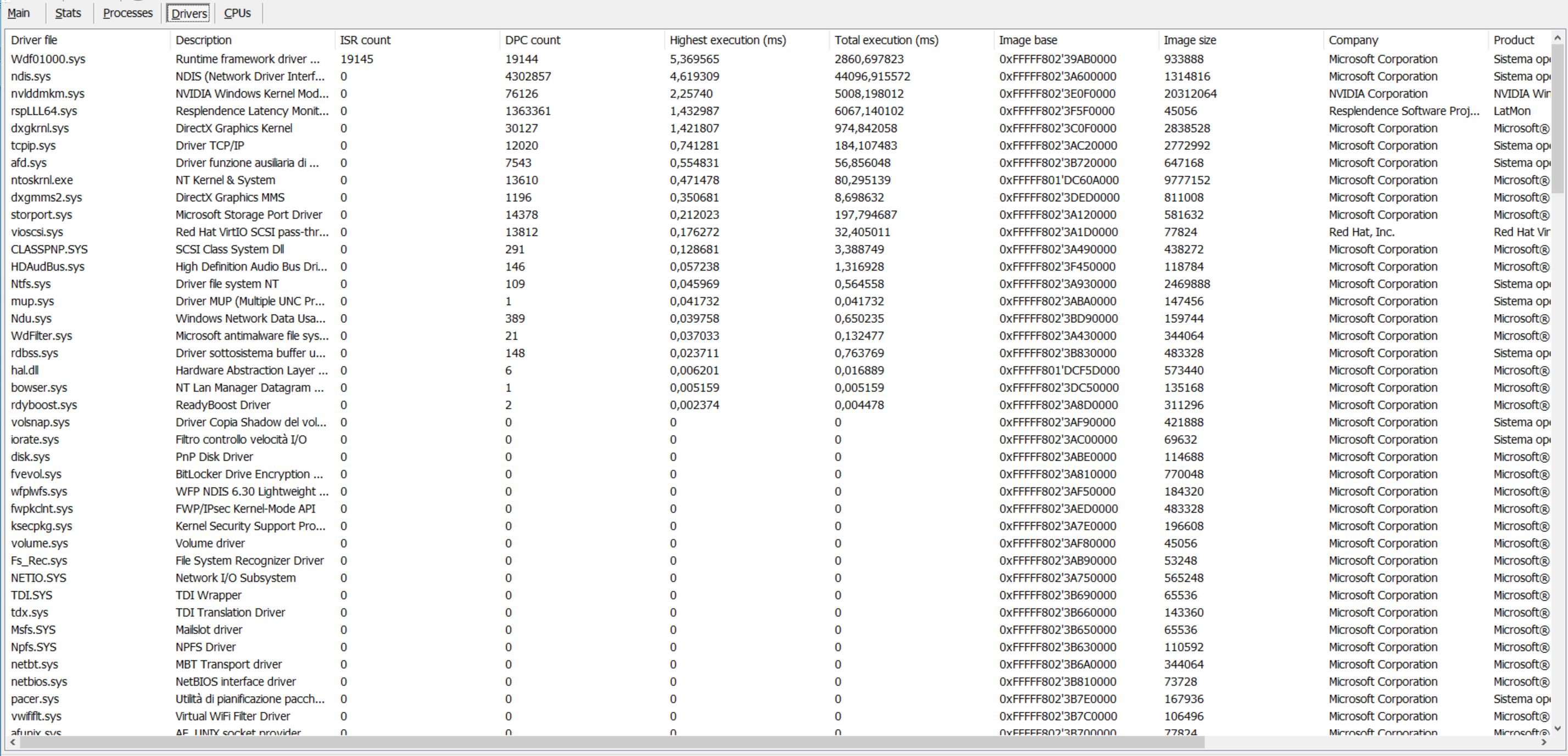

I've seen in a recent video tutorial that @SpaceInvaderOne has experimented with both 1950X and 2990WX, are you experiencing something like that, or have you an idea on how to circumvent this? To replicate the issue 100% of the time, with the above setup, is sufficient to launch crystaldiskmark on an unraid SMB share from a W10 VM.

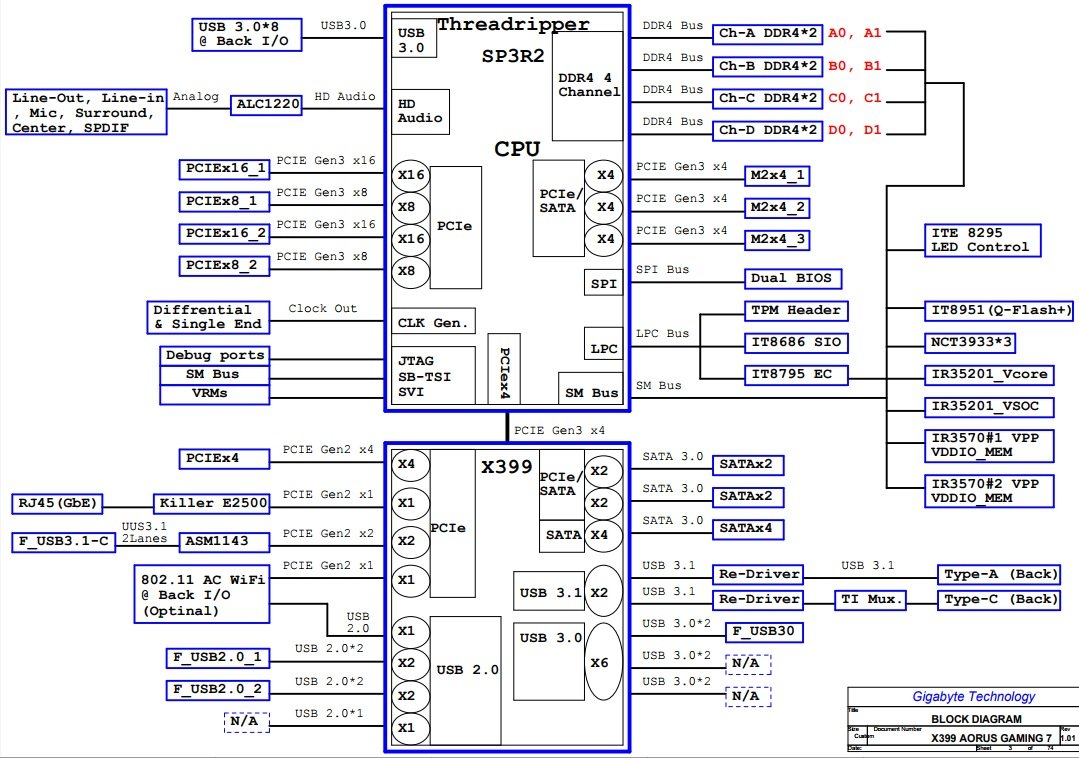

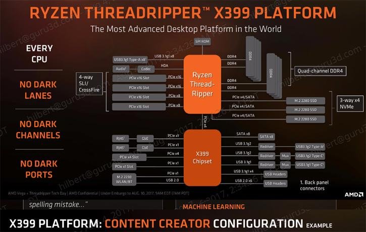

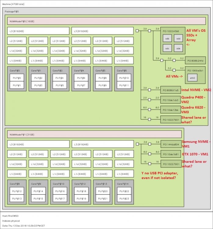

P.s.: in the green/red scheme below (made by Gigabyte support) that i found somwhere some time ago (maybe here, maybe on the gigabyte forum), DIE 0 and 1 denominations are inverted compared to lstopo
rnzows0-diagnostics-20181214-0553.zip

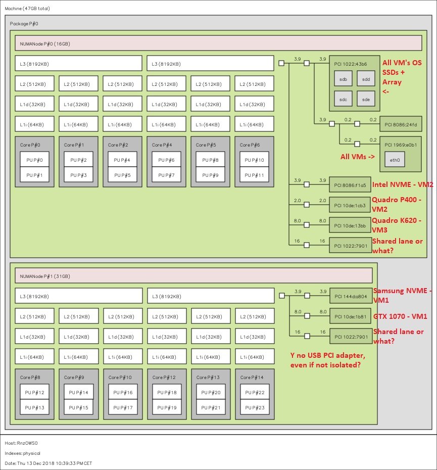

X399 Topology by AMD infographics.jpg1325001581_Latencymoncpus.thumb.JPG.739613499e96be02ca8ce9db66346bcf.JPG
Edited by Kronos69

Seen the topology the core/multithreaded pairing should be 0 and 1, 2 and 3, etc, and it’s correctly picked up by recent unraid versions.

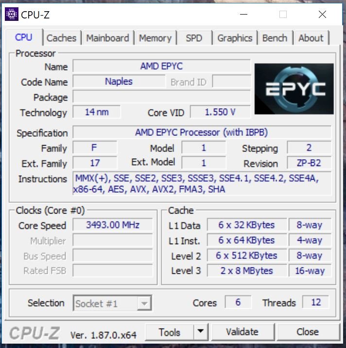

Ok. The CPU thing is because the cache on the processor isn't passed properly By doing the CPU thing it will properly pass the cache and makes the system much more responsive. Memory latency drops drastically as does l1-l3 cache latencies. If you'd like to see what it does see the below two post by me.
Tested on VM1: It does not competely solve the stuttering, but it works wonders, perceivably reducing the latency. Thanks!
Let's hope it'll be included in the next code.
I used this variation:
<cpu mode='custom' match='exact' check='partial'> <model fallback='allow'>EPYC-IBPB</model> <topology sockets='1' cores='6' threads='2'/> <feature policy='require' name='topoext'/> </cpu>
because I have 12 cores assigned.
To find the root cause, I would ask you if you wish to test your system for this very specific problem, running crystaldiskmark on a network share capable of saturating a gigabit connection or pointing towards an unraid SMB network share. Do you notice any of the above problems (increased latency, cpu spikes, stuttering)?
P.s.: I've still not changed the cpu mode on the other VMs, I'll update as soon as I have news.

I had a lot better luck removing the isolation on CPUs and changing my RAM settings back to auto in the bios.  I have 4 VMs that are gaming machines, and a virtual game server and am not running into any stuttering while playing or doing smb activity while playing.  Given, I have an asrock x399 instead of an MSI, but seems similar enough.  I also have 64Gb of RAM so maybe that is helping with bandwidth- but when I isolated cores in addition to pinning them, I got similar results.  It was only after throwing out the idea of pinning and isolating RAM that I was getting good results.  I did do the EYPC change also- and the MSI fix, but that was all.
I'll try later tonight but I can tell you already that I saturate my network all the time. I download via jdownloader at near gigabit speeds. Once all the files land it begins to unrar it. I've seen the cache SSD hit over 200 megabytes a second doing that. I have my whole drive passed and the machine completely lives on it. The cache holds the virt image and Dockers. I used to have a problem when any part was using that cache drive but since I passed my entire drive that part is all gone. I run a factorio server to on another vm and had to pass a USB drive through to it so it wouldn't lag on saves when I was doing jdownloader.
@Kronos69 - Picture was taken while playing factorio with a massive base and watching plex with transcoding happening on the same server but other cores. That is to my SMB share that most of my data is on.
Edited by Jerky_san
