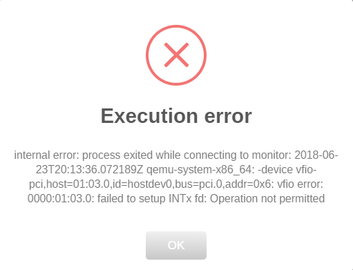

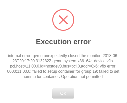

So I'm using the exact same config that you pasted here, it does show that override is on, but it doesn't split them. Problem when running VM's is, when trying to IGPU (INTx fd)  i get an error, and another error with GPU(failed to set iommu).
The groups for gpu still aren't split. Any suggestions?

post diagnostics after vm launch failure (tools>diagnostics) the INT x fd is a new one for me. Are you trying to use the (weak) onboard vga port? As far as the second iommu issue, depending on what bios version/year you are using, it may be the rmrr issue.
I'll just upload the zip file, so going back to the INT x, yeah I was trying to use the onboard VGA port.

so the good news is that this is your problem:
un 24 02:26:04 unRem kernel: pci 0000:11:00.1: Device is ineligible for IOMMU domain attach due to platform RMRR requirement.  Contact your platform vendor.
It is currently in a group (19) with 11:00.0 , which is the GT218. This is also part of your problem. UnRaid doesn't like to play nice with older cards. Something to do with initiation, onboard bios or something. I don't recall. But At a minimum I'd use a gt 710. I've made those work with the rmrr workaround outlined in the proliant thread.
This older card may be part of the problem why the gpu won't split into 2 groups with each having either video or audio. you can, as a last attempt, try changing the syslinux.cfg to
pcie_acs_override=downstream,multifuncion
This sort of brute forces all devices into different groups where possible. If it doesn't split the card into 2 groups, then you can either try a different slot, or you will need to try a different card.
As fars as the integrated gpu... I wouldn't even bother.
