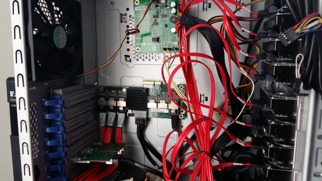

June 29, 20188 yr Author Decided to go with 9211-8i sas expander https://www.newegg.com/Product/Product.aspx?Item=9SIAA0T6N15523&ignorebbr=1&nm_mc=KNC-GoogleMKP-PC&cm_mmc=KNC-GoogleMKP-PC-_-pla-_-Hard+Drive+Controllers+%2F+RAID+Cards-_-9SIAA0T6N15523&gclid=CjwKCAjwsdfZBRAkEiwAh2z65m-dqd4E_ARCog6A_pRgFbNpdy3-VQbBOq7OZ9kvMWxRKIe9wbhqVxoCAmgQAvD_BwE&gclsrc=aw.ds would this give me 24 connections ? Edited June 29, 20188 yr by CSIG1001
June 29, 20188 yr Community Expert 20 minutes ago, CSIG1001 said: would this give me 24 connections ? Yes, using a single link to the HBA you'll have 20 on the expander + 4 on the HBA's other port.
June 29, 20188 yr Author Just now, johnnie.black said: Yes, using a single link to the HBA you'll have 20 on the expander + 4 on the HBA's other port. THanks for the quick response Can you do me a favor and look on page 19 of the intel sas expander card manual. I am trying to figure out if i can use the SFF8087 to SATA breakout cables to use on the Norco 4224 backplane , backplane has 24 sata ports.. I am interpreting the manual page 19 saying these cables cannot be used with the expander.. Also since i have 20 ports now on the expander can i use the free SAS port on the raid card to give me 4 more sata ports using the Breakout cables? https://www.intel.com/content/dam/support/us/en/documents/motherboards/server/sb/e93121003_res2sv240_hwug.pdf THANKS!
June 29, 20188 yr Community Expert 5 minutes ago, CSIG1001 said: I am trying to figure out if i can use the SFF8087 to SATA breakout cables to use on the Norco 4224 backplane , backplane has 24 sata ports. You can 5 minutes ago, CSIG1001 said: Also since i have 20 ports now on the expander can i use the free SAS port on the raid card to give me 4 more sata ports using the Breakout cables? 10 minutes ago, johnnie.black said: you'll have 20 on the expander + 4 on the HBA's other port.
June 29, 20188 yr Author Ok great thanks jonnie, i guess i misunderstood the manual on page 19 , So just to be clear i can use the SFF 8087 break out cables on the SAS expander card going from SAS to 4 sata cable ?
June 29, 20188 yr Community Expert 15 minutes ago, CSIG1001 said: So just to be clear i can use the SFF 8087 break out cables on the SAS expander card going from SAS to 4 sata cable ?
