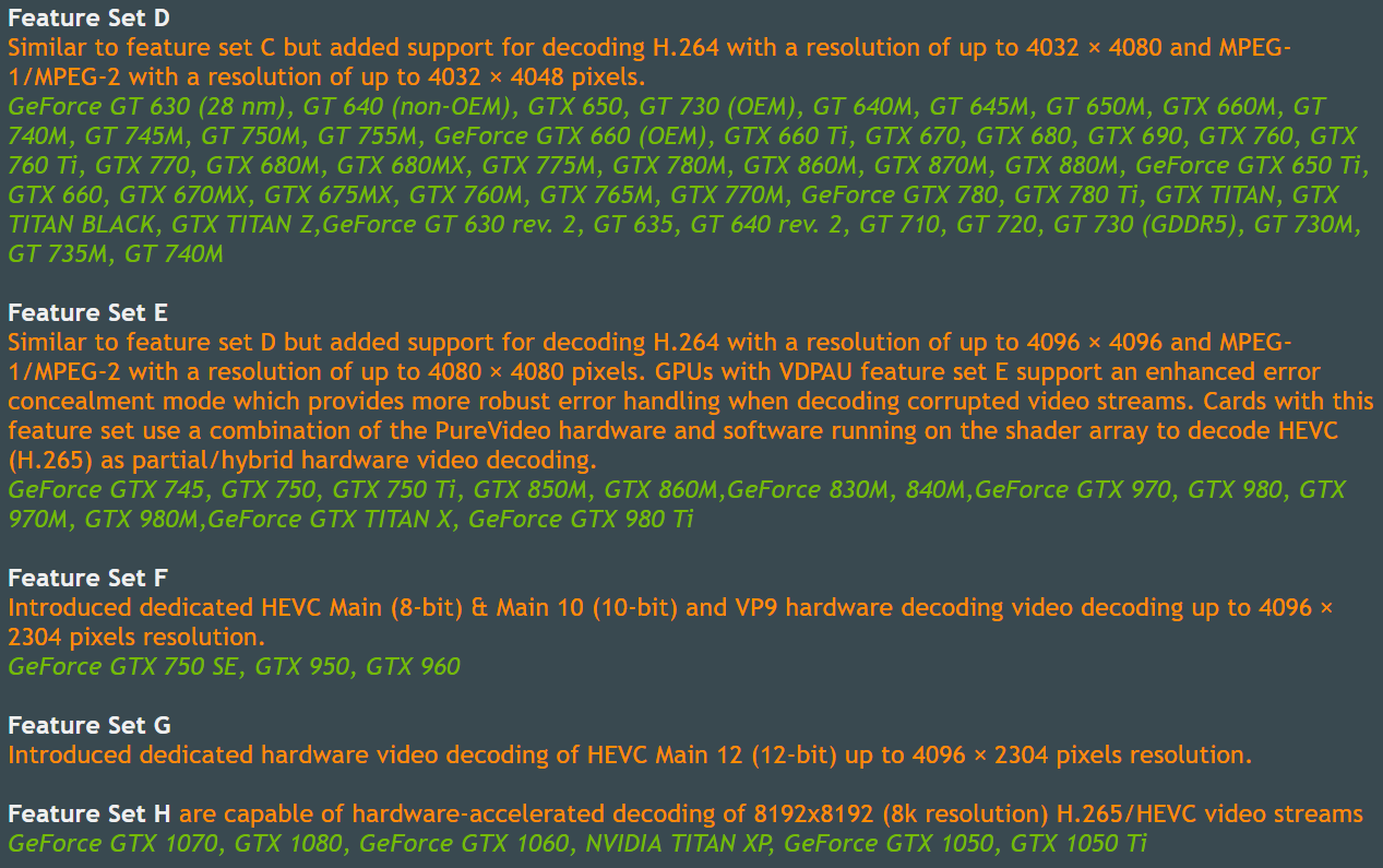

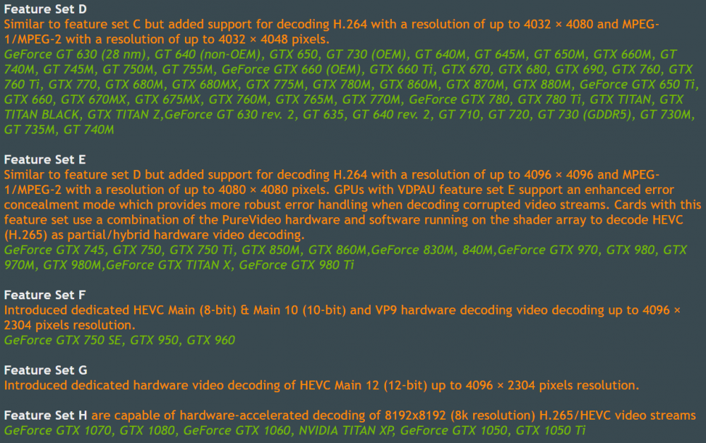

Looks like your GT 710 might be the issue. See the image below. The 710 supports feature level D, which does not include H.265 (aka, x265) streams. Only H.264 (aka x264). Most 4k video is encoded in H.265. If Plex has to transcode x.265 to x.264 for your machine to play it back - it will be very choppy unless you have a very powerful CPU. If you aren't using Plex, and trying to playback an x.265 file directly, your software might be trying to decode. And it would be very impacted, esp. on fast moving video. A fixed pane with solid color background and maybe one person talking might play ok. But if the camera is panning over a city scape or landscape, it will be very laggy.
I think you need to get to Feature Set F to get 8 bit and 10bit HEVC H.265 support which is what you need for most 4K video.
My 1050 Ti is at feature level H, which seems to support 8K video. But who knows what wrinkles could crop in before 8K becomes common. It may require a higher level still. Although this doesn't show it, I confirmed in the Wiki link below that the GT 1030 also is feature level H. That card costs ~$100 and may be the cheapest option.
Here is a link to a wikipedia article that is newer than the screenshot below. It shows the GT 1030 and some other newer cards.
https://en.wikipedia.org/wiki/Nvidia_PureVideo
From: https://forums.geforce.com/default/topic/981372/geforce-basics/which-gpus-support-hevc-a-k-a-h-265-/.

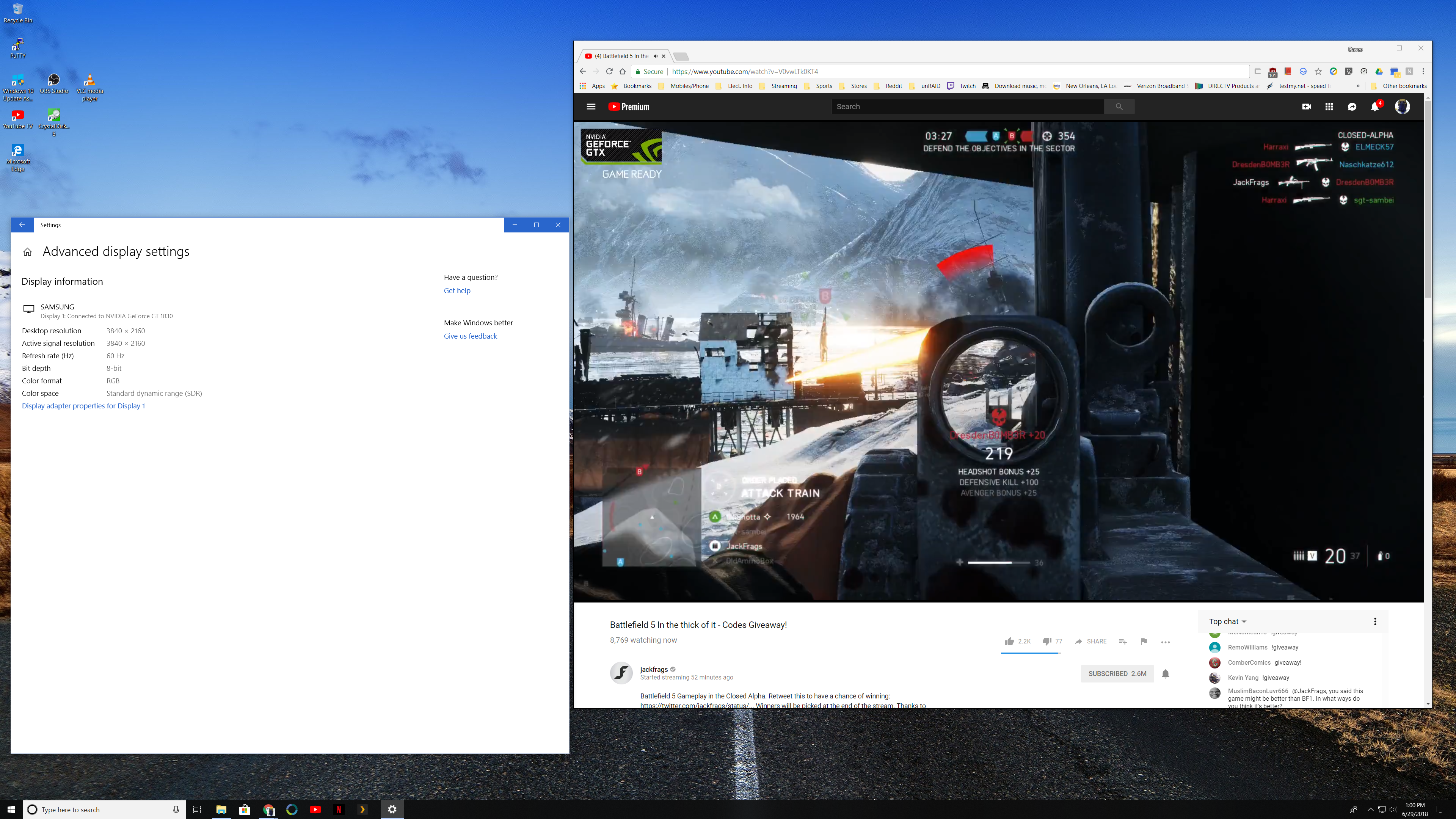

Just got a 4k 40 inch samsung today. Got it running with my mac and windows VMs today. 4k 60 fps too using a GT 1030 passthru. Beware i tried some 4k 60 HDR video and that hit the VM hard but everything else is smooth. I give my VMs 8 vCpus and 8 GB of ram.
I guess i may need a GTX 1050 Ti if i want to play with some 4K HDR.
This is at 125% scaling
