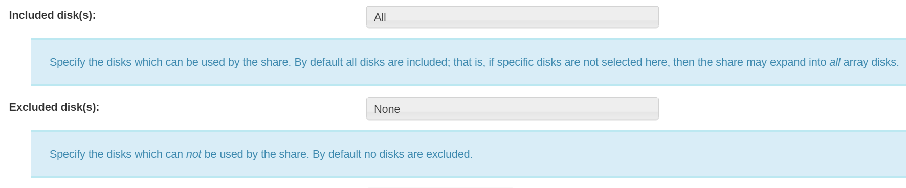

Another suggestion is to rename the include / exclude options, and update the descriptions.
When you turn on the "help" feature on a user share, here is what it says:
These definitions are simply false. Except in a simple minded situation that the settings are set when the user share is created and no disk is ever excluded from a user share after files were place on that disk.
Included / not excluded disk setting are ignored when browsing the user share. So excluded disks are always seen when browsing the user share. They are ignored when overwriting a file that exists on ANY disk in a folder with the user share name. They are ignored if the split level is satisfied on ANY disk in a folder with the user share name. They only apply when writing a file that is not being overwritten, and whose split level is not satisfied on any disk. So excluding a disk from the share does not exclude the disk from the share.
A better description AND labeling should be used. Include/exclude is simply too easy to misunderstand. Maybe "Include for new files" and "Exclude for new files". At least a user will understand that it is not all encompassing.
