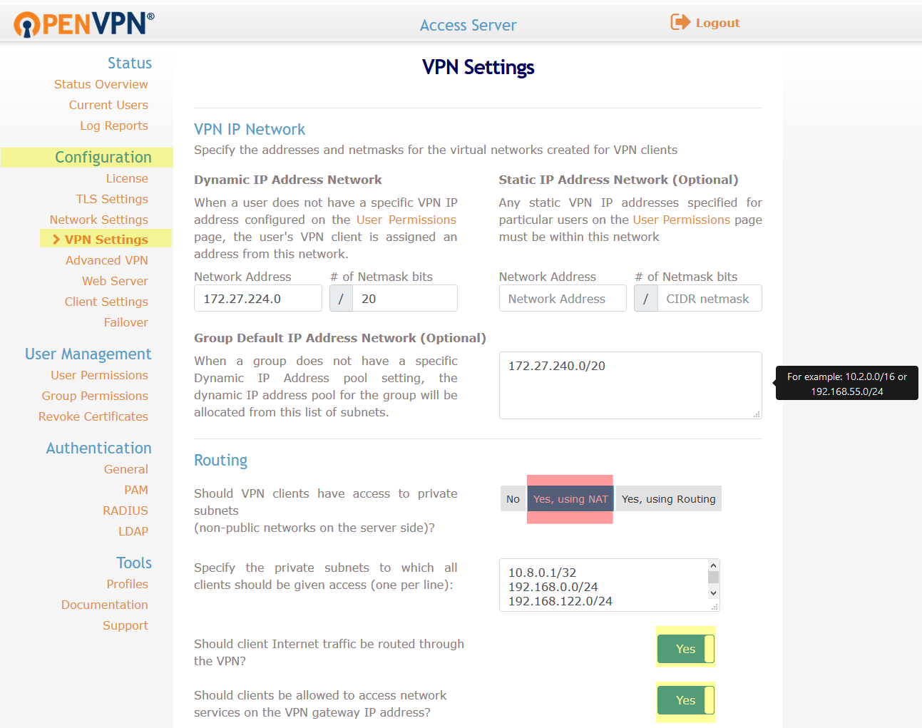

These are my OpenVPN-AS settings, please compare the configuration with yours. The red-highlighted is the most important, then the yellow highlights

1 hour ago, FlorinB said:
Then something is wrong or not completely configured into OpenVPN-AS.

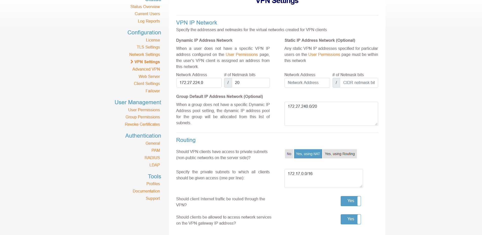

here is mine

1 minute ago, Annie SIxgun said:
here is mine
and 172.16.x.y is your private subnet and your unRaid server have an IP within that range. Same for your router.
- make a ping from your VPN client towards your unRaid IP, as Johnathan recommended.
-  do a traceroute from your VPN client towards your unRaid IP
and post the results here.
I have no idea. about  address  172.16.x.y  it was inserted by the software
my tracerout said unreachable
my unraid server is on 192.168.x.y
I have no idea either  how your network and unRaid is configured, however please leave that 172.16.0.0/16 there and add your 192.168.0.0/24 (or /16 depending of your network settings).
if the netmask of your internal network is 255.255.255.0 that means /24
if the netmask of your internal network is 255.255.0.0 that means /16
Save and update the configuration on your OpenVPN-AS docker, test again and let us know the result.
If is not working please post here the full output of your traceroute towards unRaid server.
Edited by FlorinB
if the netmash of your internal network is 255.255.0.0 that means /16
I will do that right now.. HOWEVER>> doing a trace rout from my phone (never done it befor) says I have to turn on wifi.. ok
That is why I said it is more difficult from a cell phone.
ok changes made and retest
