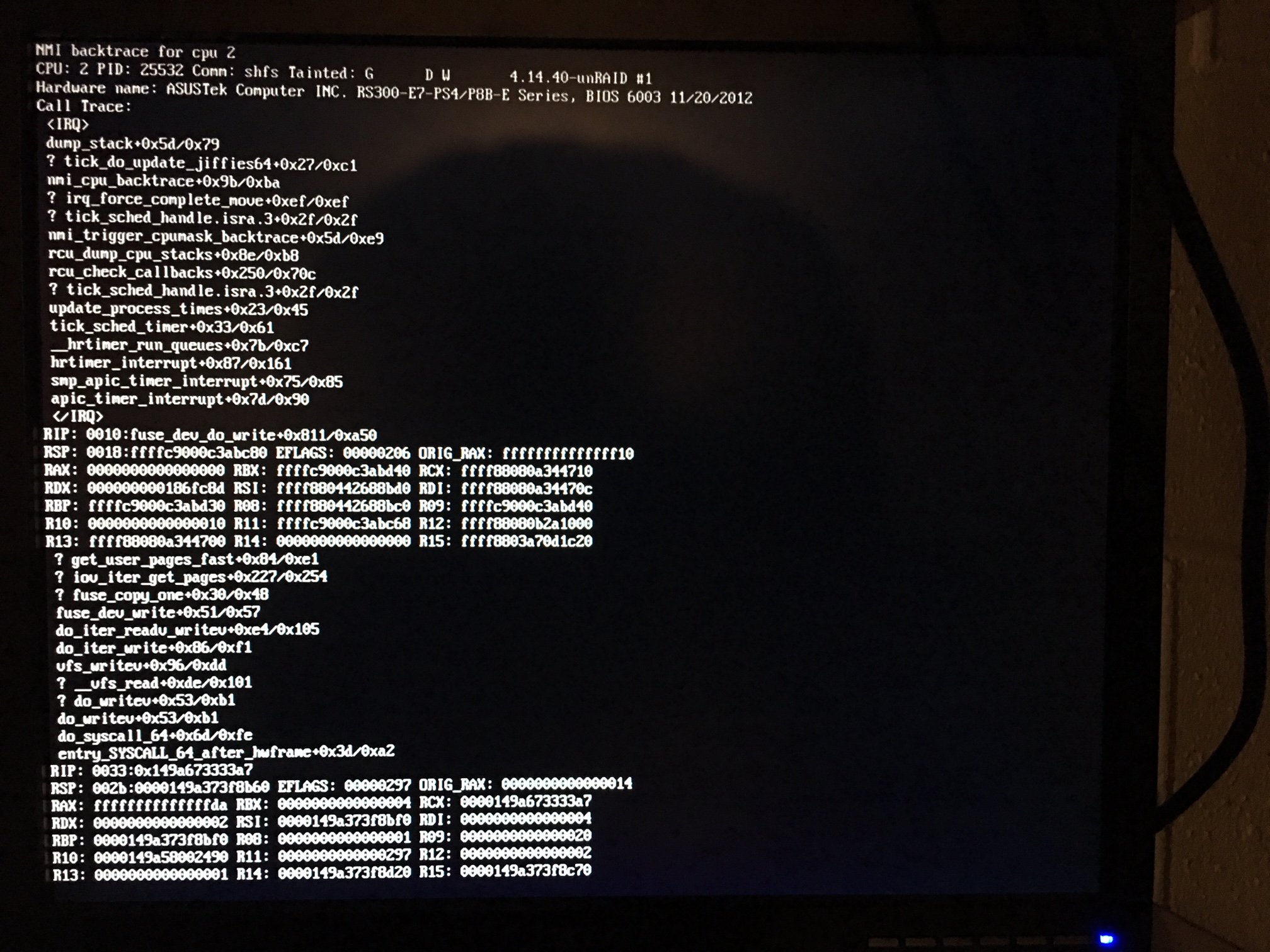

The server hangs completely, so I am unsure if the diagnostics zip has a full syslog of the issue. This particular incident happened on 6/14, before I updated to 6.5.3.. but it has since happened again after the update.
The server was recently decommissioned as a HyperV server that ran a handful of images without issue. The only difference is the drives, which I refreshed...except for the cache drive. It is randomly getting CRC errors and I have planning on replacing it, but while I could be wrong, I dont believe that those CRC errors on a cache drive would cause the server to lock up entirely?
Attached is also a screenshot of the console, the server was completely unresponsive and required a reset button to bring it back.
The server will function for maybe up to a week without issue, and then randomly crash. It happened as recent as 6/25 but I wasnt able to get a screenshot.
The server isnt doing much at all, it has a few file share volumes, runs plex for the kids, and a unifi docker for my wireless network. I would like to start using it for VMs, but until I can resolve this, I am hesitant.
Please let me know if there is more that I can gather to help you help me :)
Any suggestions at all?

Macvlan call traces are usually related to this:
Definitely could be the issue. I do have Unifi docker set with an assigned IP different from my unraid host.
I read through the post and I am to believe we are waiting on a possible kernel fix to assigning IPs in dockers to br0? I dont currently use vlans on my unraid, the 4 NICS i have are setup as LACP so I currently dont have the option of assigning docker to specific eth interfaces.
