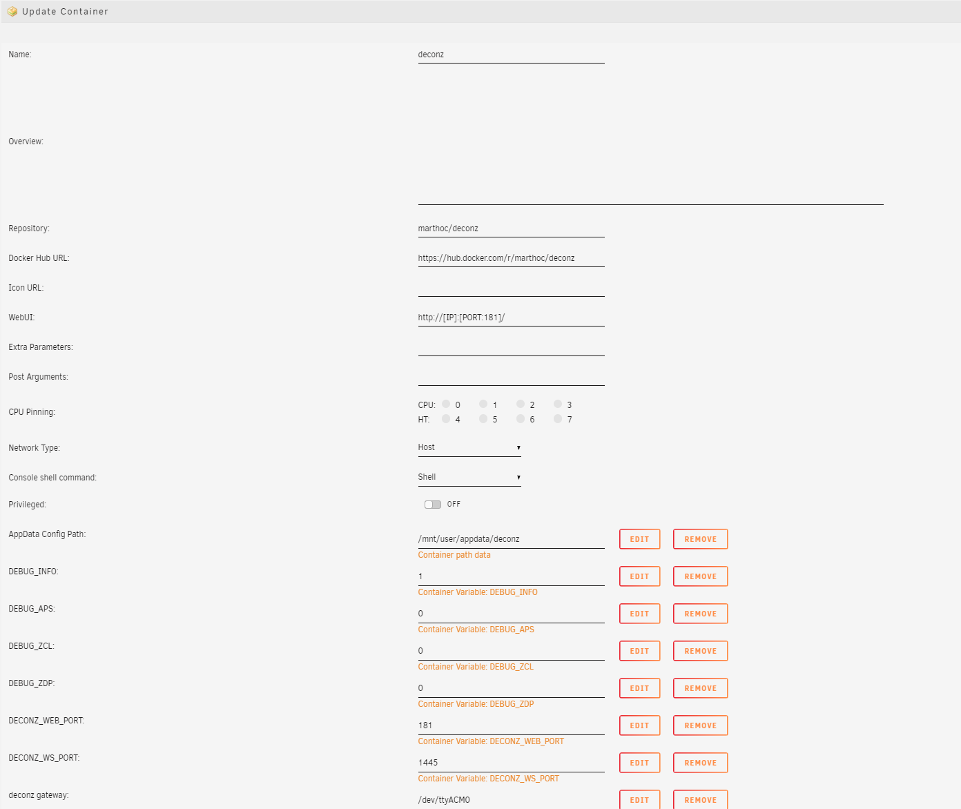

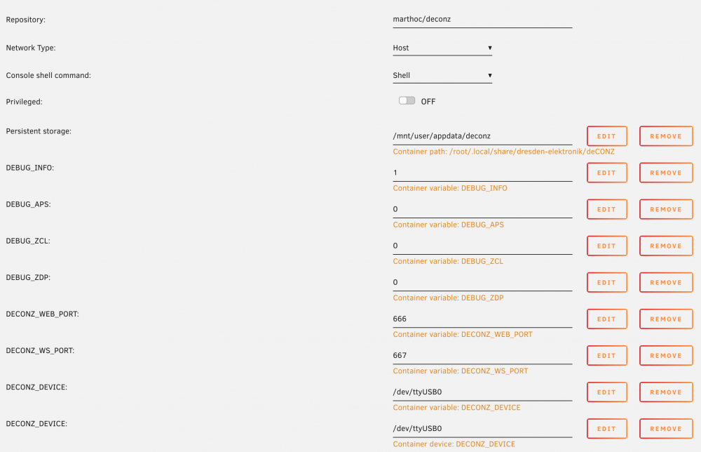

I haven't used the unRAID interface to add an environment variable before.
This is what I have now, does it appear that I have added them appropriately?
(I selected an alternate port for the webui, as 80 is devoted to unRAID as far as I understand it.)
I will have to set up my lights again this evening and check if the configuration sticks this time.
Thank you for your help so far!
Edited by Ruthalas
So far this seems to be working!
It still doesn't store anything in the folder I mapped for it, but I do not know that it ought to be. ~shrug~
Thank you both for your help!

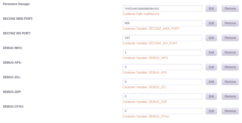

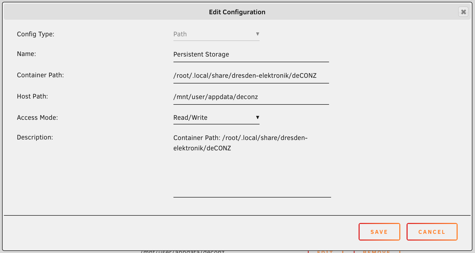

I got this working today, I think there was a misunderstanding about which path the container needs mapped. The deCONZ application writes to:
/root/.local/share/dresden-elektronik/deCONZ
So that is the container path that needs to be mapped to appdata. I have mine set up like this screenshot and it is properly writing to appdata.
Thanks! This worked perfectly. I should have checked this months ago since I lost my entire config at the time of restart thinking it was the /opt/ path.

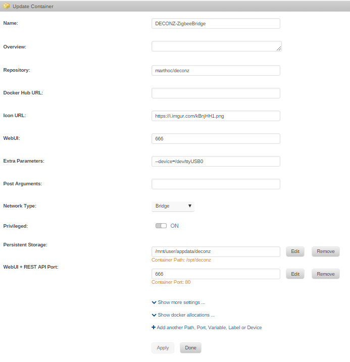

I hope it's OK to post here. I would be very grateful for some help.
With above feedback I've got the docker running properly (I think). However, I’m unable to pass through my conbee II stick. If I use --device=/dev/ttyUSB0 as extra parameter, the docker will not start.
When I run command lsusb on my unRAID console, I get:

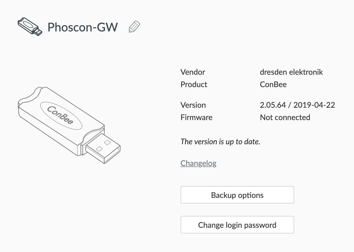

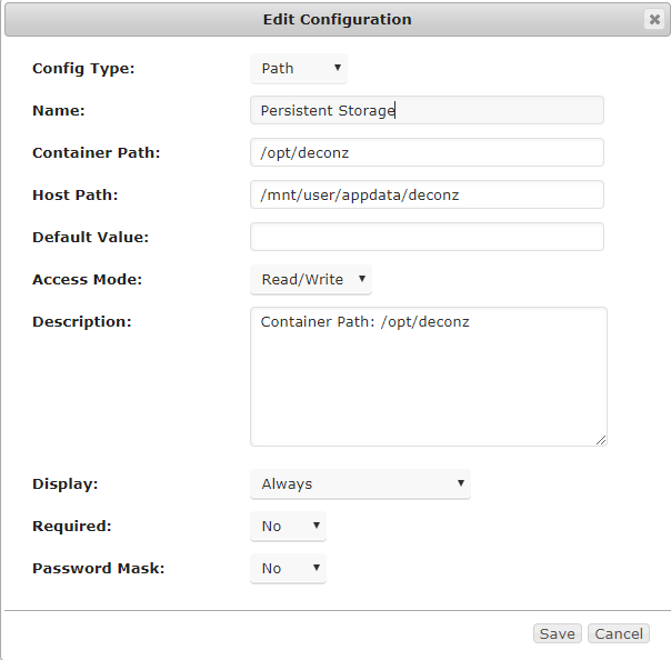

I believe I have the same problem as you guys. I got the Deconz docker container up and running but the Conbee (I) device is not discovered. At least I can't add my Ikea Trådfri control outlet and when I check the gateway settings in the web ui it says: "Firmware Not connected".
After I have read the posts above I think I have entered the correct settings for the docker container:
Am I doing anything wrong?

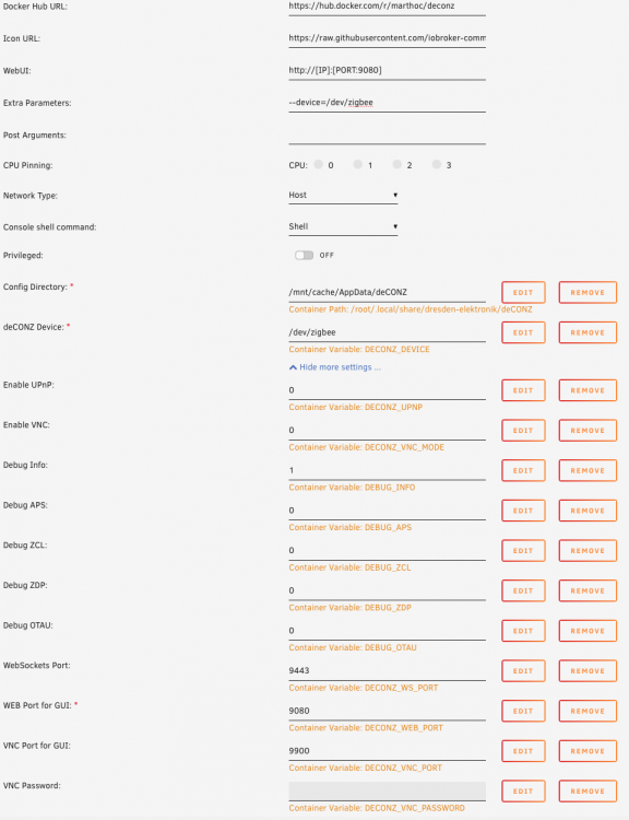

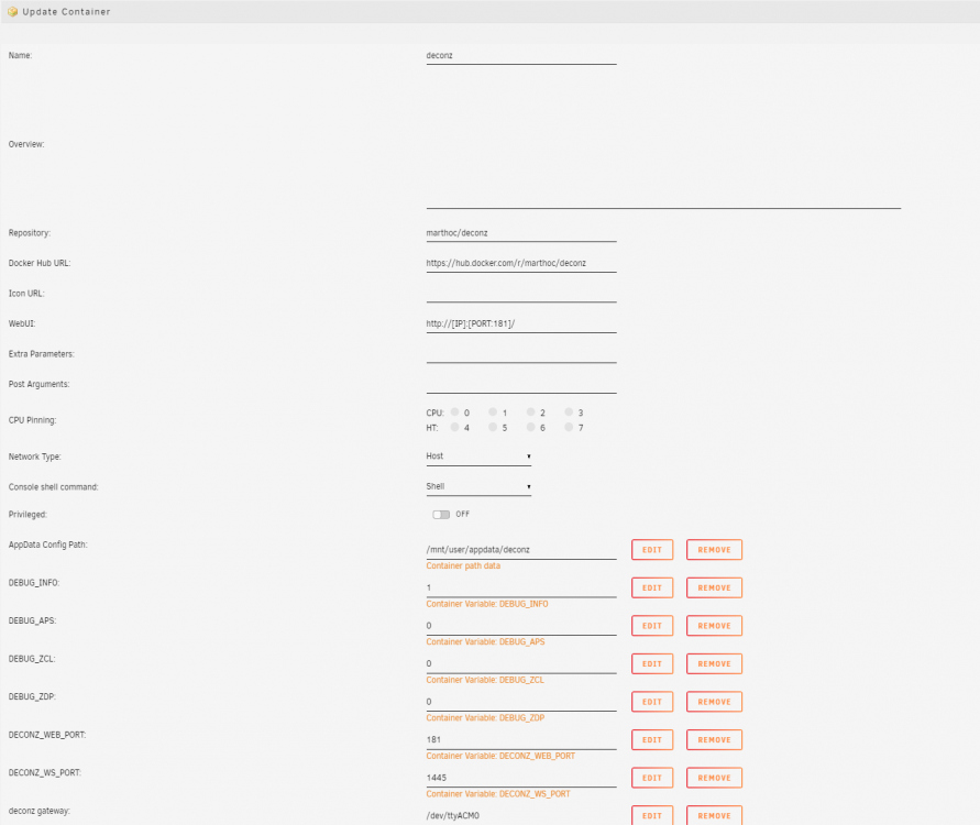

I recently bought a Conbee II as well and had some troubles forwarding it into the marthoc/deconz docker. First I started to add a new docker in unraid completely from scratch, since it is not available as a community app. These are my settings for the docker container:Unbenannt.thumb.PNG.dbf3708aa4f2899689cb9367157e48f6.PNG
The deconz gateway variable has to be a "device" as config type. Keep in mind that there are different device names for the gateways:
Conbee I = /dev/ttyUSB0 (default)
Conbee II = /dev/ttyACM0
Raspbee =  /dev/ttyAMA0 or /dev/ttyS0
Be sure to dial out any serial devices as mentioned in the docker instructions before forwarding the device:
sudo usermod -a -G dialout $USER
Starting the docker with these settings worked perfectly for me. The Conbee II will be identified correctly.

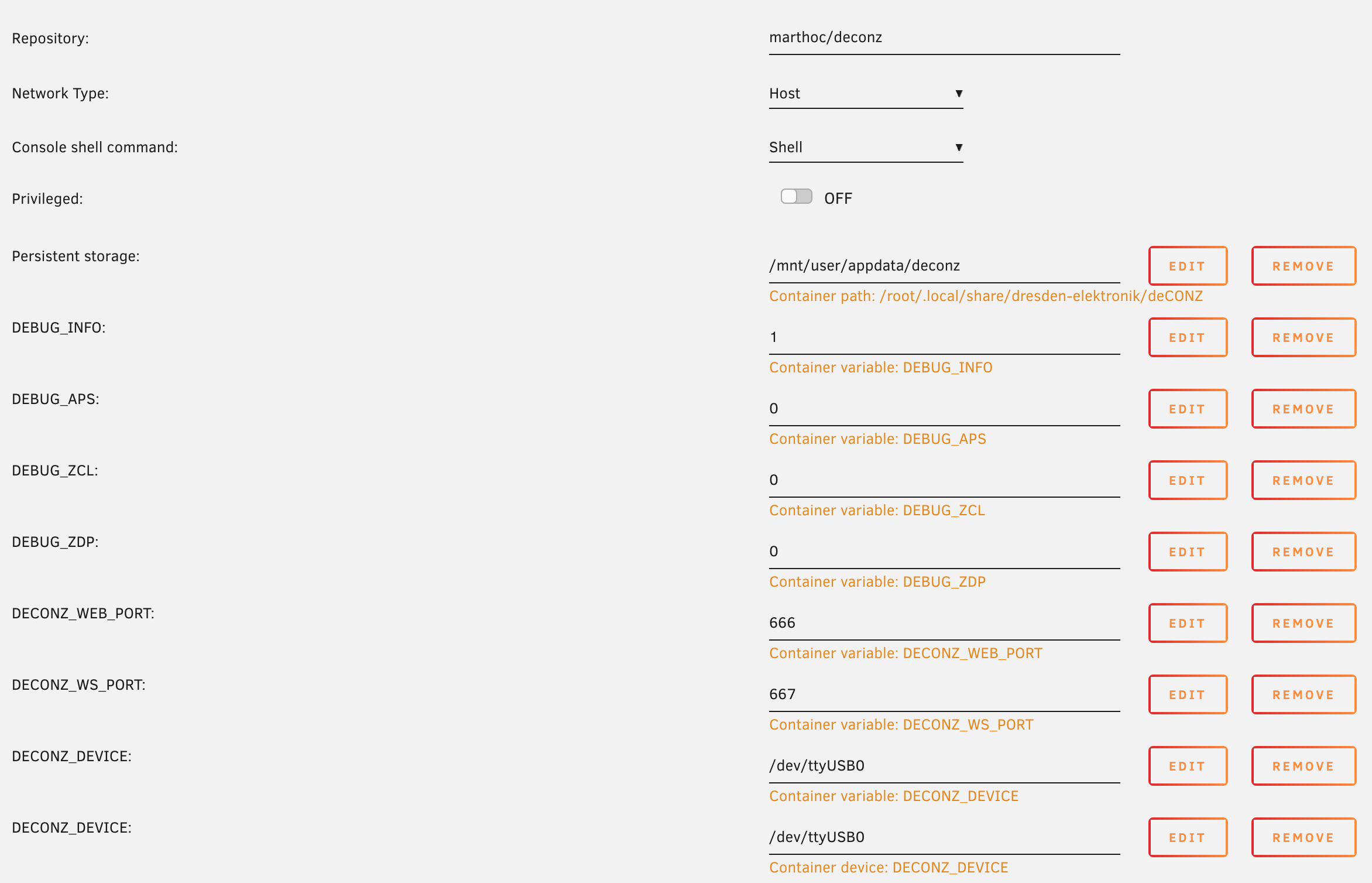

In Community Apps, search for deconz and click the Click Here To Get More Results From DockerHub and install the container from marthoc.
You'll want to set Network Type to Host.
At the bottom of the page will be the link Add another Path, Port, Variable, Label or Device. It does what it says.
Add the container path /root/.local/share/dresden-elektronik/deCONZ to point to your config directory, ex. /cache/appdata/deconz
You'll also want to pass your device into the container. I just use the Extra Parameters field to do this: --device=/dev/[your_device]
Then pass any of the environment variables you need listed on this page (passing them all is fine, just define the values):
https://hub.docker.com/r/marthoc/deconz/
The Conbee II defaults to the device name /dev/ttyACM0. If you have another USB device like an Aeotec Zstick, it will also try to assign itself  /dev/ttyACM0 or  /dev/ttyACM1 (depends on which device is assigned first upon boot).
Read this about setting a persistent name if thats the case:
https://forums.unraid.net/topic/71372-usb-passthrough-device-location-changing/
Then add the Environment Variable DECONZ_DEVICE and enter the value of your persistent name, ex. /dev/[persistent_name]
Make sure to telnet into your server and add the user to the dial out group the Drahznar suggested above.
If you're having problems with the device connecting in the container, try updating the firmware. I did my firmware update in Windows as I couldn't get it to flash successfully using the docker firmware method described on the docker page.
Attached is how I setup my container.

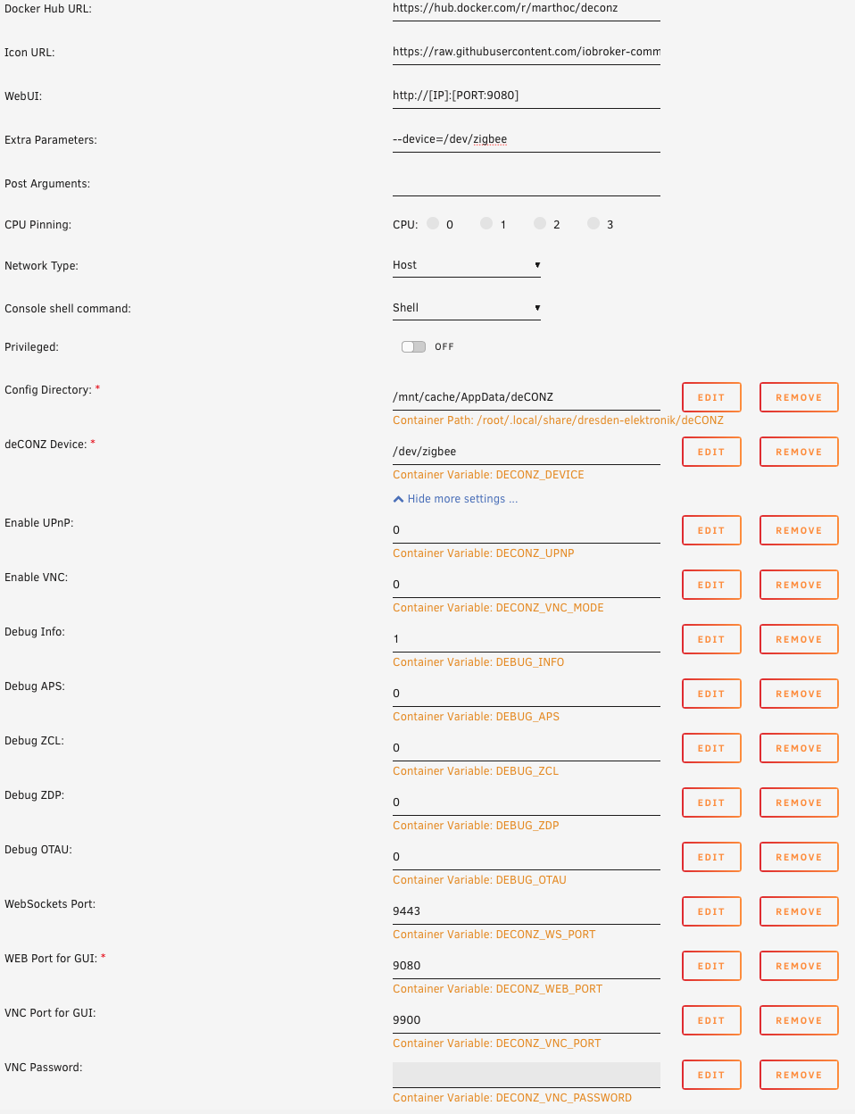

I used ls -l /dev/serial/by-id to get the serial ID. As long as you don't plug the Conbee into a different USB port than the one its in now in the future, what you have should work fine.

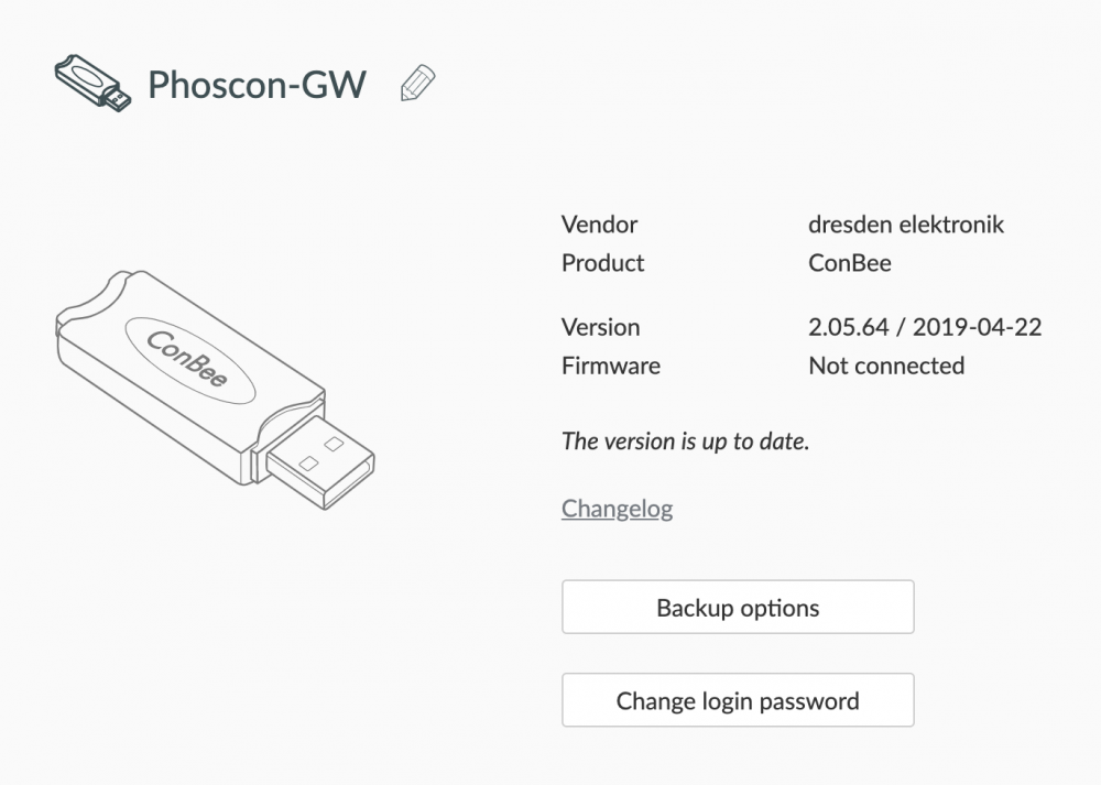

Once you log into Phoscon > Hamburger Menu > Settings > Gateway, if it shows a firmware number, its connected. Otherwise it will say "not connected"
---------- EDIT
I don't get it. I followed you little guide but it just doesnt work for me. The device when i use  ls -l /dev/serial/by-id is ttyACM1 for me and i can start up Decons docker and log in but it shows me the stick but the firmware says Not Connected. I have tried everything ;(
This is what my docker looks like.. ;(
Of couse i got it working but as usual: I don't know how.
I read somewhere about using an extension cord so i plugged on in and restarted Unraid, ran the command to see the port which had changed once. I changed it and restarted the docker container and then it worked. Maybe not much information but maybe it can be helpful for someone.
Thanks for the guide, much appreciated!
Bought Unraid today after trail ended. It's really nice and i really like it :)
Edited by mituv85

Hi all,
I tried to setup Deconz following your post but I receive error in log :
New 'Joshua:80 (root)' desktop at :80 on machine Joshua
Starting applications specified in /etc/X11/Xvnc-session
Log file is /root/.vnc/Joshua:80.log
Use xtigervncviewer -SecurityTypes VncAuth,TLSVnc -passwd /root/.vnc/passwd Joshua:80 to connect to the VNC server.
18:31:00:188 HTTP Server listen on address 0.0.0.0, port: 666, root: /usr/share/deCONZ/webapp/
18:31:00:206 CTRL. 3.16.218:31:00:229 COM: /dev/ttyACM0 / serialno:
18:31:00:229 COM: --dev: /dev/ttyACM0 (ConBee II)
18:31:00:229 ZCLDB init file /root/.local/share/dresden-elektronik/deCONZ/zcldb.txt
18:31:00:332 parent process /bin/sh
18:31:00:332 gw run mode: docker
18:31:00:332 GW sd-card image version file does not exist: /root/.local/share/dresden-elektronik/deCONZ/gw-version
18:31:00:336 DB sqlite version 3.16.2
18:31:00:336 DB PRAGMA page_count: 37
18:31:00:336 DB PRAGMA page_size: 4096
18:31:00:337 DB PRAGMA freelist_count: 0
18:31:00:337 DB file size 151552 bytes, free pages 0
18:31:00:337 DB PRAGMA user_version: 6
18:31:00:337 DB cleanup
18:31:00:360 DB create temporary views
18:31:00:385 don't close database yet, keep open for 900 seconds
18:31:00:385 started websocket server at port 443
18:31:00:389 found node plugin: libde_rest_plugin.so - REST API Plugin
18:31:00:390 found node plugin: libde_signal_plugin.so - Signal Monitor Plugin
18:31:00:397 found node plugin: libstd_otau_plugin.so - STD OTAU Plugin
18:31:00:407 COM: /dev/ttyACM0 / serialno:
18:31:00:407 COM: --dev: /dev/ttyACM0 (ConBee II)
18:31:05:892 Announced to internet http://dresden-light.appspot.com/discover
18:31:07:813 Invalid admin password hash: $1$8282jdkm$w.o6XjJEGLzAYkVqLPAYx1
18:31:10:900 COM: /dev/ttyACM0 / serialno:
18:31:10:900 COM: --dev: /dev/ttyACM0 (ConBee II)
18:31:10:945 device disconnected reason: 4, index: 0
18:31:11:892 wait reconnect 15 seconds
18:31:11:900 COM: /dev/ttyACM0 / serialno:
18:31:11:900 COM: --dev: /dev/ttyACM0 (ConBee II)
18:31:12:893 wait reconnect 14 seconds
I used
to solve USB running command on unraid console and then reboot but nothing changed.
Can someone please support me?
TY
