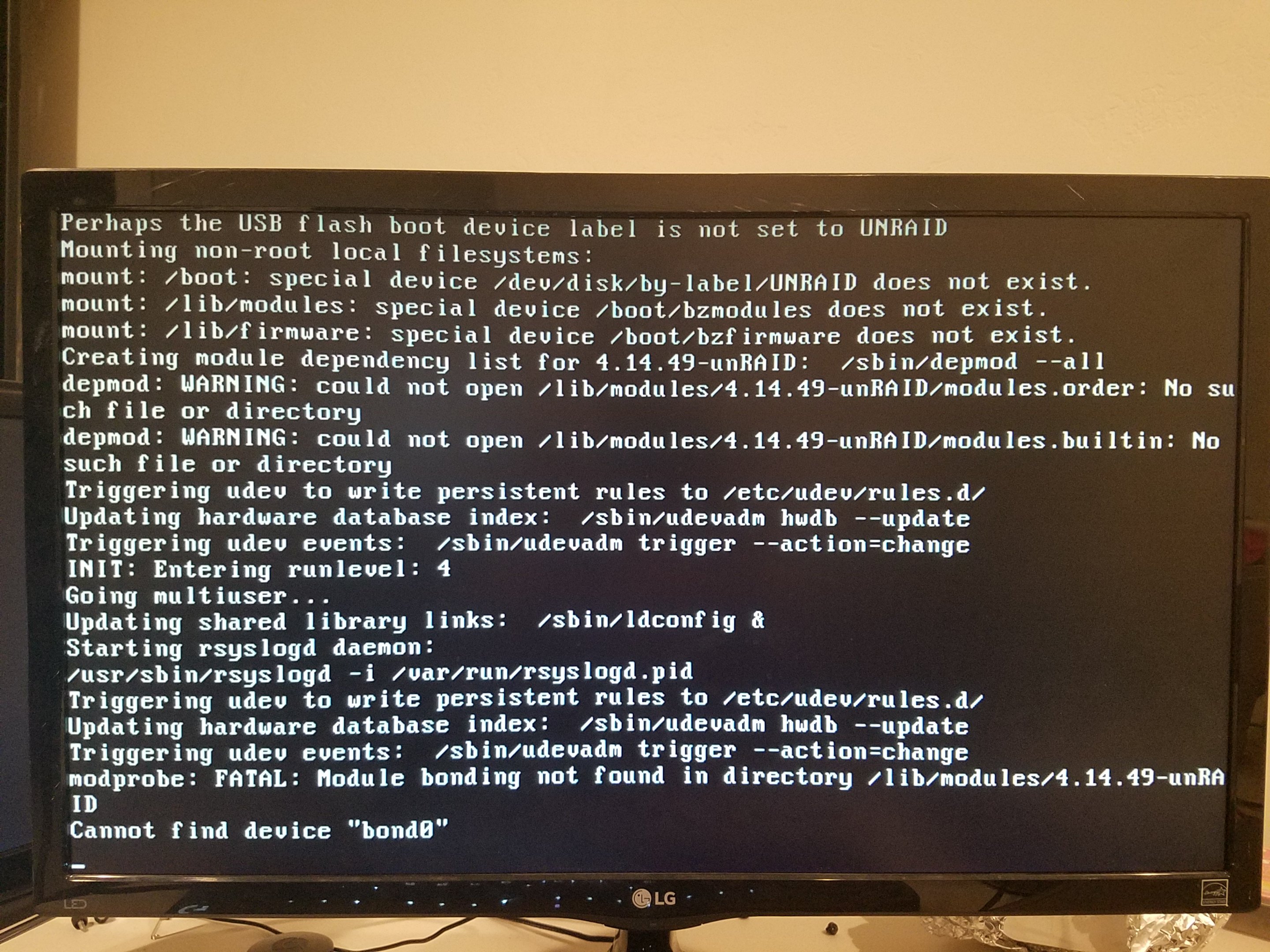

The problem is whenever I try to raise any ethernet interfaces it doesn't let me because apparently they don't exist. My guess is that the kernel modules aren't loading properly because before the login prompt it throws some errors about not being able to see the USB drive and not being able to load some modules because it can't find them. I've tried using multiple USB drives from various manufacturers using USB 2 and 3, but no luck.

I've attached a picture of the errors, as well as my diagnostics.zip. I've verified that the USB's name is UNRAID and it is formatted in FAT32 and that the modules are in the bzmodules file on the USB drive. If you need any more diagnostic information, I'd be happy to provide it.

The screen shot shows that unRAID is not seeing the USB drive so that it can be mounted correctly at /boot (and thus complete initialisation successfully).  This would explain your symptoms.  You should check that it is formatted as FAT32 and labelled ‘UNRAID’.  Also if you have a choice USB2 ports tend to be more reliable than USB3 ports.
If you read my original post, I say I have done all of these things. Unraid changed how it loaded kernel modules after 6.3, so maybe that's the reason it's not working.

One thing sticks out, it can't find bond0  I'd guess that's not a default thing, and it would expect eth0.  Is this 100% a fresh config?  Just wondering how bond0 came to be, any remnant of a previous config perhaps?
Nope, fresh install of 6.5.3. I didn't keep backups of my previous config, although I definitely will now...
