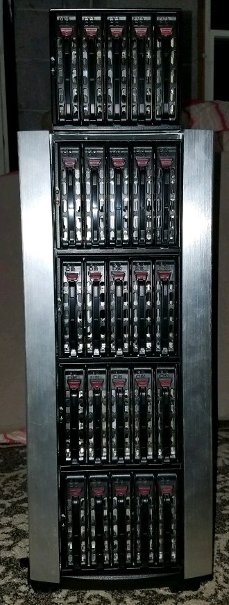

I am not that familiar with the Norco, and can say that I am not a big fan of their hot swap mechanism. Other users have found a similar SuperMicro case that I would recommend over the Norco.
Look at these HBAs - LSI SAS9201-8i, -16i, or even -16e (which is a lot less than the -16i but made for 16 external drives, but the cables can be routed back into the case). I am not that familiar with the rack-mount cases, and not sure what cabling you'd need to install them.
BTW, I prefer a tall tower to a rack mount. Keeps small floor footprint and easier to navigate if I need to move it. I bolted that top 5in3 on top, and could keep adding more if I ever need to, and get to 30, 35, or maybe 40 drives.
