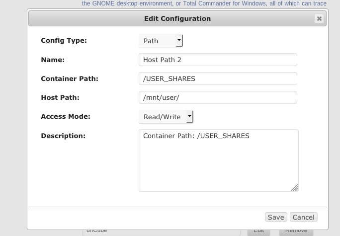

So, in this example, a default path in Krusader, Host Path 2 is shown below.  This is a screen shot of the set-up screen for the Krusader Docker.  By the way, this can be edited by right clicking on the Krusader Docker in the Docker's tab, and clicking "Edit".
It says that the unRAID user shares which are located in the directory /mnt/user/ can be found in Krusader via the Krusader Docker path of /USER_SHARES.  So, in this example, when I click on the "USER_SHARES" folder located at "Root" inside the Krusader Docker, I see the folders and files located in the array at /mnt/user/.  In other words, I see all the exported User Shares located on the "Shares" tab in the unRAID GUI.
See the "Edit Configuration" pop up screen (below) which is accessed by clicking on the "Edit" button that is seen in the picture above.  This is where you can change both the Container Path and the Host Path.  The main screen only gives the option to provide the Host Path, expecting you to keep the default Container Path.
