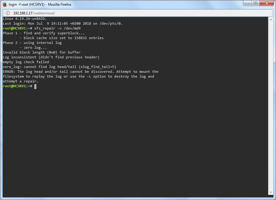

Then in the terminal I typed the command:
xfs_repair -v / dev / md9
I got the following message

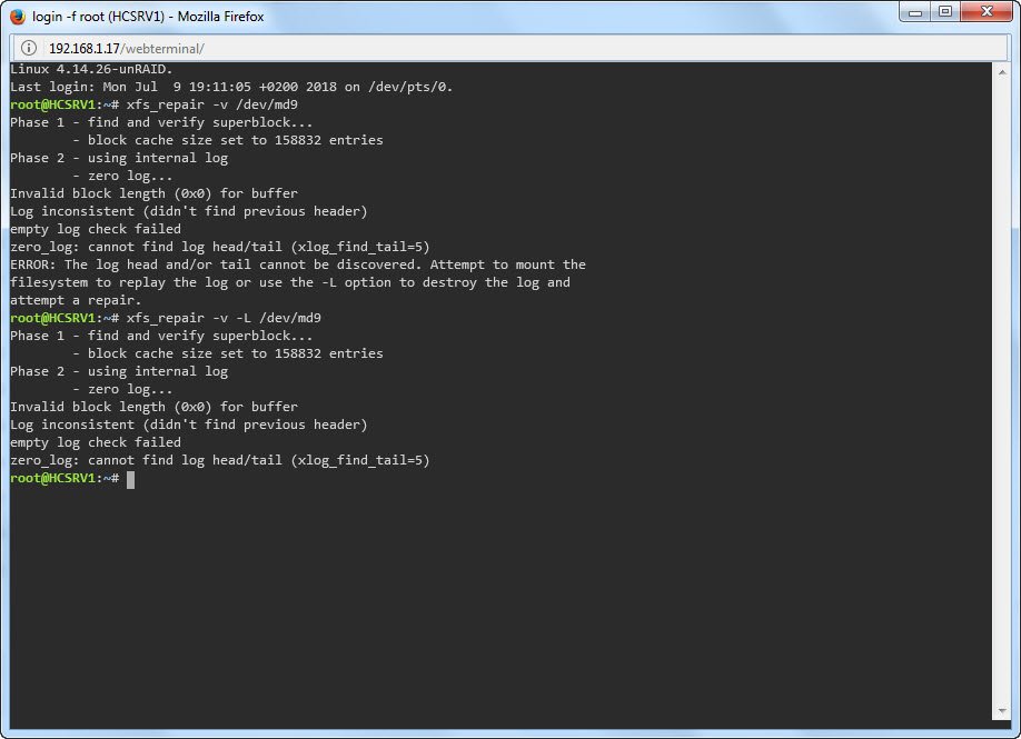

I then typed the following command
xfs_repair -v -L / dev / md9
Is the next step formatting the disk as shown in the message:
In this case will the disk be rebuilt from the Parity disk?
No, formatting will delete all data and update parity accordingly.
There seems to be a problem with that disk since no SMART data is displayed, there are also various timeout errors on the SASLP, that controller is not recommend for current unRAID since it can cause issue with the disks connected.
The current problem may not have anything to do with the above, but to rule out controller issues, and since disk9 is connected on the SASLP swap SATA cable with a disk connected on the onboard controller and run xfs_repair again, if it still fails post new diags.

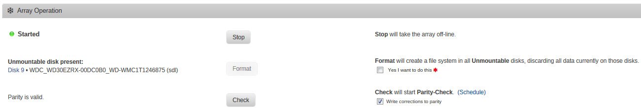

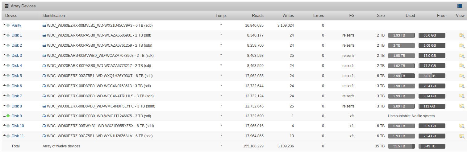

A priori the parity disk is built from sectors and not from the file system, the latter is only used to access files through samba or nfs
We see on the following image that my disk 9 was read without error for the parity check : the disk is ok
Why then if I put a new disc, this one will not recover the data of the disc which it replaces, since this new disc will be first formatted in xfs?
If the problem is the disk or the controller, replacing either will fix the problem, if it's really a corrupt filesystem rebuilding will rebuild an exact byte by byte copy of the current disk, including the existing file system corruption.
