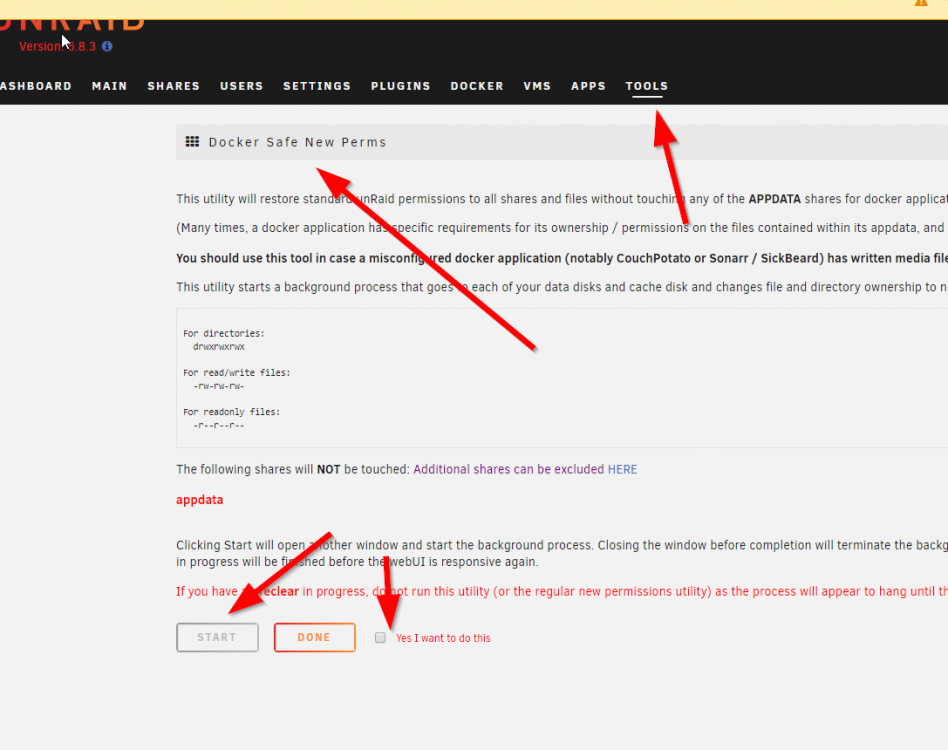

    Hi @Toskache, @nik82, @sunpower,   Apologies for being absent this past week, and thanks for your patience!   Thank you for letting me know about this issue. From your description

    Great to hear @sunpower, @nik82! Thanks for letting me know that it's working for you - now I can be confident that I correctly understood the problem     I will file an issue in my github b
  • Are you sure you are looking in the right place? This would be in your Download share in the pdf/output folder.   Maybe that is where you looked, but since you are new I thought maybe
