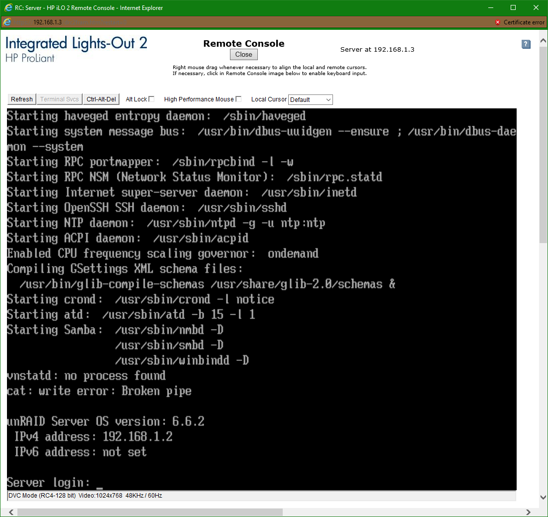

Looks to be working now!! Seeing these error on the server's screen tho.
Cant remember if vnstatd is a Plugin or not, don't know what cat is.
¯\_(ツ)_/¯
