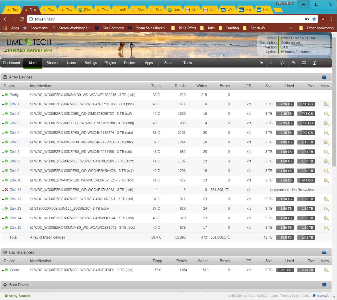

July 7, 20188 yr One of my disk has failed. I have enough space to reduce the array. I want to reduce the array and not replacing failed drive with new drive. Is it possible? I want to move the contents of disk 11 but it is not mounted to i cant find the file i need to move. Tried using unbalance, unbalance didnt see the file contents. I believe the contents are emulated. But I dont know where I can get the emulated contents. Where is the emulated contents of disk 11? I want to move emulated contents to other drive using unbalance. Then Shrink the array. This is the guide to shrink array that I use. https://lime-technology.com/wiki/Shrink_array I use the first method.
July 8, 20188 yr Community Expert The emulated disk is unmountable. You will have to repair its filesystem just as you would for any physical disk that is unmountable.
July 8, 20188 yr Author Here are my diagnostics. tower-diagnostics-20180708-1343.zip As for repair filesystem, is this the correct guide i should use? https://lime-technology.com/wiki/Check_Disk_Filesystems#Drives_formatted_with_XFS As for shrinking array instead of replacing drive, is it possible?How?
July 8, 20188 yr Author When I tried to repair filesystem, this is what i get. Linux 4.14.13-unRAID. root@Tower:~# xfs_repair -v /dev/md11 Phase 1 - find and verify superblock... - block cache size set to 356656 entries Phase 2 - using internal log - zero log... * ERROR: mismatched uuid in log * SB : 9dac4bea-ab9e-4d04-8475-cac1c43ba536 * log: 4aa81568-87dd-447d-8b0c-8b2890458e39 zero_log: head block 2861570 tail block 2861013 ERROR: The filesystem has valuable metadata changes in a log which needs to be replayed. Mount the filesystem to replay the log, and unmount it before re-running xfs_repair. If you are unable to mount the filesystem, then use the -L option to destroy the log and attempt a repair. Note that destroying the log may cause corruption -- please attempt a mount of the filesystem before doing this. root@Tower:~# From what I understand, I need to 1. mount the filesystem 2. replay the log 3. unmount filesystem 4. run xfs repair What does it mean by 'Unable to mount the filesystem? I can mount unraid array. but failed drive are unmountable. I have already removed the drive. Should I put it back? THen try to mount the failed drive? If i cant mount the failed drive, I should repair filesystem with this command? xfs_repair -v /dev/md11 -L What corruption can happen if i destroy the logs? Would I lost all data on the drive? What should I do if i dont want to lose data? My parity drive is still working.
July 8, 20188 yr Author I have executed xfs_repair -v /dev/md11 -L without the failed drive in the server. Should I put the drive back to the server before do the repair or it wont matter? Since I cant start smart test, I assume the drive failed. Its failed right? Here are the logs of repair. entry "165993910" at block 0 offset 2472 in directory inode 547354263 references non-existent inode 3154364009 clearing inode number in entry at offset 2472... entry "166849528" at block 0 offset 2496 in directory inode 547354263 references non-existent inode 5378214311 clearing inode number in entry at offset 2496... entry "168693438" at block 0 offset 2520 in directory inode 547354263 references non-existent inode 7891311695 clearing inode number in entry at offset 2520... entry "169218983" at block 0 offset 2568 in directory inode 547354263 references non-existent inode 3154364010 clearing inode number in entry at offset 2568... entry "170413159" at block 0 offset 2592 in directory inode 547354263 references non-existent inode 5378214312 clearing inode number in entry at offset 2592... entry "170471175" at block 0 offset 2616 in directory inode 547354263 references non-existent inode 7891311696 clearing inode number in entry at offset 2616... entry "171427244" at block 0 offset 2664 in directory inode 547354263 references non-existent inode 3154364011 clearing inode number in entry at offset 2664... entry "171666668" at block 0 offset 2688 in directory inode 547354263 references non-existent inode 5378214313 clearing inode number in entry at offset 2688... entry "171809165" at block 0 offset 2712 in directory inode 547354263 references non-existent inode 7891311697 clearing inode number in entry at offset 2712... entry "172740415" at block 0 offset 2760 in directory inode 547354263 references non-existent inode 3154364012 clearing inode number in entry at offset 2760... entry "172983061" at block 0 offset 2784 in directory inode 547354263 references non-existent inode 5378214314 clearing inode number in entry at offset 2784... entry "172992844" at block 0 offset 2808 in directory inode 547354263 references non-existent inode 7891311698 clearing inode number in entry at offset 2808... entry "174948830" at block 0 offset 2856 in directory inode 547354263 references non-existent inode 3154364013 clearing inode number in entry at offset 2856... entry "175140232" at block 0 offset 2880 in directory inode 547354263 references non-existent inode 5378214315 clearing inode number in entry at offset 2880... entry "176444499" at block 0 offset 2904 in directory inode 547354263 references non-existent inode 7891311699 clearing inode number in entry at offset 2904... entry "177781904" at block 0 offset 2952 in directory inode 547354263 references non-existent inode 3154364014 clearing inode number in entry at offset 2952... entry "177873525" at block 0 offset 2976 in directory inode 547354263 references non-existent inode 5378214316 clearing inode number in entry at offset 2976... entry "180641398" at block 0 offset 3000 in directory inode 547354263 references non-existent inode 7891311700 clearing inode number in entry at offset 3000... entry "182604249" at block 0 offset 3048 in directory inode 547354263 references non-existent inode 3154364015 clearing inode number in entry at offset 3048... entry "183769973" at block 0 offset 3072 in directory inode 547354263 references non-existent inode 5378214317 clearing inode number in entry at offset 3072... entry "183834825" at block 0 offset 3096 in directory inode 547354263 references non-existent inode 7891311701 clearing inode number in entry at offset 3096... entry "185416388" at block 0 offset 3144 in directory inode 547354263 references non-existent inode 3154364016 clearing inode number in entry at offset 3144... entry "186618398" at block 0 offset 3168 in directory inode 547354263 references non-existent inode 5378214318 clearing inode number in entry at offset 3168... entry "190236276" at block 0 offset 3192 in directory inode 547354263 references non-existent inode 7891311702 clearing inode number in entry at offset 3192... entry "194997295" at block 0 offset 3240 in directory inode 547354263 references non-existent inode 3154364017 clearing inode number in entry at offset 3240... entry "197146184" at block 0 offset 3264 in directory inode 547354263 references non-existent inode 5378214319 clearing inode number in entry at offset 3264... entry "197517841" at block 0 offset 3288 in directory inode 547354263 references non-existent inode 7891311703 clearing inode number in entry at offset 3288... entry "198146855" at block 0 offset 3336 in directory inode 547354263 references non-existent inode 3154364018 clearing inode number in entry at offset 3336... entry "204063065" at block 0 offset 3360 in directory inode 547354263 references non-existent inode 5378214320 clearing inode number in entry at offset 3360... entry "205935903" at block 0 offset 3384 in directory inode 547354263 references non-existent inode 7891311704 clearing inode number in entry at offset 3384... entry "207315813" at block 0 offset 3432 in directory inode 547354263 references non-existent inode 3154364019 clearing inode number in entry at offset 3432... entry "211764046" at block 0 offset 3456 in directory inode 547354263 references non-existent inode 5378214321 clearing inode number in entry at offset 3456... entry "212186928" at block 0 offset 3480 in directory inode 547354263 references non-existent inode 7891311705 clearing inode number in entry at offset 3480... entry "218182882" at block 0 offset 3528 in directory inode 547354263 references non-existent inode 3154364020 clearing inode number in entry at offset 3528... entry "218845004" at block 0 offset 3552 in directory inode 547354263 references non-existent inode 5378214322 clearing inode number in entry at offset 3552... entry "219106225" at block 0 offset 3576 in directory inode 547354263 references non-existent inode 7891311706 clearing inode number in entry at offset 3576... entry "221491969" at block 0 offset 3624 in directory inode 547354263 references non-existent inode 3154364021 clearing inode number in entry at offset 3624... entry "223238387" at block 0 offset 3648 in directory inode 547354263 references non-existent inode 5378214323 clearing inode number in entry at offset 3648... entry "223332449" at block 0 offset 3672 in directory inode 547354263 references non-existent inode 7891311707 clearing inode number in entry at offset 3672... entry "225052203" at block 0 offset 3720 in directory inode 547354263 references non-existent inode 3154364022 clearing inode number in entry at offset 3720... entry "227332722" at block 0 offset 3744 in directory inode 547354263 references non-existent inode 5378214324 clearing inode number in entry at offset 3744... entry "228210690" at block 0 offset 3768 in directory inode 547354263 references non-existent inode 7891311708 clearing inode number in entry at offset 3768... entry "232135055" at block 0 offset 3816 in directory inode 547354263 references non-existent inode 3154364023 clearing inode number in entry at offset 3816... entry "236189852" at block 0 offset 3840 in directory inode 547354263 references non-existent inode 5378214325 clearing inode number in entry at offset 3840... entry "236706599" at block 0 offset 3864 in directory inode 547354263 references non-existent inode 7891311709 clearing inode number in entry at offset 3864... entry "242837232" at block 0 offset 3912 in directory inode 547354263 references non-existent inode 3154364024 clearing inode number in entry at offset 3912... entry "249344147" at block 0 offset 3936 in directory inode 547354263 references non-existent inode 5378214326 clearing inode number in entry at offset 3936... entry "256036573" at block 0 offset 3960 in directory inode 547354263 references non-existent inode 7891311710 clearing inode number in entry at offset 3960... entry "262048092" at block 0 offset 4008 in directory inode 547354263 references non-existent inode 3154364025 clearing inode number in entry at offset 4008... entry "268047729" at block 0 offset 4032 in directory inode 547354263 references non-existent inode 5378214327 clearing inode number in entry at offset 4032... entry "268506291" at block 0 offset 4056 in directory inode 547354263 references non-existent inode 7891311711 clearing inode number in entry at offset 4056... entry "273415773" at block 1 offset 88 in directory inode 547354263 references non-existent inode 3154364026 clearing inode number in entry at offset 88... entry "273430986" at block 1 offset 112 in directory inode 547354263 references non-existent inode 5378214328 clearing inode number in entry at offset 112... entry "288106812" at block 1 offset 136 in directory inode 547354263 references non-existent inode 7891433152 clearing inode number in entry at offset 136... entry "293611841" at block 1 offset 184 in directory inode 547354263 references non-existent inode 3154364027 clearing inode number in entry at offset 184... entry "299001243" at block 1 offset 208 in directory inode 547354263 references non-existent inode 5378214329 clearing inode number in entry at offset 208... entry "299468655" at block 1 offset 232 in directory inode 547354263 references non-existent inode 7891433153 clearing inode number in entry at offset 232... entry "301393938" at block 1 offset 280 in directory inode 547354263 references non-existent inode 3154364028 clearing inode number in entry at offset 280... entry "307529583" at block 1 offset 304 in directory inode 547354263 references non-existent inode 5378214330 clearing inode number in entry at offset 304... entry "308037812" at block 1 offset 328 in directory inode 547354263 references non-existent inode 7891433154 clearing inode number in entry at offset 328... entry "311744321" at block 1 offset 376 in directory inode 547354263 references non-existent inode 3154364029 clearing inode number in entry at offset 376... entry "312896034" at block 1 offset 400 in directory inode 547354263 references non-existent inode 5378214331 clearing inode number in entry at offset 400... entry "314256055" at block 1 offset 424 in directory inode 547354263 references non-existent inode 7891433155 clearing inode number in entry at offset 424... entry "314478430" at block 1 offset 472 in directory inode 547354263 references non-existent inode 3154364030 clearing inode number in entry at offset 472... entry "318190743" at block 1 offset 496 in directory inode 547354263 references non-existent inode 5378214332 clearing inode number in entry at offset 496... entry "320170829" at block 1 offset 520 in directory inode 547354263 references non-existent inode 7891433156 clearing inode number in entry at offset 520... entry "324803305" at block 1 offset 568 in directory inode 547354263 references non-existent inode 3154364031 clearing inode number in entry at offset 568... entry "324906559" at block 1 offset 592 in directory inode 547354263 references non-existent inode 5378214333 clearing inode number in entry at offset 592... entry "326759860" at block 1 offset 616 in directory inode 547354263 references non-existent inode 7891433157 clearing inode number in entry at offset 616... entry "332630026" at block 1 offset 664 in directory inode 547354263 references non-existent inode 3154364032 clearing inode number in entry at offset 664... entry "335595420" at block 1 offset 688 in directory inode 547354263 references non-existent inode 5378214334 clearing inode number in entry at offset 688... entry "339073681" at block 1 offset 712 in directory inode 547354263 references non-existent inode 7891433158 clearing inode number in entry at offset 712... entry "346180879" at block 1 offset 760 in directory inode 547354263 references non-existent inode 3154364033 clearing inode number in entry at offset 760... entry "370694071" at block 1 offset 784 in directory inode 547354263 references non-existent inode 5378214335 clearing inode number in entry at offset 784... entry "376453093" at block 1 offset 808 in directory inode 547354263 references non-existent inode 7891433159 clearing inode number in entry at offset 808... entry "383719398" at block 1 offset 856 in directory inode 547354263 references non-existent inode 3154364034 clearing inode number in entry at offset 856... entry "389175812" at block 1 offset 880 in directory inode 547354263 references non-existent inode 5378900320 clearing inode number in entry at offset 880... entry "389196152" at block 1 offset 904 in directory inode 547354263 references non-existent inode 7891433160 clearing inode number in entry at offset 904... entry "404787951" at block 1 offset 952 in directory inode 547354263 references non-existent inode 3154364035 clearing inode number in entry at offset 952... entry "404985189" at block 1 offset 976 in directory inode 547354263 references non-existent inode 5378900321 clearing inode number in entry at offset 976... entry "410076632" at block 1 offset 1000 in directory inode 547354263 references non-existent inode 7891433161 clearing inode number in entry at offset 1000... entry "417985914" at block 1 offset 1048 in directory inode 547354263 references non-existent inode 3154364036 clearing inode number in entry at offset 1048... entry "422287242" at block 1 offset 1072 in directory inode 547354263 references non-existent inode 5378900322 clearing inode number in entry at offset 1072... entry "423491483" at block 1 offset 1096 in directory inode 547354263 references non-existent inode 7891433162 clearing inode number in entry at offset 1096... entry "423598051" at block 1 offset 1144 in directory inode 547354263 references non-existent inode 3154364037 clearing inode number in entry at offset 1144... entry "429890096" at block 1 offset 1168 in directory inode 547354263 references non-existent inode 5378900323 clearing inode number in entry at offset 1168... entry "432229163" at block 1 offset 1192 in directory inode 547354263 references non-existent inode 7891433163 clearing inode number in entry at offset 1192... entry "441482957" at block 1 offset 1240 in directory inode 547354263 references non-existent inode 3154364038 clearing inode number in entry at offset 1240... entry "454002736" at block 1 offset 1264 in directory inode 547354263 references non-existent inode 5378900324 clearing inode number in entry at offset 1264... entry "454073257" at block 1 offset 1288 in directory inode 547354263 references non-existent inode 7891433164 clearing inode number in entry at offset 1288... entry "472609233" at block 1 offset 1336 in directory inode 547354263 references non-existent inode 3154364039 clearing inode number in entry at offset 1336... entry "473246632" at block 1 offset 1360 in directory inode 547354263 references non-existent inode 5378900325 clearing inode number in entry at offset 1360... entry "485441486" at block 1 offset 1384 in directory inode 547354263 references non-existent inode 7891433165 clearing inode number in entry at offset 1384... entry "500393206" at block 1 offset 1432 in directory inode 547354263 references non-existent inode 3154364040 clearing inode number in entry at offset 1432... entry "501300217" at block 1 offset 1456 in directory inode 547354263 references non-existent inode 5378900326 clearing inode number in entry at offset 1456... entry "507726238" at block 1 offset 1480 in directory inode 547354263 references non-existent inode 7891433166 clearing inode number in entry at offset 1480... entry "526448928" at block 1 offset 1528 in directory inode 547354263 references non-existent inode 3154364041 clearing inode number in entry at offset 1528... entry "550140099" at block 1 offset 1552 in directory inode 547354263 references non-existent inode 5378900327 clearing inode number in entry at offset 1552... entry "557280793" at block 1 offset 1576 in directory inode 547354263 references non-existent inode 7891433167 clearing inode number in entry at offset 1576... entry "562858781" at block 1 offset 1624 in directory inode 547354263 references non-existent inode 3154364042 clearing inode number in entry at offset 1624... entry "594762114" at block 1 offset 1648 in directory inode 547354263 references non-existent inode 5378900328 clearing inode number in entry at offset 1648... entry "615394863" at block 1 offset 1672 in directory inode 547354263 references non-existent inode 7891433168 clearing inode number in entry at offset 1672... entry "690014784" at block 1 offset 1720 in directory inode 547354263 references non-existent inode 3154364043 clearing inode number in entry at offset 1720... entry "713801066" at block 1 offset 1744 in directory inode 547354263 references non-existent inode 5378900329 clearing inode number in entry at offset 1744... entry "732650139" at block 1 offset 1768 in directory inode 547354263 references non-existent inode 7891433169 clearing inode number in entry at offset 1768... entry "783149992" at block 1 offset 1816 in directory inode 547354263 references non-existent inode 3154364044 clearing inode number in entry at offset 1816... entry "825452626" at block 1 offset 1840 in directory inode 547354263 references non-existent inode 5378900330 clearing inode number in entry at offset 1840... entry "861824983" at block 1 offset 1864 in directory inode 547354263 references non-existent inode 7891433170 clearing inode number in entry at offset 1864... entry "875598457" at block 1 offset 1912 in directory inode 547354263 references non-existent inode 3154364045 clearing inode number in entry at offset 1912... entry "877446140" at block 1 offset 1936 in directory inode 547354263 references non-existent inode 5378900331 clearing inode number in entry at offset 1936... entry "907653200" at block 1 offset 1960 in directory inode 547354263 references non-existent inode 7891433171 clearing inode number in entry at offset 1960... entry "923331221" at block 1 offset 2008 in directory inode 547354263 references non-existent inode 3154364046 clearing inode number in entry at offset 2008... entry "sound" in shortform directory 548726874 references non-existent inode 5378900346 junking entry "sound" in directory inode 548726874 entry "user_custom" in shortform directory 548726874 references non-existent inode 7891433203 junking entry "user_custom" in directory inode 548726874 corrected i8 count in directory 548726874, was 2, now 0 corrected directory 548726874 size, was 32, now 24 bogus .. inode number (0) in directory inode 548726874, clearing inode number entry "data" in shortform directory 552796707 references non-existent inode 3160165023 junking entry "data" in directory inode 552796707 entry ".." at block 0 offset 80 in directory inode 552796709 references non-existent inode 5387104355 entry ".." at block 0 offset 80 in directory inode 552796711 references non-existent inode 5387104355 entry "commercial" in shortform directory 552796712 references non-existent inode 3160817665 junking entry "commercial" in directory inode 552796712 entry "anim" in shortform directory 552796713 references non-existent inode 5387104359 junking entry "anim" in directory inode 552796713 entry "html" in shortform directory 552796713 references non-existent inode 3160817668 junking entry "html" in directory inode 552796713 entry "models" in shortform directory 552796713 references non-existent inode 5387104360 junking entry "models" in directory inode 552796713 corrected i8 count in directory 552796713, was 2, now 0 corrected directory 552796713 size, was 63, now 47 bogus .. inode number (0) in directory inode 552796713, clearing inode number entry ".." at block 0 offset 80 in directory inode 552796714 references non-existent inode 5387104357 entry "cdimages" at block 0 offset 96 in directory inode 552796714 references non-existent inode 5387104358 clearing inode number in entry at offset 96... entry "stream" at block 0 offset 160 in directory inode 552796714 references non-existent inode 3160817667 clearing inode number in entry at offset 160... entry "sfx" in shortform directory 552796717 references non-existent inode 3160817669 junking entry "sfx" in directory inode 552796717 entry "cdimages" in shortform directory 552796718 references non-existent inode 5387104361 junking entry "cdimages" in directory inode 552796718 corrected i8 count in directory 552796718, was 1, now 0 corrected directory 552796718 size, was 128, now 104 bogus .. inode number (0) in directory inode 552796718, clearing inode number entry "east" in shortform directory 552796722 references non-existent inode 3160817670 junking entry "east" in directory inode 552796722 entry "interiors" in shortform directory 552796722 references non-existent inode 5387104362 junking entry "interiors" in directory inode 552796722 entry "props" in shortform directory 552796722 references non-existent inode 3160817671 junking entry "props" in directory inode 552796722 corrected i8 count in directory 552796722, was 1, now 0 corrected directory 552796722 size, was 46, now 34 bogus .. inode number (0) in directory inode 552796722, clearing inode number entry ".." at block 0 offset 80 in directory inode 552796733 references non-existent inode 5387104354 entry "bigdog.blogsnobs.org" at block 0 offset 96 in directory inode 552796733 references non-existent inode 5387104374 clearing inode number in entry at offset 96... entry "fefighter2008.blogsnobs.org" at block 0 offset 216 in directory inode 552796733 references non-existent inode 3160817683 clearing inode number in entry at offset 216... entry "hidden" at block 0 offset 256 in directory inode 552796733 references non-existent inode 5387104375 clearing inode number in entry at offset 256... entry "mail.eyefind.info" at block 0 offset 360 in directory inode 552796733 references non-existent inode 3160817684 clearing inode number in entry at offset 360... entry "pychakilla.blogsnobs.org" at block 0 offset 392 in directory inode 552796733 references non-existent inode 5387104376 clearing inode number in entry at offset 392... entry "www.antfarmcam.net" at block 0 offset 512 in directory inode 552796733 references non-existent inode 3160817685 clearing inode number in entry at offset 512... entry "www.artthrob.org" at block 0 offset 544 in directory inode 552796733 references non-existent inode 5387104377 clearing inode number in entry at offset 544... entry "www.beanmachinecoffee.com" at block 0 offset 648 in directory inode 552796733 references non-existent inode 3160817686 clearing inode number in entry at offset 648... entry "www.blogsnobs.org" at block 0 offset 688 in directory inode 552796733 references non-existent inode 5387104378 clearing inode number in entry at offset 688... entry "www.chiropracticovernight.com" at block 0 offset 816 in directory inode 552796733 references non-existent inode 3160817687 clearing inode number in entry at offset 816... entry "www.craplist.net" at block 0 offset 864 in directory inode 552796733 references non-existent inode 5387104379 clearing inode number in entry at offset 864... entry "www.easterislandcoverup.com" at block 0 offset 976 in directory inode 552796733 references non-existent inode 3160817688 clearing inode number in entry at offset 976... entry "www.electrictit.com" at block 0 offset 1016 in directory inode 552796733 references non-existent inode 5387104380 clearing inode number in entry at offset 1016... entry "www.eugenicsincorporated.com" at block 0 offset 1128 in directory inode 552796733 references non-existent inode 3160817689 clearing inode number in entry at offset 1128... entry "www.fantasyleaguebatswingers.com" at block 0 offset 1168 in directory inode 552796733 references non-existent inode 5387104381 clearing inode number in entry at offset 1168... entry "www.freejames.org" at block 0 offset 1288 in directory inode 552796733 references non-existent inode 3160817690 clearing inode number in entry at offset 1288... entry "www.gloryholethemepark.com" at block 0 offset 1320 in directory inode 552796733 references non-existent inode 5387104382 clearing inode number in entry at offset 1320... entry "www.heritagenothate.org" at block 0 offset 1440 in directory inode 552796733 references non-existent inode 3160817691 clearing inode number in entry at offset 1440... entry "www.homecremation.com" at block 0 offset 1480 in directory inode 552796733 references non-existent inode 5387104383 clearing inode number in entry at offset 1480... entry "www.huganimals.com" at block 0 offset 1608 in directory inode 552796733 references non-existent inode 3160817692 clearing inode number in entry at offset 1608... entry "www.ilovetoblow.org" at block 0 offset 1640 in directory inode 552796733 references non-existent inode 5387104384 clearing inode number in entry at offset 1640... entry "www.libertycitypolice.com" at block 0 offset 1744 in directory inode 552796733 references non-existent inode 3160817693 clearing inode number in entry at offset 1744... entry "www.libertycityrealestate.net" at block 0 offset 1784 in directory inode 552796733 references non-existent inode 5387104385 clearing inode number in entry at offset 1784... entry "www.lootandwank.com" at block 0 offset 1920 in directory inode 552796733 references non-existent inode 3160817694 clearing inode number in entry at offset 1920... entry "www.love-meet.net" at block 0 offset 1952 in directory inode 552796733 references non-existent inode 5387104386 clearing inode number in entry at offset 1952... entry "www.money2makemoney.com" at block 0 offset 2056 in directory inode 552796733 references non-existent inode 3160817695 clearing inode number in entry at offset 2056... entry "www.myonlineme.com" at block 0 offset 2096 in directory inode 552796733 references non-existent inode 5387104387 clearing inode number in entry at offset 2096... entry "www.our-own-reality.com" at block 0 offset 2208 in directory inode 552796733 references non-existent inode 3160817696 clearing inode number in entry at offset 2208... entry "www.outdatedtastes.com" at block 0 offset 2248 in directory inode 552796733 references non-existent inode 5387104388 clearing inode number in entry at offset 2248... entry "www.pinktorpedo.org" at block 0 offset 2360 in directory inode 552796733 references non-existent inode 3160817697 clearing inode number in entry at offset 2360... entry "www.poker-in-the-rear.com" at block 0 offset 2392 in directory inode 552796733 references non-existent inode 5387104389 clearing inode number in entry at offset 2392... entry "www.roidsforlittleboys.com" at block 0 offset 2512 in directory inode 552796733 references non-existent inode 3160817698 clearing inode number in entry at offset 2512... entry "www.rustybrownsringdonuts.com" at block 0 offset 2552 in directory inode 552796733 references non-existent inode 5387104390 clearing inode number in entry at offset 2552... entry "www.stopshavingnow.net" at block 0 offset 2664 in directory inode 552796733 references non-existent inode 3160817699 clearing inode number in entry at offset 2664... entry "www.thebankofliberty.com" at block 0 offset 2704 in directory inode 552796733 references non-existent inode 5387104391 clearing inode number in entry at offset 2704... entry "www.yournewbabysname.com" at block 0 offset 2824 in directory inode 552796733 references non-existent inode 3160817700 clearing inode number in entry at offset 2824... entry "cdimages" in shortform directory 552796734 references non-existent inode 5387215463 junking entry "cdimages" in directory inode 552796734 corrected i8 count in directory 552796734, was 2, now 1 entry ".." at block 0 offset 80 in directory inode 552796735 references non-existent inode 3160817675 entry ".." at block 0 offset 80 in directory inode 552796737 references non-existent inode 5387104369 entry ".." at block 0 offset 80 in directory inode 552796739 references non-existent inode 5387104369 entry "doors" in shortform directory 552796740 references non-existent inode 3160817680 junking entry "doors" in directory inode 552796740 entry "industrial" in shortform directory 552796740 references non-existent inode 5387104372 junking entry "industrial" in directory inode 552796740 entry "residential" in shortform directory 552796740 references non-existent inode 3160817681 junking entry "residential" in directory inode 552796740 entry "roadside" in shortform directory 552796740 references non-existent inode 5387104373 junking entry "roadside" in directory inode 552796740 entry "windows" in shortform directory 552796740 references non-existent inode 3160817682 junking entry "windows" in directory inode 552796740 corrected i8 count in directory 552796740, was 3, now 1 entry "pc" in shortform directory 554388699 references non-existent inode 3164993997 junking entry "pc" in directory inode 554388699 entry ".." at block 0 offset 80 in directory inode 554388702 references non-existent inode 3164993997 entry "bigdog.blogsnobs.org" at block 0 offset 96 in directory inode 554388702 references non-existent inode 5387215509 clearing inode number in entry at offset 96... entry "mail.eyefind.info" at block 0 offset 216 in directory inode 554388702 references non-existent inode 3164994022 clearing inode number in entry at offset 216... entry "pychakilla.blogsnobs.org" at block 0 offset 248 in directory inode 554388702 references non-existent inode 5387215510 clearing inode number in entry at offset 248... entry "www.beanmachinecoffee.com" at block 0 offset 360 in directory inode 554388702 references non-existent inode 3164994023 clearing inode number in entry at offset 360... entry "www.bruciesexecutivelifestyleautos.com" at block 0 offset 400 in directory inode 554388702 references non-existent inode 5387215511 clearing inode number in entry at offset 400... entry "www.designerslave.com" at block 0 offset 520 in directory inode 554388702 references non-existent inode 3164994024 clearing inode number in entry at offset 520... entry "www.dragonbrainthemovie.com" at block 0 offset 560 in directory inode 554388702 references non-existent inode 5387215512 clearing inode number in entry at offset 560... entry "www.elchamucoroboto.com" at block 0 offset 672 in directory inode 554388702 references non-existent inode 3164994025 clearing inode number in entry at offset 672... entry "www.electrictit.com" at block 0 offset 712 in directory inode 554388702 references non-existent inode 5387215513 clearing inode number in entry at offset 712... entry "www.eunux.net" at block 0 offset 816 in directory inode 554388702 references non-existent inode 3164994026 clearing inode number in entry at offset 816... entry "www.eyefind.info" at block 0 offset 848 in directory inode 554388702 references non-existent inode 5387215514 clearing inode number in entry at offset 848... entry "www.gloryholethemepark.com" at block 0 offset 952 in directory inode 554388702 references non-existent inode 3164994027 clearing inode number in entry at offset 952... entry "www.goldberglignerandshyster.com" at block 0 offset 992 in directory inode 554388702 references non-existent inode 5387215515 clearing inode number in entry at offset 992... entry "www.hornyhighschoolreunions.com" at block 0 offset 1120 in directory inode 554388702 references non-existent inode 3164994028 clearing inode number in entry at offset 1120... entry "www.ilovetoblow.org" at block 0 offset 1168 in directory inode 554388702 references non-existent inode 5387215516 clearing inode number in entry at offset 1168... entry "www.liesdamnlies.net" at block 0 offset 1272 in directory inode 554388702 references non-existent inode 3164994029 clearing inode number in entry at offset 1272... entry "www.lipurgex.com" at block 0 offset 1304 in directory inode 554388702 references non-existent inode 5387215517 clearing inode number in entry at offset 1304... entry "www.money2makemoney.com" at block 0 offset 1416 in directory inode 554388702 references non-existent inode 3164994030 clearing inode number in entry at offset 1416... entry "www.myroomonline.net" at block 0 offset 1456 in directory inode 554388702 references non-existent inode 5387215518 clearing inode number in entry at offset 1456... entry "www.peepthatshit.com" at block 0 offset 1568 in directory inode 554388702 references non-existent inode 3164994031 clearing inode number in entry at offset 1568... entry "www.pinktorpedo.org" at block 0 offset 1600 in directory inode 554388702 references non-existent inode 5387215519 clearing inode number in entry at offset 1600... entry "www.roidsforlittleboys.com" at block 0 offset 1704 in directory inode 554388702 references non-existent inode 3164994032 clearing inode number in entry at offset 1704... entry "www.sprunksoda.com" at block 0 offset 1744 in directory inode 554388702 references non-existent inode 5387274912 clearing inode number in entry at offset 1744... entry "www.vipluxuryringtones.com" at block 0 offset 1848 in directory inode 554388702 references non-existent inode 3164994033 clearing inode number in entry at offset 1848... entry "www.whattheydonotwantyoutoknow.com" at block 0 offset 1888 in directory inode 554388702 references non-existent inode 5387274913 clearing inode number in entry at offset 1888... entry "props" in shortform directory 554388707 references non-existent inode 3164993999 junking entry "props" in directory inode 554388707 entry "util" in shortform directory 554388707 references non-existent inode 5387215504 junking entry "util" in directory inode 554388707 corrected i8 count in directory 554388707, was 1, now 0 corrected directory 554388707 size, was 28, now 20 bogus .. inode number (0) in directory inode 554388707, clearing inode number entry ".." at block 0 offset 80 in directory inode 565885903 references non-existent inode 4433720749 entry "fireburst" at block 0 offset 96 in directory inode 565885903 references non-existent inode 5387793866 clearing inode number in entry at offset 96... entry "hud" at block 0 offset 168 in directory inode 565885903 references non-existent inode 3165467396 clearing inode number in entry at offset 168... entry "plasma1" at block 0 offset 184 in directory inode 565885903 references non-existent inode 5387793868 clearing inode number in entry at offset 184... entry ".." at block 0 offset 80 in directory inode 565983817 references non-existent inode 2245568893 entry "male" in shortform directory 565983833 references non-existent inode 3165614021 junking entry "male" in directory inode 565983833 entry "redist" in shortform directory 566174685 references non-existent inode 5389119747 junking entry "redist" in directory inode 566174685 corrected i8 count in directory 566174685, was 2, now 1 entry "Win32" in shortform directory 566174696 references non-existent inode 5389119748 junking entry "Win32" in directory inode 566174696 corrected i8 count in directory 566174696, was 2, now 1 entry "SpitfireDashboard_Data" in shortform directory 566174698 references non-existent inode 3165614078 junking entry "SpitfireDashboard_Data" in directory inode 566174698 entry "Localization" in shortform directory 566174700 references non-existent inode 3165614200 junking entry "Localization" in directory inode 566174700 entry "DirectX" in shortform directory 566685885 references non-existent inode 3165797381 junking entry "DirectX" in directory inode 566685885 entry "PhysX" in shortform directory 566685885 references non-existent inode 5389119958 junking entry "PhysX" in directory inode 566685885 corrected i8 count in directory 566685885, was 2, now 1 entry ".." at block 0 offset 80 in directory inode 566685886 references non-existent inode 6479982284 entry ".." at block 0 offset 80 in directory inode 566685888 references non-existent inode 5389119952 entry ".." at block 0 offset 80 in directory inode 566685891 references non-existent inode 3165797378 entry ".." at block 0 offset 80 in directory inode 566685892 references non-existent inode 3165797378 entry ".." at block 0 offset 80 in directory inode 566685893 references non-existent inode 3165797378 entry ".." at block 0 offset 80 in directory inode 566685894 references non-existent inode 3165797378 entry ".." at block 0 offset 80 in directory inode 566685895 references non-existent inode 3165797378 entry ".." at block 0 offset 80 in directory inode 566685896 references non-existent inode 3165797378 entry "2008" in shortform directory 566685897 references non-existent inode 5389119959 junking entry "2008" in directory inode 566685897 corrected i8 count in directory 566685897, was 1, now 0 corrected directory 566685897 size, was 26, now 18 bogus .. inode number (0) in directory inode 566685897, clearing inode number entry ".." at block 0 offset 80 in directory inode 566685898 references non-existent inode 3165797381 entry "OBS" in shortform directory 566685900 references non-existent inode 3165797384 junking entry "OBS" in directory inode 566685900 entry "Redist" in shortform directory 566685900 references non-existent inode 5389119962 junking entry "Redist" in directory inode 566685900 corrected i8 count in directory 566685900, was 1, now 0 corrected directory 566685900 size, was 69, now 53 bogus .. inode number (0) in directory inode 566685900, clearing inode number entry "Certificates" in shortform directory 566685902 references non-existent inode 3165797385 junking entry "Certificates" in directory inode 566685902 entry "Launcher" in shortform directory 566685902 references non-existent inode 5389119963 junking entry "Launcher" in directory inode 566685902 corrected i8 count in directory 566685902, was 1, now 0 corrected directory 566685902 size, was 10, now 6 bogus .. inode number (0) in directory inode 566685902, clearing inode number entry "config" in shortform directory 566685905 references non-existent inode 3165797386 junking entry "config" in directory inode 566685905 entry "data" in shortform directory 566685905 references non-existent inode 5389119964 junking entry "data" in directory inode 566685905 corrected i8 count in directory 566685905, was 1, now 0 corrected directory 566685905 size, was 77, now 61 bogus .. inode number (0) in directory inode 566685905, clearing inode number entry "64bit" in shortform directory 566685906 references non-existent inode 3165797387 junking entry "64bit" in directory inode 566685906 entry "32bit" in shortform directory 566685907 references non-existent inode 5419197602 junking entry "32bit" in directory inode 566685907 corrected i8 count in directory 566685907, was 1, now 0 corrected directory 566685907 size, was 27, now 19 bogus .. inode number (0) in directory inode 566685907, clearing inode number entry "platforms" at block 0 offset 96 in directory inode 566685908 references non-existent inode 5389119965 clearing inode number in entry at offset 96... entry "basic" in shortform directory 566685910 references non-existent inode 3165797388 junking entry "basic" in directory inode 566685910 entry "crashes" in shortform directory 566685910 references non-existent inode 5389119966 junking entry "crashes" in directory inode 566685910 entry "profiler_data" in shortform directory 566685910 references non-existent inode 3165797389 junking entry "profiler_data" in directory inode 566685910 corrected i8 count in directory 566685910, was 1, now 0 corrected directory 566685910 size, was 73, now 57 bogus .. inode number (0) in directory inode 566685910, clearing inode number entry "rtmp-services" in shortform directory 566685912 references non-existent inode 3165797390 junking entry "rtmp-services" in directory inode 566685912 entry "text-freetype2" in shortform directory 566685912 references non-existent inode 5390992992 junking entry "text-freetype2" in directory inode 566685912 corrected i8 count in directory 566685912, was 1, now 0 corrected directory 566685912 size, was 33, now 25 bogus .. inode number (0) in directory inode 566685912, clearing inode number entry ".." at block 0 offset 80 in directory inode 566685918 references non-existent inode 5389119964 entry "locale" in shortform directory 566790435 references non-existent inode 5417533270 junking entry "locale" in directory inode 566790435 corrected i8 count in directory 566790435, was 1, now 0 corrected directory 566790435 size, was 10, now 6 bogus .. inode number (0) in directory inode 566790435, clearing inode number entry "locale" in shortform directory 566790437 references non-existent inode 5419197579 junking entry "locale" in directory inode 566790437 corrected i8 count in directory 566790437, was 1, now 0 corrected directory 566790437 size, was 10, now 6 bogus .. inode number (0) in directory inode 566790437, clearing inode number entry ".." at block 0 offset 80 in directory inode 566790446 references non-existent inode 3165797393 entry "BasicTests" in shortform directory 573570656 references non-existent inode 3168065962 junking entry "BasicTests" in directory inode 573570656 entry "Island" in shortform directory 573570657 references non-existent inode 5419197620 junking entry "Island" in directory inode 573570657 corrected i8 count in directory 573570657, was 1, now 0 corrected directory 573570657 size, was 47, now 35 bogus .. inode number (0) in directory inode 573570657, clearing inode number entry "Airbase" in shortform directory 573570658 references non-existent inode 3168065965 junking entry "Airbase" in directory inode 573570658 entry "Contingency" in shortform directory 573570658 references non-existent inode 5419197622 junking entry "Contingency" in directory inode 573570658 entry "ForgottenOutpost" in shortform directory 573570658 references non-existent inode 3168065966 junking entry "ForgottenOutpost" in directory inode 573570658 entry "Marsh" in shortform directory 573570658 references non-existent inode 5419197623 junking entry "Marsh" in directory inode 573570658 entry "Transfer" in shortform directory 573570658 references non-existent inode 3168065967 junking entry "Transfer" in directory inode 573570658 entry "UtilityBase" in shortform directory 573570658 references non-existent inode 5419197624 junking entry "UtilityBase" in directory inode 573570658 corrected i8 count in directory 573570658, was 3, now 0 corrected directory 573570658 size, was 110, now 86 bogus .. inode number (0) in directory inode 573570658, clearing inode number entry "packages" in shortform directory 573570685 references non-existent inode 5419197626 junking entry "packages" in directory inode 573570685 corrected i8 count in directory 573570685, was 1, now 0 corrected directory 573570685 size, was 10, now 6 bogus .. inode number (0) in directory inode 573570685, clearing inode number entry "packages" in shortform directory 573570759 references non-existent inode 3168066037 junking entry "packages" in directory inode 573570759 entry "scripts" in shortform directory 573570759 references non-existent inode 5419423378 junking entry "scripts" in directory inode 573570759 corrected i8 count in directory 573570759, was 2, now 1 entry "fonts" in shortform directory 573570760 references non-existent inode 3168066044 junking entry "fonts" in directory inode 573570760 entry "items" in shortform directory 573570760 references non-existent inode 5419423388 junking entry "items" in directory inode 573570760 entry "models" in shortform directory 573570760 references non-existent inode 3168066045 junking entry "models" in directory inode 573570760 entry "particles" in shortform directory 573570760 references non-existent inode 5419423389 junking entry "particles" in directory inode 573570760 entry "textures" in shortform directory 573570760 references non-existent inode 3168066046 junking entry "textures" in directory inode 573570760 entry "vehicles" in shortform directory 573570760 references non-existent inode 5419423390 junking entry "vehicles" in directory inode 573570760 corrected i8 count in directory 573570760, was 4, now 1 entry "maps" in shortform directory 573570763 references non-existent inode 3168066038 junking entry "maps" in directory inode 573570763 entry ".." at block 0 offset 80 in directory inode 573570772 references non-existent inode 5419423382 entry "map12" in shortform directory 573570773 references non-existent inode 3168066043 junking entry "map12" in directory inode 573570773 entry "map4" in shortform directory 573570773 references non-existent inode 5419423387 junking entry "map4" in directory inode 573570773 corrected i8 count in directory 573570773, was 2, now 1 entry "de" in shortform directory 573570776 references non-existent inode 3168066047 junking entry "de" in directory inode 573570776 entry "en" in shortform directory 573570776 references non-existent inode 5419423391 junking entry "en" in directory inode 573570776 entry "it" in shortform directory 573570776 references non-existent inode 3168066048 junking entry "it" in directory inode 573570776 entry "pl" in shortform directory 573570776 references non-existent inode 5419423392 junking entry "pl" in directory inode 573570776 corrected i8 count in directory 573570776, was 2, now 0 corrected directory 573570776 size, was 80, now 56 bogus .. inode number (0) in directory inode 573570776, clearing inode number entry "map1" in shortform directory 573570777 references non-existent inode 3168066049 junking entry "map1" in directory inode 573570777 entry "map10" in shortform directory 573570777 references non-existent inode 5419423393 junking entry "map10" in directory inode 573570777 entry "map14" in shortform directory 573570777 references non-existent inode 3168066050 junking entry "map14" in directory inode 573570777 entry "map2" in shortform directory 573570777 references non-existent inode 5419423394 junking entry "map2" in directory inode 573570777 corrected i8 count in directory 573570777, was 2, now 0 corrected directory 573570777 size, was 76, now 56 bogus .. inode number (0) in directory inode 573570777, clearing inode number entry "gamemodes" in shortform directory 573570778 references non-existent inode 3168066051 junking entry "gamemodes" in directory inode 573570778 entry "internal" in shortform directory 573570778 references non-existent inode 5419423395 junking entry "internal" in directory inode 573570778 corrected i8 count in directory 573570778, was 1, now 0 corrected directory 573570778 size, was 30, now 22 bogus .. inode number (0) in directory inode 573570778, clearing inode number entry "Custom Audio" in shortform directory 573570865 references non-existent inode 5419423429 junking entry "Custom Audio" in directory inode 573570865 corrected i8 count in directory 573570865, was 2, now 1 entry "Greek_Isle" in shortform directory 573570878 references non-existent inode 3168066098 junking entry "Greek_Isle" in directory inode 573570878 entry "Jungle_Practice" in shortform directory 573570878 references non-existent inode 5419423468 junking entry "Jungle_Practice" in directory inode 573570878 entry "Olympus_V2" in shortform directory 573570878 references non-existent inode 3168066099 junking entry "Olympus_V2" in directory inode 573570878 entry "Roman" in shortform directory 573570878 references non-existent inode 5419423469 junking entry "Roman" in directory inode 573570878 corrected i8 count in directory 573570878, was 3, now 1 entry "Conquest_S4" in shortform directory 573570879 references non-existent inode 3168066100 junking entry "Conquest_S4" in directory inode 573570879 entry "Conquest_S5" in shortform directory 573570879 references non-existent inode 5419423470 junking entry "Conquest_S5" in directory inode 573570879 entry "_GA_BattleGrounds" in shortform directory 573570879 references non-existent inode 3168066101 junking entry "_GA_BattleGrounds" in directory inode 573570879 corrected i8 count in directory 573570879, was 2, now 1 entry ".." at block 0 offset 80 in directory inode 573570881 references non-existent inode 7169956873 entry "INT" at block 0 offset 96 in directory inode 573570881 references non-existent inode 3168066102 clearing inode number in entry at offset 96... entry ".." at block 0 offset 80 in directory inode 573571000 references non-existent inode 7859172863 entry "Prefabs" at block 0 offset 96 in directory inode 573571000 references non-existent inode 5419423478 clearing inode number in entry at offset 96... entry "admin" in shortform directory 573571001 references non-existent inode 5419425446 junking entry "admin" in directory inode 573571001 corrected i8 count in directory 573571001, was 2, now 1 entry "headtrack" in shortform directory 573571020 references non-existent inode 3168127722 junking entry "headtrack" in directory inode 573571020 entry ".." at block 0 offset 80 in directory inode 573571023 references non-existent inode 3168127718 entry ".." at block 0 offset 80 in directory inode 573571024 references non-existent inode 3168127718 entry "vgui" in shortform directory 573571025 references non-existent inode 3168356211 junking entry "vgui" in directory inode 573571025 entry ".." at block 0 offset 80 in directory inode 573571026 references non-existent inode 3168127718 entry "zpcredits" at block 0 offset 112 in directory inode 573571026 references non-existent inode 3168356212 clearing inode number in entry at offset 112... entry "zpoptions" at block 0 offset 136 in directory inode 573571026 references non-existent inode 5419425460 clearing inode number in entry at offset 136... entry ".." at block 0 offset 80 in directory inode 573571027 references non-existent inode 3168127718 entry "russian" in shortform directory 573571028 references non-existent inode 3168138639 junking entry "russian" in directory inode 573571028 entry "maps" in shortform directory 573571029 references non-existent inode 5419425452 junking entry "maps" in directory inode 573571029 corrected i8 count in directory 573571029, was 1, now 0 corrected directory 573571029 size, was 29, now 21 bogus .. inode number (0) in directory inode 573571029, clearing inode number entry "Brains" in shortform directory 573571064 references non-existent inode 3168356223 junking entry "Brains" in directory inode 573571064 entry "Campaigns" in shortform directory 573571064 references non-existent inode 5419425476 junking entry "Campaigns" in directory inode 573571064 entry "Fonts" in shortform directory 573571064 references non-existent inode 3169131392 junking entry "Fonts" in directory inode 573571064 entry "Models" in shortform directory 573571064 references non-existent inode 5419425477 junking entry "Models" in directory inode 573571064 corrected i8 count in directory 573571064, was 2, now 0 corrected directory 573571064 size, was 87, now 67 bogus .. inode number (0) in directory inode 573571064, clearing inode number entry "ARC" in shortform directory 573578582 references non-existent inode 3169131393 junking entry "ARC" in directory inode 573578582 entry "MUS" in shortform directory 573578582 references non-existent inode 5419425478 junking entry "MUS" in directory inode 573578582 corrected i8 count in directory 573578582, was 1, now 0 corrected directory 573578582 size, was 40, now 28 bogus .. inode number (0) in directory inode 573578582, clearing inode number entry "Crashed Red Ship" in shortform directory 573578583 references non-existent inode 3170605753 junking entry "Crashed Red Ship" in directory inode 573578583 entry "Dead Drop Arena" in shortform directory 573578583 references non-existent inode 5419516526 junking entry "Dead Drop Arena" in directory inode 573578583 entry "Easy Start Green" in shortform directory 573578583 references non-existent inode 3170605754 junking entry "Easy Start Green" in directory inode 573578583 entry "Easy Start Mars" in shortform directory 573578583 references non-existent inode 5419516527 junking entry "Easy Start Mars" in directory inode 573578583 entry "Empty World" in shortform directory 573578583 references non-existent inode 3170605755 junking entry "Empty World" in directory inode 573578583 entry "Lone Survivor" in shortform directory 573578583 references non-existent inode 5419516528 junking entry "Lone Survivor" in directory inode 573578583 corrected i8 count in directory 573578583, was 3, now 0 corrected directory 573578583 size, was 171, now 143 bogus .. inode number (0) in directory inode 573578583, clearing inode number entry "AnimationControllers" at block 0 offset 96 in directory inode 573578584 references non-existent inode 3170605756 clearing inode number in entry at offset 96... entry "Blueprints" at block 0 offset 128 in directory inode 573578584 references non-existent inode 5419720902 clearing inode number in entry at offset 128... entry "Hud" at block 0 offset 192 in directory inode 573578584 references non-existent inode 3170605757 clearing inode number in entry at offset 192... entry "Localization" at block 0 offset 208 in directory inode 573578584 references non-existent inode 5419720903 clearing inode number in entry at offset 208... entry "Prefabs" at block 0 offset 288 in directory inode 573578584 references non-existent inode 3170605758 clearing inode number in entry at offset 288... entry "Screens" at block 0 offset 312 in directory inode 573578584 references non-existent inode 5419720904 clearing inode number in entry at offset 312... entry "BLOCK" in shortform directory 573578587 references non-existent inode 3169348271 junking entry "BLOCK" in directory inode 573578587 entry "EXPL" in shortform directory 573578587 references non-existent inode 5419516119 junking entry "EXPL" in directory inode 573578587 entry "IMP_DIST" in shortform directory 573578587 references non-existent inode 3169348272 junking entry "IMP_DIST" in directory inode 573578587 entry "PARTICLE" in shortform directory 573578587 references non-existent inode 5419516120 junking entry "PARTICLE" in directory inode 573578587 entry "SHIP" in shortform directory 573578587 references non-existent inode 3169348273 junking entry "SHIP" in directory inode 573578587 entry "TOOL" in shortform directory 573578587 references non-existent inode 5419516121 junking entry "TOOL" in directory inode 573578587 corrected i8 count in directory 573578587, was 3, now 0 corrected directory 573578587 size, was 93, now 69 bogus .. inode number (0) in directory inode 573578587, clearing inode number entry ".." at block 0 offset 80 in directory inode 573578590 references non-existent inode 3169131393 entry ".." at block 0 offset 80 in directory inode 573578591 references non-existent inode 3169131393 entry ".." at block 0 offset 80 in directory inode 573578592 references non-existent inode 3169131393 entry ".." at block 0 offset 80 in directory inode 573578593 references non-existent inode 3169131393 entry ".." at block 0 offset 80 in directory inode 573578594 references non-existent inode 3169131393 entry ".." at block 0 offset 80 in directory inode 573578595 references non-existent inode 3169131393 entry ".." at block 0 offset 80 in directory inode 573578596 references non-existent inode 3169131393 entry ".." at block 0 offset 80 in directory inode 573578597 references non-existent inode 3169131393 entry "MusSadnessOrDesperation_KA01" in shortform directory 573667769 references non-existent inode 5419516118 junking entry "MusSadnessOrDesperation_KA01" in directory inode 573667769 corrected i8 count in directory 573667769, was 2, now 1 entry "Common" in shortform directory 573668093 references non-existent inode 5419516522 junking entry "Common" in directory inode 573668093 entry "Mission 03" in shortform directory 573668093 references non-existent inode 3170041531 junking entry "Mission 03" in directory inode 573668093 entry "Mission 04" in shortform directory 573668093 references non-existent inode 5419516523 junking entry "Mission 04" in directory inode 573668093 corrected i8 count in directory 573668093, was 2, now 0 corrected directory 573668093 size, was 76, now 60 bogus .. inode number (0) in directory inode 573668093, clearing inode number entry "Alien" in shortform directory 573804358 references non-existent inode 3170631962 junking entry "Alien" in directory inode 573804358 entry "EarthLike" in shortform directory 573804358 references non-existent inode 5419720929 junking entry "EarthLike" in directory inode 573804358 entry "Extra" in shortform directory 573804358 references non-existent inode 3170631963 junking entry "Extra" in directory inode 573804358 entry "Mars" in shortform directory 573804358 references non-existent inode 5419720930 junking entry "Mars" in directory inode 573804358 entry "MoonTutorial" in shortform directory 573804358 references non-existent inode 3170631964 junking entry "MoonTutorial" in directory inode 573804358 entry "SystemTestMap" in shortform directory 573804358 references non-existent inode 5419720931 junking entry "SystemTestMap" in directory inode 573804358 corrected i8 count in directory 573804358, was 3, now 0 corrected directory 573804358 size, was 114, now 90 bogus .. inode number (0) in directory inode 573804358, clearing inode number entry ".." at block 0 offset 80 in directory inode 573896815 references non-existent inode 5419720903 entry ".." at block 0 offset 80 in directory inode 573897311 references non-existent inode 3169131392 entry "Wildlife" in shortform directory 573897312 references non-existent inode 3170632102 junking entry "Wildlife" in directory inode 573897312 entry "Creatures" at block 0 offset 96 in directory inode 573897314 references non-existent inode 5419721085 clearing inode number in entry at offset 96... entry ".." at block 0 offset 80 in directory inode 574274665 references non-existent inode 5419721048 entry "armor" at block 0 offset 96 in directory inode 574274665 references non-existent inode 3170632144 clearing inode number in entry at offset 96... entry "Packages" in shortform directory 574887287 references non-existent inode 3171089307 junking entry "Packages" in directory inode 574887287 entry "System" in shortform directory 574887287 references non-existent inode 5419974649 junking entry "System" in directory inode 574887287 corrected i8 count in directory 574887287, was 2, now 1 entry ".." at block 0 offset 80 in directory inode 574887288 references non-existent inode 5419974645 entry ".." at block 0 offset 80 in directory inode 574887289 references non-existent inode 5419974645 entry ".." at block 0 offset 80 in directory inode 574887290 references non-existent inode 3171089305 entry ".." at block 0 offset 80 in directory inode 574887296 references non-existent inode 3171089307 entry ".." at block 0 offset 80 in directory inode 574887297 references non-existent inode 3171089307 entry "3D" in shortform directory 574887300 references non-existent inode 3171089310 junking entry "3D" in directory inode 574887300 entry "EM" in shortform directory 574887300 references non-existent inode 5419974652 junking entry "EM" in directory inode 574887300 entry "TEX" in shortform directory 574887300 references non-existent inode 3171089311 junking entry "TEX" in directory inode 574887300 corrected i8 count in directory 574887300, was 2, now 1 entry "AMB" in shortform directory 574887302 references non-existent inode 3171089315 junking entry "AMB" in directory inode 574887302 entry ".." at block 0 offset 80 in directory inode 574996013 references non-existent inode 3171089311 entry ".." at block 0 offset 80 in directory inode 574996014 references non-existent inode 3171089311 entry "Mono" at block 0 offset 120 in directory inode 575008533 references non-existent inode 3171099043 clearing inode number in entry at offset 120... entry "Resources" at block 0 offset 136 in directory inode 575008533 references non-existent inode 5419974657 clearing inode number in entry at offset 136... entry "1.0" in shortform directory 577111525 references non-existent inode 3171352382 junking entry "1.0" in directory inode 577111525 entry "2.0" in shortform directory 577111525 references non-existent inode 5419974658 junking entry "2.0" in directory inode 577111525 corrected i8 count in directory 577111525, was 1, now 0 corrected directory 577111525 size, was 71, now 55 bogus .. inode number (0) in directory inode 577111525, clearing inode number entry "motionmappertemplates" at block 0 offset 120 in directory inode 577111534 references non-existent inode 3175314579 clearing inode number in entry at offset 120... entry "phonemeextractors" at block 0 offset 160 in directory inode 577111534 references non-existent inode 5419974682 clearing inode number in entry at offset 160... entry "bin" at block 0 offset 96 in directory inode 577111535 references non-existent inode 3175502289 clearing inode number in entry at offset 96... entry "cache" at block 0 offset 112 in directory inode 577111535 references non-existent inode 5420342885 clearing inode number in entry at offset 112... entry "custom" at block 0 offset 176 in directory inode 577111535 references non-existent inode 3175502290 clearing inode number in entry at offset 176... entry "download" at block 0 offset 200 in directory inode 577111535 references non-existent inode 5420342886 clearing inode number in entry at offset 200... entry "resource" at block 0 offset 272 in directory inode 577111535 references non-existent inode 3175502291 clearing inode number in entry at offset 272... entry "save" at block 0 offset 296 in directory inode 577111535 references non-existent inode 5420342887 clearing inode number in entry at offset 296... entry "graphs" at block 0 offset 120 in directory inode 578448437 references non-existent inode 3175502293 clearing inode number in entry at offset 120... entry "common" in shortform directory 578448439 references non-existent inode 5420342997 junking entry "common" in directory inode 578448439 entry "player" in shortform directory 578448439 references non-existent inode 3175502322 junking entry "player" in directory inode 578448439 entry "ui" in shortform directory 578448439 references non-existent inode 5420342998 junking entry "ui" in directory inode 578448439 entry "weapons" in shortform directory 578448439 references non-existent inode 3175502323 junking entry "weapons" in directory inode 578448439 corrected i8 count in directory 578448439, was 2, now 0 corrected directory 578448439 size, was 105, now 81 bogus .. inode number (0) in directory inode 578448439, clearing inode number entry "jack" in shortform directory 578500660 references non-existent inode 5420342999 junking entry "jack" in directory inode 578500660 corrected i8 count in directory 578500660, was 1, now 0 corrected directory 578500660 size, was 49, now 37 bogus .. inode number (0) in directory inode 578500660, clearing inode number entry "v8elite" in shortform directory 578500662 references non-existent inode 3175502324 junking entry "v8elite" in directory inode 578500662 entry "player" in shortform directory 578500663 references non-existent inode 5420343001 junking entry "player" in directory inode 578500663 corrected i8 count in directory 578500663, was 1, now 0 corrected directory 578500663 size, was 10, now 6 bogus .. inode number (0) in directory inode 578500663, clearing inode number entry "resource" in shortform directory 578541398 references non-existent inode 5420343022 junking entry "resource" in directory inode 578541398 corrected i8 count in directory 578541398, was 1, now 0 corrected directory 578541398 size, was 103, now 87 bogus .. inode number (0) in directory inode 578541398, clearing inode number entry "sound" in shortform directory 578541402 references non-existent inode 3175525611 junking entry "sound" in directory inode 578541402 entry "user_custom" in shortform directory 578541402 references non-existent inode 5420343026 junking entry "user_custom" in directory inode 578541402 corrected i8 count in directory 578541402, was 1, now 0 corrected directory 578541402 size, was 10, now 6 bogus .. inode number (0) in directory inode 578541402, clearing inode number entry "client" in shortform directory 578541405 references non-existent inode 3175525613 junking entry "client" in directory inode 578541405 entry "Danish" in shortform directory 578541417 references non-existent inode 5420343031 junking entry "Danish" in directory inode 578541417 entry "French_Ca" in shortform directory 578541417 references non-existent inode 3175525617 junking entry "French_Ca" in directory inode 578541417 entry "French_Fr" in shortform directory 578541417 references non-existent inode 5420343032 junking entry "French_Fr" in directory inode 578541417 entry "Norwegian" in shortform directory 578541417 references non-existent inode 3175525618 junking entry "Norwegian" in directory inode 578541417 entry "Spanish" in shortform directory 578541417 references non-existent inode 5420343033 junking entry "Spanish" in directory inode 578541417 corrected i8 count in directory 578541417, was 3, now 0 corrected directory 578541417 size, was 124, now 96 bogus .. inode number (0) in directory inode 578541417, clearing inode number entry ".." at block 0 offset 80 in directory inode 578541429 references non-existent inode 5420343030 entry "PC" at block 0 offset 96 in directory inode 578541429 references non-existent inode 5420385864 clearing inode number in entry at offset 96... entry ".." at block 0 offset 80 in directory inode 578541430 references non-existent inode 5420343037 entry "01_Market" at block 0 offset 96 in directory inode 578541430 references non-existent inode 3175525623 clearing inode number in entry at offset 96... entry "02_Museum" at block 0 offset 120 in directory inode 578541430 references non-existent inode 5420343038 clearing inode number in entry at offset 120... entry "05_WashingtonMonument" at block 0 offset 192 in directory inode 578541430 references non-existent inode 3175525624 clearing inode number in entry at offset 192... entry "06_WindowlessBuilding" at block 0 offset 232 in directory inode 578541430 references non-existent inode 5420343039 clearing inode number in entry at offset 232... entry "08_ThirdEchelon_B" at block 0 offset 336 in directory inode 578541430 references non-existent inode 3175525625 clearing inode number in entry at offset 336... entry "09_AbandonedReservoir_A" at block 0 offset 368 in directory inode 578541430 references non-existent inode 5420385856 clearing inode number in entry at offset 368... entry "10_StreetsAndGarden_B" at block 0 offset 488 in directory inode 578541430 references non-existent inode 3175525626 clearing inode number in entry at offset 488... entry "11_WhiteHouse_A" at block 0 offset 528 in directory inode 578541430 references non-existent inode 5420385857 clearing inode number in entry at offset 528... entry "C02_Embassy" at block 0 offset 624 in directory inode 578541430 references non-existent inode 3175525627 clearing inode number in entry at offset 624... entry "C03_Bunker" at block 0 offset 648 in directory inode 578541430 references non-existent inode 5420385858 clearing inode number in entry at offset 648... entry "Civ" at block 0 offset 728 in directory inode 578541430 references non-existent inode 3175525628 clearing inode number in entry at offset 728... entry "Common" at block 0 offset 744 in directory inode 578541430 references non-existent inode 5420385859 clearing inode number in entry at offset 744... entry "T02_AmusementPark" at block 0 offset 824 in directory inode 578541430 references non-existent inode 3175525629 clearing inode number in entry at offset 824... entry "T03_PrintingPress" at block 0 offset 856 in directory inode 578541430 references non-existent inode 5420385860 clearing inode number in entry at offset 856... entry "T06_Cemetery" at block 0 offset 944 in directory inode 578541430 references non-existent inode 3175525630 clearing inode number in entry at offset 944... entry "T07_Jail" at block 0 offset 968 in directory inode 578541430 references non-existent inode 5420385861 clearing inode number in entry at offset 968... entry "Civ" in shortform directory 578541431 references non-existent inode 3175525632 junking entry "Civ" in directory inode 578541431 entry "Common" in shortform directory 578541431 references non-existent inode 5420385862 junking entry "Common" in directory inode 578541431 entry "OnDemand" in shortform directory 578541431 references non-existent inode 3175525633 junking entry "OnDemand" in directory inode 578541431 corrected i8 count in directory 578541431, was 2, now 1 entry ".." at block 0 offset 80 in directory inode 578752499 references non-existent inode 5342755515 entry "zmbv" in shortform directory 578752501 references non-existent inode 3175525698 junking entry "zmbv" in directory inode 578752501 entry ".." at block 0 offset 80 in directory inode 579342030 references non-existent inode 7868514850 entry ".." at block 0 offset 80 in directory inode 580898270 references non-existent inode 5342755516 entry "vcredist" in shortform directory 581090080 references non-existent inode 5420423780 junking entry "vcredist" in directory inode 581090080 corrected i8 count in directory 581090080, was 2, now 1 entry ".." at block 0 offset 80 in directory inode 581090081 references non-existent inode 5420423766 entry "mono" in shortform directory 581090093 references non-existent inode 3175823610 junking entry "mono" in directory inode 581090093 entry "Browsers" in shortform directory 581090094 references non-existent inode 3175823613 junking entry "Browsers" in directory inode 581090094 entry "Managed" at block 0 offset 96 in directory inode 581090109 references non-existent inode 3175823619 clearing inode number in entry at offset 96... entry "Mono" at block 0 offset 120 in directory inode 581090109 references non-existent inode 5420423783 clearing inode number in entry at offset 120... entry "Apex" in shortform directory 581090121 references non-existent inode 3175823634 junking entry "Apex" in directory inode 581090121 entry "CEF3" in shortform directory 581090121 references non-existent inode 5420423796 junking entry "CEF3" in directory inode 581090121 entry "OpenSSL" in shortform directory 581090121 references non-existent inode 3175823635 junking entry "OpenSSL" in directory inode 581090121 entry "PhysX" in shortform directory 581090121 references non-existent inode 5420423797 junking entry "PhysX" in directory inode 581090121 corrected i8 count in directory 581090121, was 3, now 1 entry ".." at block 0 offset 80 in directory inode 581090140 references non-existent inode 5420423789 entry "VC14" in shortform directory 581090175 references non-existent inode 5420423798 junking entry "VC14" in directory inode 581090175 corrected i8 count in directory 581090175, was 1, now 0 corrected directory 581090175 size, was 10, now 6 bogus .. inode number (0) in directory inode 581090175, clearing inode number entry "final" in shortform directory 581799171 references non-existent inode 3175823637 junking entry "final" in directory inode 581799171 entry "final" in shortform directory 581799172 references non-existent inode 5420423799 junking entry "final" in directory inode 581799172 corrected i8 count in directory 581799172, was 1, now 0 corrected directory 581799172 size, was 10, now 6 bogus .. inode number (0) in directory inode 581799172, clearing inode number entry "win64" in shortform directory 588972575 references non-existent inode 3181072116 junking entry "win64" in directory inode 588972575 entry "subtools" in shortform directory 588972577 references non-existent inode 5423096979 junking entry "subtools" in directory inode 588972577 corrected i8 count in directory 588972577, was 1, now 0 corrected directory 588972577 size, was 10, now 6 bogus .. inode number (0) in directory inode 588972577, clearing inode number entry "localization" in shortform directory 588972581 references non-existent inode 5423096982 junking entry "localization" in directory inode 588972581 corrected i8 count in directory 588972581, was 2, now 1 entry "ui" in shortform directory 588972582 references non-existent inode 3181072120 junking entry "ui" in directory inode 588972582 entry "resource" in shortform directory 588972586 references non-existent inode 3181072121 junking entry "resource" in directory inode 588972586 entry "maps" in shortform directory 588972587 references non-existent inode 5423096984 junking entry "maps" in directory inode 588972587 entry "resource" in shortform directory 588972587 references non-existent inode 3181072122 junking entry "resource" in directory inode 588972587 entry "scripts" in shortform directory 588972587 references non-existent inode 5423096985 junking entry "scripts" in directory inode 588972587 corrected i8 count in directory 588972587, was 2, now 0 corrected directory 588972587 size, was 238, now 198 bogus .. inode number (0) in directory inode 588972587, clearing inode number entry "overviews" in shortform directory 588972588 references non-existent inode 3181072123 junking entry "overviews" in directory inode 588972588 entry "images" in shortform directory 588972589 references non-existent inode 5423096986 junking entry "images" in directory inode 588972589 entry "styles" in shortform directory 588972589 references non-existent inode 3181072124 junking entry "styles" in directory inode 588972589 corrected i8 count in directory 588972589, was 1, now 0 corrected directory 588972589 size, was 47, now 35 bogus .. inode number (0) in directory inode 588972589, clearing inode number entry "maps" at block 0 offset 120 in directory inode 588972599 references non-existent inode 3181072129 clearing inode number in entry at offset 120... entry "Jun2010" in shortform directory 588972600 references non-existent inode 3181072128 junking entry "Jun2010" in directory inode 588972600 entry "2010" in shortform directory 588972601 references non-existent inode 5423096991 junking entry "2010" in directory inode 588972601 corrected i8 count in directory 588972601, was 1, now 0 corrected directory 588972601 size, was 26, now 18 bogus .. inode number (0) in directory inode 588972601, clearing inode number entry ".." at block 0 offset 80 in directory inode 588972605 references non-existent inode 3181072127 entry "psh" in shortform directory 588972606 references non-existent inode 3181218326 junking entry "psh" in directory inode 588972606 entry ".." at block 0 offset 80 in directory inode 588972609 references non-existent inode 5423721633 entry "sampletool" in shortform directory 588972612 references non-existent inode 3181072134 junking entry "sampletool" in directory inode 588972612 entry "vmt" in shortform directory 588972612 references non-existent inode 5423721638 junking entry "vmt" in directory inode 588972612 corrected i8 count in directory 588972612, was 2, now 1 entry "Back.jpg" in shortform directory 1043887877 references non-existent inode 1419577746 junking entry "Back.jpg" in directory inode 1043887877 entry "Book1.jpg" in shortform directory 1043887877 references non-existent inode 1419577747 junking entry "Book1.jpg" in directory inode 1043887877 entry "Book2.jpg" in shortform directory 1043887877 references non-existent inode 1419577748 junking entry "Book2.jpg" in directory inode 1043887877 entry "Book3.jpg" in shortform directory 1043887877 references non-existent inode 1419577749 junking entry "Book3.jpg" in directory inode 1043887877 entry "Book4.jpg" in shortform directory 1043887877 references non-existent inode 1419577750 junking entry "Book4.jpg" in directory inode 1043887877 entry "Book5.jpg" in shortform directory 1043887877 references non-existent inode 1419577751 junking entry "Book5.jpg" in directory inode 1043887877 entry "CD.jpg" in shortform directory 1043887877 references non-existent inode 1419577752 junking entry "CD.jpg" in directory inode 1043887877 entry "Front.jpg" in shortform directory 1043887877 references non-existent inode 1419577753 junking entry "Front.jpg" in directory inode 1043887877 entry "Matrix.jpg" in shortform directory 1043887877 references non-existent inode 1419577754 junking entry "Matrix.jpg" in directory inode 1043887877 entry "Tray.jpg" in shortform directory 1043887877 references non-existent inode 1419577755 junking entry "Tray.jpg" in directory inode 1043887877 entry ".." at block 0 offset 80 in directory inode 1043887878 references non-existent inode 6671499722 entry "Scorpions - Arizona.mp3" at block 0 offset 168 in directory inode 1043887878 references non-existent inode 1419577756 clearing inode number in entry at offset 168... entry "Scorpions - Blackout.mp3" at block 0 offset 256 in directory inode 1043887878 references non-existent inode 1419577757 clearing inode number in entry at offset 256... entry "Scorpions - Can't Live Without You.mp3" at block 0 offset 360 in directory inode 1043887878 references non-existent inode 1419577758 clearing inode number in entry at offset 360... entry "Scorpions - China White.mp3" at block 0 offset 464 in directory inode 1043887878 references non-existent inode 1419577759 clearing inode number in entry at offset 464... entry "Scorpions - Dynamite.mp3" at block 0 offset 552 in directory inode 1043887878 references non-existent inode 1419577760 clearing inode number in entry at offset 552... entry "Scorpions - No One Like You.mp3" at block 0 offset 648 in directory inode 1043887878 references non-existent inode 1419577761 clearing inode number in entry at offset 648... entry "Scorpions - Now!.mp3" at block 0 offset 736 in directory inode 1043887878 references non-existent inode 1419577762 clearing inode number in entry at offset 736... entry "Scorpions - When The Smoke Going Down.mp3" at block 0 offset 832 in directory inode 1043887878 references non-existent inode 1419577763 clearing inode number in entry at offset 832... entry "Scorpions - You Give All I Need.mp3" at block 0 offset 944 in directory inode 1043887878 references non-existent inode 1419577764 clearing inode number in entry at offset 944... entry "front.jpg" at block 0 offset 1024 in directory inode 1043887878 references non-existent inode 1419577765 clearing inode number in entry at offset 1024... entry "Back.jpg" in shortform directory 1043887895 references non-existent inode 1419577766 junking entry "Back.jpg" in directory inode 1043887895 entry "Book1.jpg" in shortform directory 1043887895 references non-existent inode 1419577767 junking entry "Book1.jpg" in directory inode 1043887895 entry "Book2.jpg" in shortform directory 1043887895 references non-existent inode 1419577768 junking entry "Book2.jpg" in directory inode 1043887895 entry "Book3.jpg" in shortform directory 1043887895 references non-existent inode 1419577769 junking entry "Book3.jpg" in directory inode 1043887895 entry "Book4.jpg" in shortform directory 1043887895 references non-existent inode 1419577770 junking entry "Book4.jpg" in directory inode 1043887895 entry "Book5.jpg" in shortform directory 1043887895 references non-existent inode 1419577771 junking entry "Book5.jpg" in directory inode 1043887895 entry "CD.jpg" in shortform directory 1043887895 references non-existent inode 1419577772 junking entry "CD.jpg" in directory inode 1043887895 entry "Front + OBI.jpg" in shortform directory 1043887895 references non-existent inode 1419577773 junking entry "Front + OBI.jpg" in directory inode 1043887895 entry "Front.jpg" in shortform directory 1043887895 references non-existent inode 1419577774 junking entry "Front.jpg" in directory inode 1043887895 entry "Loose Leaf 1.jpg" in shortform directory 1043887895 references non-existent inode 1419577775 junking entry "Loose Leaf 1.jpg" in directory inode 1043887895 entry "Loose Leaf 2.jpg" in shortform directory 1043887895 references non-existent inode 1419577776 junking entry "Loose Leaf 2.jpg" in directory inode 1043887895 entry "Matrix.jpg" in shortform directory 1043887895 references non-existent inode 1419577777 junking entry "Matrix.jpg" in directory inode 1043887895 entry "OBI.jpg" in shortform directory 1043887895 references non-existent inode 1419577778 junking entry "OBI.jpg" in directory inode 1043887895 entry "Tray.jpg" in shortform directory 1043887895 references non-existent inode 1419577779 junking entry "Tray.jpg" in directory inode 1043887895 entry "Scans" at block 0 offset 96 in directory inode 1043887896 references non-existent inode 2350408141 clearing inode number in entry at offset 96... entry "Scorpions - As Soon As The Good Times Roll.mp3" at block 0 offset 192 in directory inode 1043887896 references non-existent inode 1419577787 clearing inode number in entry at offset 192... entry "Scorpions - Bad Boys Running Wild.mp3" at block 0 offset 320 in directory inode 1043887896 references non-existent inode 1419577788 clearing inode number in entry at offset 320... entry "Scorpions - Big City Nights.mp3" at block 0 offset 432 in directory inode 1043887896 references non-existent inode 1419577789 clearing inode number in entry at offset 432... entry "Scorpions - Coming Home.mp3" at block 0 offset 528 in directory inode 1043887896 references non-existent inode 1419577790 clearing inode number in entry at offset 528... entry "Scorpions - Crossfire.mp3" at block 0 offset 616 in directory inode 1043887896 references non-existent inode 1419577791 clearing inode number in entry at offset 616... entry "Scorpions - I'm Leaving You.mp3" at block 0 offset 712 in directory inode 1043887896 references non-existent inode 1420155552 clearing inode number in entry at offset 712... entry "Scorpions - Rock You Like A Hurricane.mp3" at block 0 offset 824 in directory inode 1043887896 references non-existent inode 1420155553 clearing inode number in entry at offset 824... entry "Scorpions - Still Loving You.mp3" at block 0 offset 936 in directory inode 1043887896 references non-existent inode 1420155554 clearing inode number in entry at offset 936... entry "Scorpions - The Same Thrill.mp3" at block 0 offset 1040 in directory inode 1043887896 references non-existent inode 1420155555 clearing inode number in entry at offset 1040... entry "front.jpg.bak" at block 0 offset 1128 in directory inode 1043887896 references non-existent inode 1420155556 clearing inode number in entry at offset 1128... entry "CD.jpg" in shortform directory 1043887915 references non-existent inode 1419577780 junking entry "CD.jpg" in directory inode 1043887915 entry "back.jpg" in shortform directory 1043887915 references non-existent inode 1419577781 junking entry "back.jpg" in directory inode 1043887915 entry "f.jpg" in shortform directory 1043887915 references non-existent inode 1419577782 junking entry "f.jpg" in directory inode 1043887915 entry "front1.jpg.bak" in shortform directory 1043887915 references non-existent inode 1419577783 junking entry "front1.jpg.bak" in directory inode 1043887915 entry "front2.jpg.bak" in shortform directory 1043887915 references non-existent inode 1419577784 junking entry "front2.jpg.bak" in directory inode 1043887915 entry "inside1.jpg" in shortform directory 1043887915 references non-existent inode 1419577785 junking entry "inside1.jpg" in directory inode 1043887915 entry "inside2.jpg" in shortform directory 1043887915 references non-existent inode 1419577786 junking entry "inside2.jpg" in directory inode 1043887915 entry ".." at block 0 offset 80 in directory inode 1043887933 references non-existent inode 2349995624 entry "Scans" at block 0 offset 96 in directory inode 1043887933 references non-existent inode 6680020583 clearing inode number in entry at offset 96... entry "Scorpions - Believe In Love.mp3" at block 0 offset 176 in directory inode 1043887933 references non-existent inode 1420155558 clearing inode number in entry at offset 176... entry "Scorpions - Don't Stop At The Top.mp3" at block 0 offset 288 in directory inode 1043887933 references non-existent inode 1420155559 clearing inode number in entry at offset 288... entry "Scorpions - Every Minute Every Day.mp3" at block 0 offset 408 in directory inode 1043887933 references non-existent inode 1420155560 clearing inode number in entry at offset 408... entry "Scorpions - Love On The Run.mp3" at block 0 offset 520 in directory inode 1043887933 references non-existent inode 1420155561 clearing inode number in entry at offset 520... entry "Scorpions - Media Overkill.mp3" at block 0 offset 624 in directory inode 1043887933 references non-existent inode 1420155562 clearing inode number in entry at offset 624... entry "Scorpions - Passion Rules The Game.mp3" at block 0 offset 736 in directory inode 1043887933 references non-existent inode 1420155563 clearing inode number in entry at offset 736... entry "Scorpions - Rhythm Of Love.mp3" at block 0 offset 848 in directory inode 1043887933 references non-existent inode 1420155564 clearing inode number in entry at offset 848... entry "Scorpions - Walking On The Edge.mp3" at block 0 offset 952 in directory inode 1043887933 references non-existent inode 1420155565 clearing inode number in entry at offset 952... entry "Scorpions - We Let It Rock...You Let It Roll.mp3" at block 0 offset 1072 in directory inode 1043887933 references non-existent inode 1420155566 clearing inode number in entry at offset 1072... entry "front.jpg" at block 0 offset 1168 in directory inode 1043887933 references non-existent inode 1420155567 clearing inode number in entry at offset 1168... entry "Back.jpg" in shortform directory 1134656395 references non-existent inode 1420155568 junking entry "Back.jpg" in directory inode 1134656395 entry "Booklet1.jpg" in shortform directory 1134656395 references non-existent inode 1420155569 junking entry "Booklet1.jpg" in directory inode 1134656395 entry "Booklet2.jpg" in shortform directory 1134656395 references non-existent inode 1420155570 junking entry "Booklet2.jpg" in directory inode 1134656395 entry "Booklet3.jpg" in shortform directory 1134656395 references non-existent inode 1420155571 junking entry "Booklet3.jpg" in directory inode 1134656395 entry "Booklet4.jpg" in shortform directory 1134656395 references non-existent inode 1420155572 junking entry "Booklet4.jpg" in directory inode 1134656395 entry "Booklet5.jpg" in shortform directory 1134656395 references non-existent inode 1420155573 junking entry "Booklet5.jpg" in directory inode 1134656395 entry "Booklet6.jpg" in shortform directory 1134656395 references non-existent inode 1420155574 junking entry "Booklet6.jpg" in directory inode 1134656395 entry "Front.jpg" in shortform directory 1134656395 references non-existent inode 1420155575 junking entry "Front.jpg" in directory inode 1134656395 entry "Inlay.jpg" in shortform directory 1134656395 references non-existent inode 1420155576 junking entry "Inlay.jpg" in directory inode 1134656395 entry "image001.jpg" in shortform directory 1134656397 references non-existent inode 1420155578 junking entry "image001.jpg" in directory inode 1134656397 entry "image002.jpg" in shortform directory 1134656397 references non-existent inode 1420155582 junking entry "image002.jpg" in directory inode 1134656397 entry "image003.jpg" in shortform directory 1134656397 references non-existent inode 1420155583 junking entry "image003.jpg" in directory inode 1134656397 entry "image004.jpg" in shortform directory 1134656397 references non-existent inode 1420155584 junking entry "image004.jpg" in directory inode 1134656397 entry "image005.jpg" in shortform directory 1134656397 references non-existent inode 1420155585 junking entry "image005.jpg" in directory inode 1134656397 entry "image006.jpg" in shortform directory 1134656397 references non-existent inode 1420155586 junking entry "image006.jpg" in directory inode 1134656397 entry "image007.jpg" in shortform directory 1134656397 references non-existent inode 1420155587 junking entry "image007.jpg" in directory inode 1134656397 entry "image008.jpg" in shortform directory 1134656397 references non-existent inode 1420155588 junking entry "image008.jpg" in directory inode 1134656397 entry "image009.jpg" in shortform directory 1134656397 references non-existent inode 1420155589 junking entry "image009.jpg" in directory inode 1134656397 entry ".." at block 0 offset 80 in directory inode 1134656416 references non-existent inode 6671499723 entry "Scorpions - Alien Nation.mp3" at block 0 offset 168 in directory inode 1134656416 references non-existent inode 1420155590 clearing inode number in entry at offset 168... entry "Scorpions - Hate To Be Nice.mp3" at block 0 offset 264 in directory inode 1134656416 references non-existent inode 1420155591 clearing inode number in entry at offset 264... entry "Scorpions - Nightmare Avenue.mp3" at block 0 offset 368 in directory inode 1134656416 references non-existent inode 1420155592 clearing inode number in entry at offset 368... entry "Scorpions - No Pain No Gain.mp3" at block 0 offset 472 in directory inode 1134656416 references non-existent inode 1420155593 clearing inode number in entry at offset 472... entry "Scorpions - Ship Of Fools.mp3" at block 0 offset 576 in directory inode 1134656416 references non-existent inode 1420155594 clearing inode number in entry at offset 576... entry "Scorpions - Someone To Touch.mp3" at block 0 offset 680 in directory inode 1134656416 references non-existent inode 1420155595 clearing inode number in entry at offset 680... entry "Scorpions - Taxman Woman.mp3" at block 0 offset 776 in directory inode 1134656416 references non-existent inode 1420155596 clearing inode number in entry at offset 776... entry "Scorpions - Under The Same Sun.mp3" at block 0 offset 872 in directory inode 1134656416 references non-existent inode 1420155597 clearing inode number in entry at offset 872... entry "Scorpions - Unholy Alliance.mp3" at block 0 offset 976 in directory inode 1134656416 references non-existent inode 1420155598 clearing inode number in entry at offset 976... entry "Scorpions - Woman.mp3" at block 0 offset 1072 in directory inode 1134656416 references non-existent inode 1420155599 clearing inode number in entry at offset 1072... entry "front.jpg" at block 0 offset 1144 in directory inode 1134656416 references non-existent inode 1420155600 clearing inode number in entry at offset 1144... entry "Scorpions_1993_Face the heat (GER)_1.jpg" in shortform directory 1134656451 references non-existent inode 1420155601 junking entry "Scorpions_1993_Face the heat (GER)_1.jpg" in directory inode 1134656451 entry "Scorpions_1993_Face the heat (GER)_2.jpg" in shortform directory 1134656451 references non-existent inode 1420155602 junking entry "Scorpions_1993_Face the heat (GER)_2.jpg" in directory inode 1134656451 entry "Scorpions_1993_Face the heat (GER)_3.jpg" in shortform directory 1134656451 references non-existent inode 1420155603 junking entry "Scorpions_1993_Face the heat (GER)_3.jpg" in directory inode 1134656451 entry "Scorpions_1993_Face the heat (GER)_4.jpg" in shortform directory 1134656451 references non-existent inode 1420155604 junking entry "Scorpions_1993_Face the heat (GER)_4.jpg" in directory inode 1134656451 entry "Scorpions_1993_Face the heat (GER)_5.jpg" in shortform directory 1134656451 references non-existent inode 1420155605 junking entry "Scorpions_1993_Face the heat (GER)_5.jpg" in directory inode 1134656451 entry "Scorpions_1993_Face the heat (GER)_6.jpg" in shortform directory 1134656451 references non-existent inode 1420155606 junking entry "Scorpions_1993_Face the heat (GER)_6.jpg" in directory inode 1134656451 entry ".." at block 0 offset 80 in directory inode 1134656465 references non-existent inode 2349995625 entry "Scans" at block 0 offset 96 in directory inode 1134656465 references non-existent inode 2354450032 clearing inode number in entry at offset 96... entry "Scorpions - 10 Light Years Away.mp3" at block 0 offset 176 in directory inode 1134656465 references non-existent inode 1420155608 clearing inode number in entry at offset 176... entry "Scorpions - A Moment In A Million Years.mp3" at block 0 offset 288 in directory inode 1134656465 references non-existent inode 1420155609 clearing inode number in entry at offset 288... entry "Scorpions - Aleyah.mp3" at block 0 offset 392 in directory inode 1134656465 references non-existent inode 1420155610 clearing inode number in entry at offset 392... entry "Scorpions - Du Bist So Schmutzig.mp3" at block 0 offset 488 in directory inode 1134656465 references non-existent inode 1420155611 clearing inode number in entry at offset 488... entry "Scorpions - Eye To Eye.mp3" at block 0 offset 584 in directory inode 1134656465 references non-existent inode 1420155612 clearing inode number in entry at offset 584... entry "Scorpions - Freshly Squeezed.mp3" at block 0 offset 680 in directory inode 1134656465 references non-existent inode 1420155613 clearing inode number in entry at offset 680... entry "Scorpions - Mind Like A Tree.mp3" at block 0 offset 784 in directory inode 1134656465 references non-existent inode 1420155614 clearing inode number in entry at offset 784... entry "Scorpions - Mysterious.mp3" at block 0 offset 880 in directory inode 1134656465 references non-existent inode 1420155615 clearing inode number in entry at offset 880... entry "Scorpions - Obsession.mp3" at block 0 offset 968 in directory inode 1134656465 references non-existent inode 1420834848 clearing inode number in entry at offset 968... entry "Scorpions - Priscilla.mp3" at block 0 offset 1056 in directory inode 1134656465 references non-existent inode 1420834849 clearing inode number in entry at offset 1056... entry "Scorpions - Skywriter.mp3" at block 0 offset 1144 in directory inode 1134656465 references non-existent inode 1420834850 clearing inode number in entry at offset 1144... entry "Scorpions - To Be No. 1.mp3" at block 0 offset 1232 in directory inode 1134656465 references non-existent inode 1420834851 clearing inode number in entry at offset 1232... entry "Scorpions - What You Give You Get Back.mp3" at block 0 offset 1336 in directory inode 1134656465 references non-existent inode 1420834852 clearing inode number in entry at offset 1336... entry "Scorpions - Yellow Butterfly.mp3" at block 0 offset 1448 in directory inode 1134656465 references non-existent inode 1420834853 clearing inode number in entry at offset 1448... entry "Scorpions - You And I [''Butcher'' Radio Remix].mp3" at block 0 offset 1568 in directory inode 1134656465 references non-existent inode 1420834854 clearing inode number in entry at offset 1568... entry "front.jpg" at block 0 offset 1664 in directory inode 1134656465 references non-existent inode 1420834855 clearing inode number in entry at offset 1664... entry ".." at block 0 offset 80 in directory inode 1134656479 references non-existent inode 6671499724 entry "Scans" at block 0 offset 96 in directory inode 1134656479 references non-existent inode 4500762407 clearing inode number in entry at offset 96... entry "Scorpions - Blood Too Hot.mp3" at block 0 offset 176 in directory inode 1134656479 references non-existent inode 1420834856 clearing inode number in entry at offset 176... entry "Scorpions - Borderline.mp3" at block 0 offset 272 in directory inode 1134656479 references non-existent inode 1420834858 clearing inode number in entry at offset 272... entry "Scorpions - Can You Feel It.mp3" at block 0 offset 368 in directory inode 1134656479 references non-existent inode 1420834859 clearing inode number in entry at offset 368... entry "Scorpions - Deep And Dark.mp3" at block 0 offset 472 in directory inode 1134656479 references non-existent inode 1420834860 clearing inode number in entry at offset 472... entry "Scorpions - Dreamers (Bonus-track).mp3" at block 0 offset 584 in directory inode 1134656479 references non-existent inode 1420834861 clearing inode number in entry at offset 584... entry "Scorpions - Love 'Em Or Leave 'Em.mp3" at block 0 offset 704 in directory inode 1134656479 references non-existent inode 1420834862 clearing inode number in entry at offset 704... entry "Scorpions - Maybe I Maybe You.mp3" at block 0 offset 816 in directory inode 1134656479 references non-existent inode 1420834863 clearing inode number in entry at offset 816... entry "Scorpions - My City My Town.mp3" at block 0 offset 920 in directory inode 1134656479 references non-existent inode 1420834864 clearing inode number in entry at offset 920... entry "Scorpions - New Generation.mp3" at block 0 offset 1024 in directory inode 1134656479 references non-existent inode 1420834865 clearing inode number in entry at offset 1024... entry "Scorpions - Remember The Good Times (Retro Garage Mix).mp3" at block 0 offset 1152 in directory inode 1134656479 references non-existent inode 1420834866 clearing inode number in entry at offset 1152... entry "Scorpions - She Said.mp3" at block 0 offset 1272 in directory inode 1134656479 references non-existent inode 1420834867 clearing inode number in entry at offset 1272... entry "Scorpions - Someday Is Now.mp3" at block 0 offset 1368 in directory inode 1134656479 references non-existent inode 1420834868 clearing inode number in entry at offset 1368... entry "Scorpions - This Time.mp3" at block 0 offset 1464 in directory inode 1134656479 references non-existent inode 1420834869 clearing inode number in entry at offset 1464... entry "Scorpions - Through My Eyes.mp3" at block 0 offset 1560 in directory inode 1134656479 references non-existent inode 1420834870 clearing inode number in entry at offset 1560... entry "Scorpions - Too Far (Bonus-track).mp3" at block 0 offset 1672 in directory inode 1134656479 references non-existent inode 1420834871 clearing inode number in entry at offset 1672... entry "front.jpg" at block 0 offset 1760 in directory inode 1134656479 references non-existent inode 1420834872 clearing inode number in entry at offset 1760... entry "Scans" at block 0 offset 96 in directory inode 1134656480 references non-existent inode 4500762429 clearing inode number in entry at offset 96... entry "Scorpions - 321.mp3" at block 0 offset 160 in directory inode 1134656480 references non-existent inode 1420834873 clearing inode number in entry at offset 160... entry "Scorpions - Cold (Bonus Track).mp3" at block 0 offset 248 in directory inode 1134656480 references non-existent inode 1420834874 clearing inode number in entry at offset 248... entry "Scorpions - Hour I.mp3" at block 0 offset 344 in directory inode 1134656480 references non-existent inode 1420834875 clearing inode number in entry at offset 344... entry "Scorpions - Humanity.mp3" at block 0 offset 432 in directory inode 1134656480 references non-existent inode 1420834876 clearing inode number in entry at offset 432... entry "Scorpions - Love Is War.mp3" at block 0 offset 520 in directory inode 1134656480 references non-existent inode 1420834877 clearing inode number in entry at offset 520... entry "Scorpions - Love Will Keep Us Alive (Radio Edit).mp3" at block 0 offset 632 in directory inode 1134656480 references non-existent inode 1420834878 clearing inode number in entry at offset 632... entry "Scorpions - Love Will Keep Us Alive.mp3" at block 0 offset 760 in directory inode 1134656480 references non-existent inode 1420834879 clearing inode number in entry at offset 760... entry "Scorpions - The Cross.mp3" at block 0 offset 864 in directory inode 1134656480 references non-existent inode 1420834880 clearing inode number in entry at offset 864... entry "Scorpions - The Future Never Dies.mp3" at block 0 offset 968 in directory inode 1134656480 references non-existent inode 1420834881 clearing inode number in entry at offset 968... entry "Scorpions - The Game Of Life.mp3" at block 0 offset 1080 in directory inode 1134656480 references non-existent inode 1420834882 clearing inode number in entry at offset 1080... entry "Scorpions - We Were Born To Fly.mp3" at block 0 offset 1184 in directory inode 1134656480 references non-existent inode 1420834883 clearing inode number in entry at offset 1184... entry "Scorpions - We Will Rise Again.mp3" at block 0 offset 1288 in directory inode 1134656480 references non-existent inode 1420834884 clearing inode number in entry at offset 1288... entry "Scorpions - You're Lovin' Me To Death.mp3" at block 0 offset 1400 in directory inode 1134656480 references non-existent inode 1420834885 clearing inode number in entry at offset 1400... entry "Scorpions - Your Last Song.mp3" at block 0 offset 1512 in directory inode 1134656480 references non-existent inode 1420834886 clearing inode number in entry at offset 1512... entry "front.jpg" at block 0 offset 1592 in directory inode 1134656480 references non-existent inode 1420834887 clearing inode number in entry at offset 1592... entry ".." at block 0 offset 80 in directory inode 1134656500 references non-existent inode 2349995626 entry "Scans" at block 0 offset 96 in directory inode 1134656500 references non-existent inode 4500762438 clearing inode number in entry at offset 96... entry "Scorpions - Dreamers (Bonus).mp3" at block 0 offset 176 in directory inode 1134656500 references non-existent inode 1420834888 clearing inode number in entry at offset 176... entry "Scorpions - Let's Rock!.mp3" at block 0 offset 272 in directory inode 1134656500 references non-existent inode 1420834893 clearing inode number in entry at offset 272... entry "Scorpions - Lorelei.mp3" at block 0 offset 360 in directory inode 1134656500 references non-existent inode 1420834894 clearing inode number in entry at offset 360... entry "Scorpions - Miracle (Bonus).mp3" at block 0 offset 456 in directory inode 1134656500 references non-existent inode 1420834895 clearing inode number in entry at offset 456... entry "Scorpions - No Limit.mp3" at block 0 offset 552 in directory inode 1134656500 references non-existent inode 1420834896 clearing inode number in entry at offset 552... entry "Scorpions - Raised On Rock.mp3" at block 0 offset 648 in directory inode 1134656500 references non-existent inode 1420834897 clearing inode number in entry at offset 648... entry "Scorpions - Rock Zone.mp3" at block 0 offset 744 in directory inode 1134656500 references non-existent inode 1420834898 clearing inode number in entry at offset 744... entry "Scorpions - SLY.mp3" at block 0 offset 824 in directory inode 1134656500 references non-existent inode 1420834899 clearing inode number in entry at offset 824... entry "Scorpions - Slave Me.mp3" at block 0 offset 904 in directory inode 1134656500 references non-existent inode 1420834900 clearing inode number in entry at offset 904... entry "Scorpions - Spirit Of Rock.mp3" at block 0 offset 1000 in directory inode 1134656500 references non-existent inode 1420834901 clearing inode number in entry at offset 1000... entry "Scorpions - Sting In The Tail.mp3" at block 0 offset 1104 in directory inode 1134656500 references non-existent inode 1420834902 clearing inode number in entry at offset 1104... entry "Scorpions - The Best Is Yet To Come.mp3" at block 0 offset 1216 in directory inode 1134656500 references non-existent inode 1420834903 clearing inode number in entry at offset 1216... entry "Scorpions - The Good Die Young (Bonus).mp3" at block 0 offset 1336 in directory inode 1134656500 references non-existent inode 1420834904 clearing inode number in entry at offset 1336... entry "Scorpions - The Good Die Young.mp3" at block 0 offset 1448 in directory inode 1134656500 references non-existent inode 1420834905 clearing inode number in entry at offset 1448... entry "Scorpions - Thunder and Lightning (Bonus).mp3" at block 0 offset 1568 in directory inode 1134656500 references non-existent inode 1420834906 clearing inode number in entry at offset 1568... entry "Scorpions - Too Far (Bonus).mp3" at block 0 offset 1688 in directory inode 1134656500 references non-existent inode 1420834907 clearing inode number in entry at offset 1688... entry "Scorpions - Turn You On.mp3" at block 0 offset 1784 in directory inode 1134656500 references non-existent inode 1420834908 clearing inode number in entry at offset 1784... entry "front.jpg" at block 0 offset 1856 in directory inode 1134656500 references non-existent inode 1420834909 clearing inode number in entry at offset 1856... entry ".." at block 0 offset 80 in directory inode 1134656502 references non-existent inode 4498433181 entry "Scans" at block 0 offset 96 in directory inode 1134656502 references non-existent inode 4500762450 clearing inode number in entry at offset 96... entry "Scorpions - Across The Universe.mp3" at block 0 offset 176 in directory inode 1134656502 references non-existent inode 1420834910 clearing inode number in entry at offset 176... entry "Scorpions - All Day And All Of The Night.mp3" at block 0 offset 288 in directory inode 1134656502 references non-existent inode 1420834911 clearing inode number in entry at offset 288... entry "Scorpions - Big City Nights.mp3" at block 0 offset 400 in directory inode 1134656502 references non-existent inode 1421914720 clearing inode number in entry at offset 400... entry "Scorpions - Blackout.mp3" at block 0 offset 496 in directory inode 1134656502 references non-existent inode 1421914721 clearing inode number in entry at offset 496... entry "Scorpions - Children Of The Revolution.mp3" at block 0 offset 600 in directory inode 1134656502 references non-existent inode 1421914722 clearing inode number in entry at offset 600... entry "Scorpions - No One Like You.mp3" at block 0 offset 712 in directory inode 1134656502 references non-existent inode 1421914723 clearing inode number in entry at offset 712... entry "Scorpions - Rhythm Of Love.mp3" at block 0 offset 816 in directory inode 1134656502 references non-existent inode 1421914724 clearing inode number in entry at offset 816... entry "Scorpions - Rock You Like A Hurricane.mp3" at block 0 offset 928 in directory inode 1134656502 references non-existent inode 1421914725 clearing inode number in entry at offset 928... entry "Scorpions - Ruby Tuesday.mp3" at block 0 offset 1032 in directory inode 1134656502 references non-existent inode 1421914726 clearing inode number in entry at offset 1032... entry "Scorpions - Shapes Of Things.mp3" at block 0 offset 1128 in directory inode 1134656502 references non-existent inode 1421914727 clearing inode number in entry at offset 1128... entry "Scorpions - Still Loving You - Je T'aime Encore.mp3" at block 0 offset 1248 in directory inode 1134656502 references non-existent inode 1421914728 clearing inode number in entry at offset 1248... entry "Scorpions - Still Loving You.mp3" at block 0 offset 1368 in directory inode 1134656502 references non-existent inode 1421914729 clearing inode number in entry at offset 1368... entry "Scorpions - Tainted Love.mp3" at block 0 offset 1464 in directory inode 1134656502 references non-existent inode 1421914730 clearing inode number in entry at offset 1464... entry "Scorpions - The Zoo.mp3" at block 0 offset 1552 in directory inode 1134656502 references non-existent inode 1421914731 clearing inode number in entry at offset 1552... entry "Scorpions - Tin Soldier.mp3" at block 0 offset 1640 in directory inode 1134656502 references non-existent inode 1421914732 clearing inode number in entry at offset 1640... entry "Scorpions - Wind Of Change.mp3" at block 0 offset 1736 in directory inode 1134656502 references non-existent inode 1421914733 clearing inode number in entry at offset 1736... entry "front.jpg" at block 0 offset 1816 in directory inode 1134656502 references non-existent inode 1421914734 clearing inode number in entry at offset 1816... Phase 5 - rebuild AG headers and trees... - agno = 0 - agno = 1 - agno = 2 - agno = 3 - reset superblock... Phase 6 - check inode connectivity... - resetting contents of realtime bitmap and summary inodes - traversing filesystem ... - agno = 0 entry "Amazon" in dir ino 96 doesn't have a .. entry, will set it in ino 99. entry "GamesInstalled" in dir ino 96 doesn't have a .. entry, will set it in ino 100. entry "Music" in dir ino 96 doesn't have a .. entry, will set it in ino 102. entry "Photos" in dir ino 96 doesn't have a .. entry, will set it in ino 103. entry "Video" in dir ino 96 doesn't have a .. entry, will set it in ino 105. bad hash table for directory inode 96 (no data entry): rebuilding rebuilding directory inode 96 Invalid inode number 0x0 xfs_dir_ino_validate: XFS_ERROR_REPORT fatal error -- couldn't map inode 99, err = 117 root@Tower:~# What should I do now?

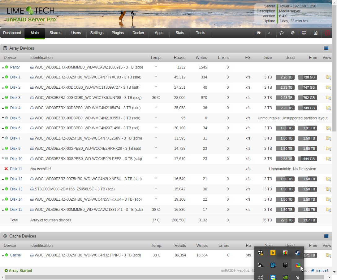

July 11, 20188 yr Author I put back the failed drive and boot. Now its getting worse. Another drive is unmountable. tower-diagnostics-20180711-2110.zip I have also attached my diagnostics. Please somebody helped. Thanks.
July 11, 20188 yr Community Expert That doesn't look good, disk5 has an unsupported partition that would suggest MBR corruption, and the syslog is also showing filesystem corruption on disk13. You are using two SASLP controllers, those controllers are no longer recommend for unRAID since they can drop disks and cause filesystem corruption. I would recommend shutting down the server, replace the SASLP with LSI controllers and then continue the troubleshooting.

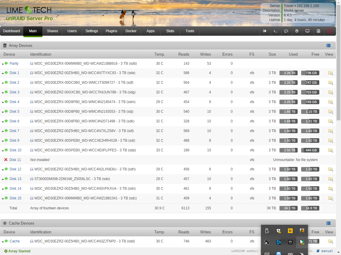

July 13, 20188 yr Author Another day, another unmountable drive.tower-diagnostics-20180714-0615.zip Also, attached diagnostic logs. I have start array in maintenance mode. xfs repair drive 13. start array as normal. still unmountable. start array in maintenance mode. xfs repair -L. start array as normal. still unmountable. stop array. try to mount in unassigned drive. unable to mount in unassinged drive. start array as normal. this is where im currently at now. Please advise. Thanks.
July 14, 20188 yr Community Expert Please advise. Already gave you some advice, you likely have a problem with one or both of the SASLP controllers, be it the known problem they have or one of them is failing causing filesystem corruption, another clue that there is a problem is disk5 which was unmountable before with an invalid partition and is now mounting fine, and not surprisingly it's connect to one of those controllers. Note that if they are the problem and replacing them now won't fix the already corrupt disks, but it should prevent the same from happening to more disks and it might allow xfs_repair to fix the problem on the current unmountable ones. Edited July 14, 20188 yr by johnnie.black
