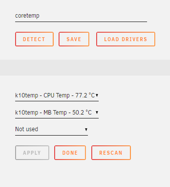

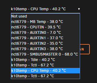

March 6, 20197 yr Hi, Hoping somebody can help please? I have just upgraded from an I7-3770 to an AMD 2950X on a Gigabyte X399 Designare EX with Noctua NH-U9 TR4-SP3 AMD TR Cooler I am getting readings of high 80's with the dynamix plugin but can't be sure it is correct? the heatsink is cool and the heatpipes are only warm to the touch. When in the Bios the CPU Temp is approx 36-40 so not sure if I have an issue or my readings are incorrect? Can anyone offer any advice please? Thank You!
March 6, 20197 yr @mbc0 The Tctl has an offset of 27°C on top of the actual Tdie temperature. The correct temps are Tdie. Depending on the board and the BIOS version, the temps are shown differently. Choose the Tdie instead and you're good. Maybe try to load another driver. 1. Unload the current driver 2. Type in "nct6775" in the available driver section 3. hit save, load the driver and check if more options come up
