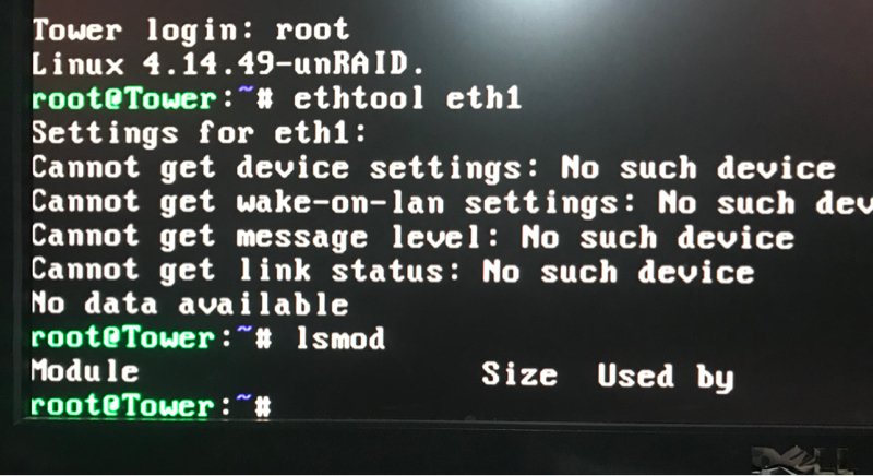

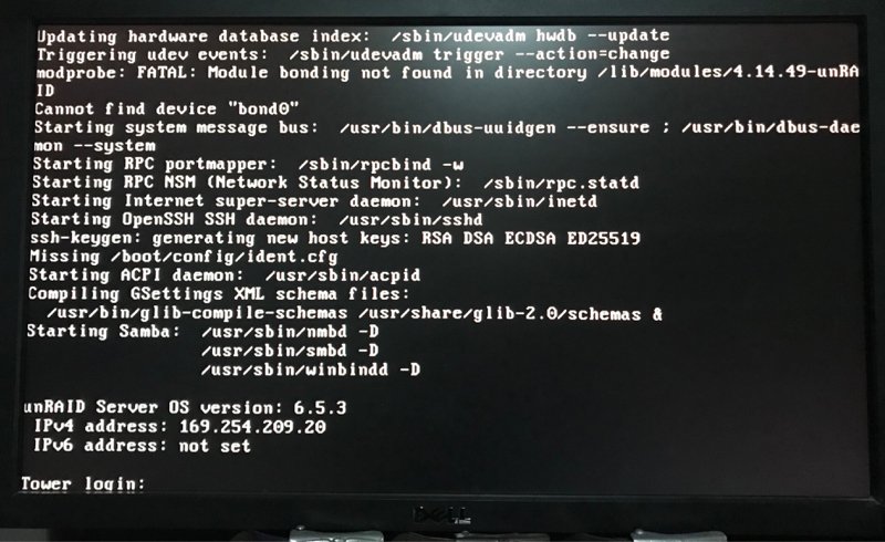

July 8, 20188 yr My main UNRAID is working well, but tried a new build today and having issues... PIcked up a DELL Poweredge R610, which has the H7000 raid controller. Not worried about that at the moment, will either flash it or replace with a PICe sata controller. Anyway, I make a USB boot flash drive with the OSX creator, I set a server name, ARCHIVE-3. I've tried both with DHCP and also manually assigned IP, however when I boot I get the usual unRAID startup, and all is well at the console control prompt. However, the server name has defaulted to Tower and a random ip address outwith what my DHCP server is set for. It is saying 169.254.209.20 when I tried to set it for 192.168.0.40 If I try to login at console with root.(blank) it logs in ok, but can't find the webGUI at either Tower.local or 169.254.209.20 If I try the UNRAID GUI it doesn't find the GUI either.... Any thoughts? Strange why the server doesn't act on the flash boot config???
July 8, 20188 yr Author I have two Ethernet cables attached, maybe something to do with "cannot find bond 0" ????

July 8, 20188 yr Author 35 minutes ago, jonathanm said: Is there an LED showing a live connection at the NICs and switch? 169.254.x.x implies that the box was able to get a link, but not find a DHCP server. Perhaps try switching cables around or plug it in to a different port on the switch or router. Green light at NICs and switch. Swapped cables and ports around, still the same... I'm wondering id there's a weird setting in the R610 BIOS, got lots of oprions for NICs..
July 8, 20188 yr Type diagnostics at the prompt and then copy the resulting file off of the flash drive and post it here.
July 8, 20188 yr Author Weirdly enough, I reformated the flash card, started from scratch with the Unraid boot creator and it worked fine, bizarre.... ? Thanks for advice though, must have been corrupted flash card?
