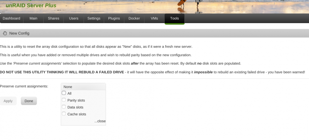

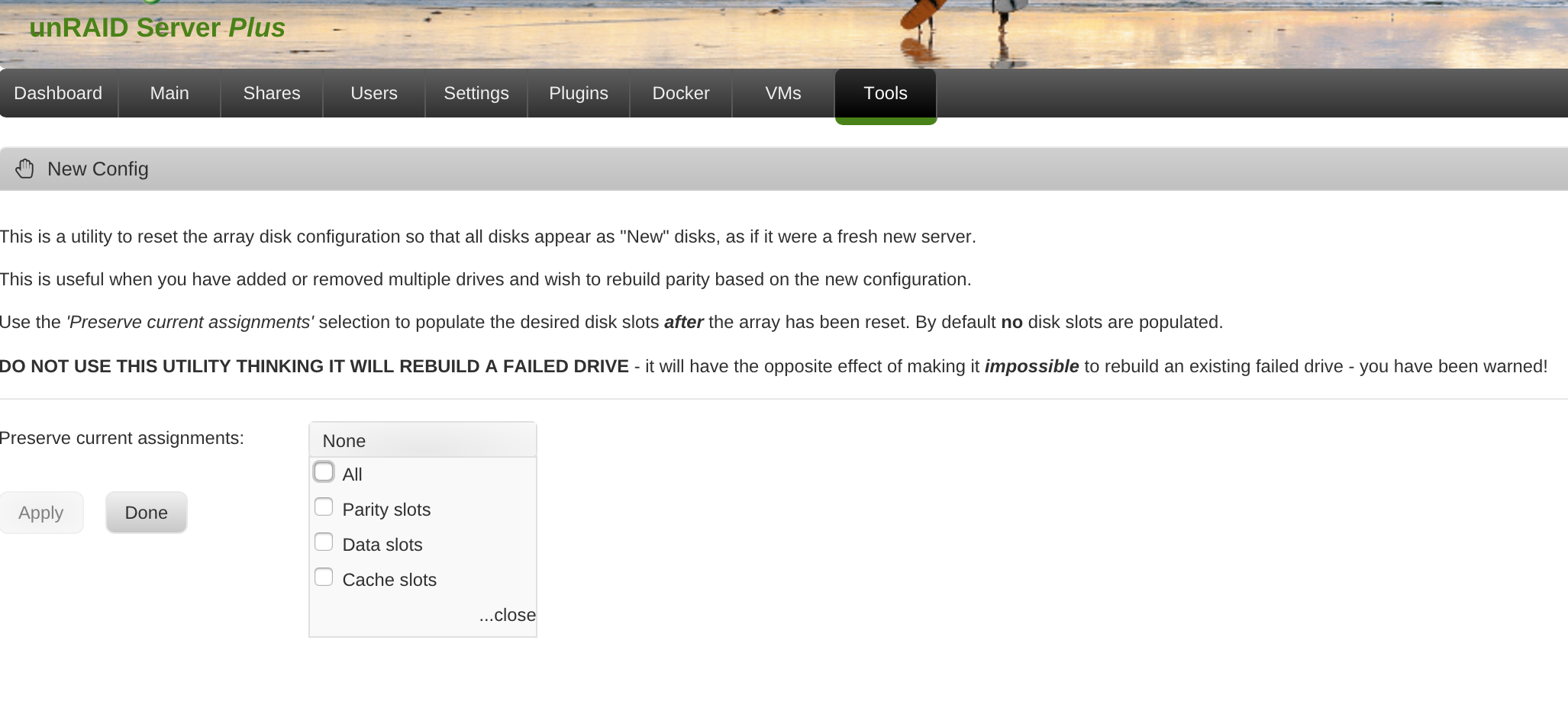

Ok, I've figured out which drive is the parity and which one is the cache and stopped the array.
On the New Config page do I need to  select anything for "Preserve current assignments" or move ahead with None?
Also how do I check "parity is already valid"? Is that another tool or a setting somewhere?
No need to preserve assignments, "parity is already" valid is a check box next to the start array button on the main page

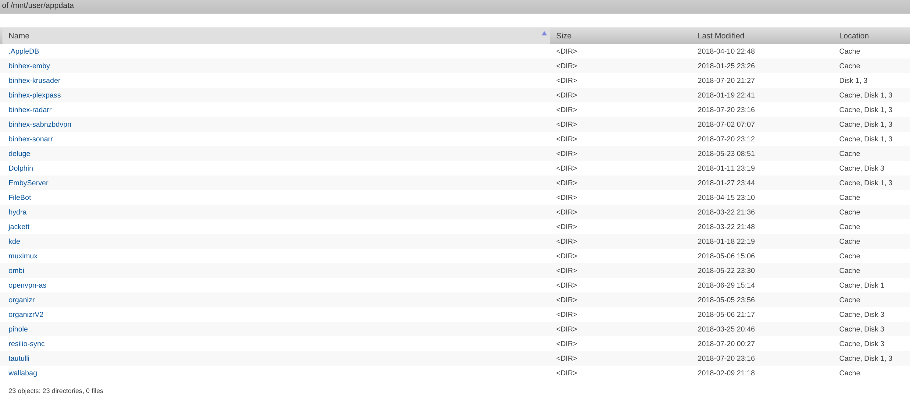

I ran the "Fix Common Problems" plugin and it seems like my AppData share is set to Cache = No when it should be Cache = Yes. I'm trying to figure out how to fix this as most of my files are already on the cache however the files that aren't are spread over all 3 disks it seems like.
Any ideas on how to correct this? Do I have to go in manually and copy every file that is on one of the disks to the cache?
Edited by unRaide
You can set appdata to use cache prefer and run the mover, all files will me moved to the cache drive, unless those files already exist on cache, in that case you''ll need to delete the older ones (on cache or array)

No need to stop, mover won't overwrite files, if it already exists on destination it won't be moved, doesn't matter if it's newer or older.
Worked great, thx again!!!
