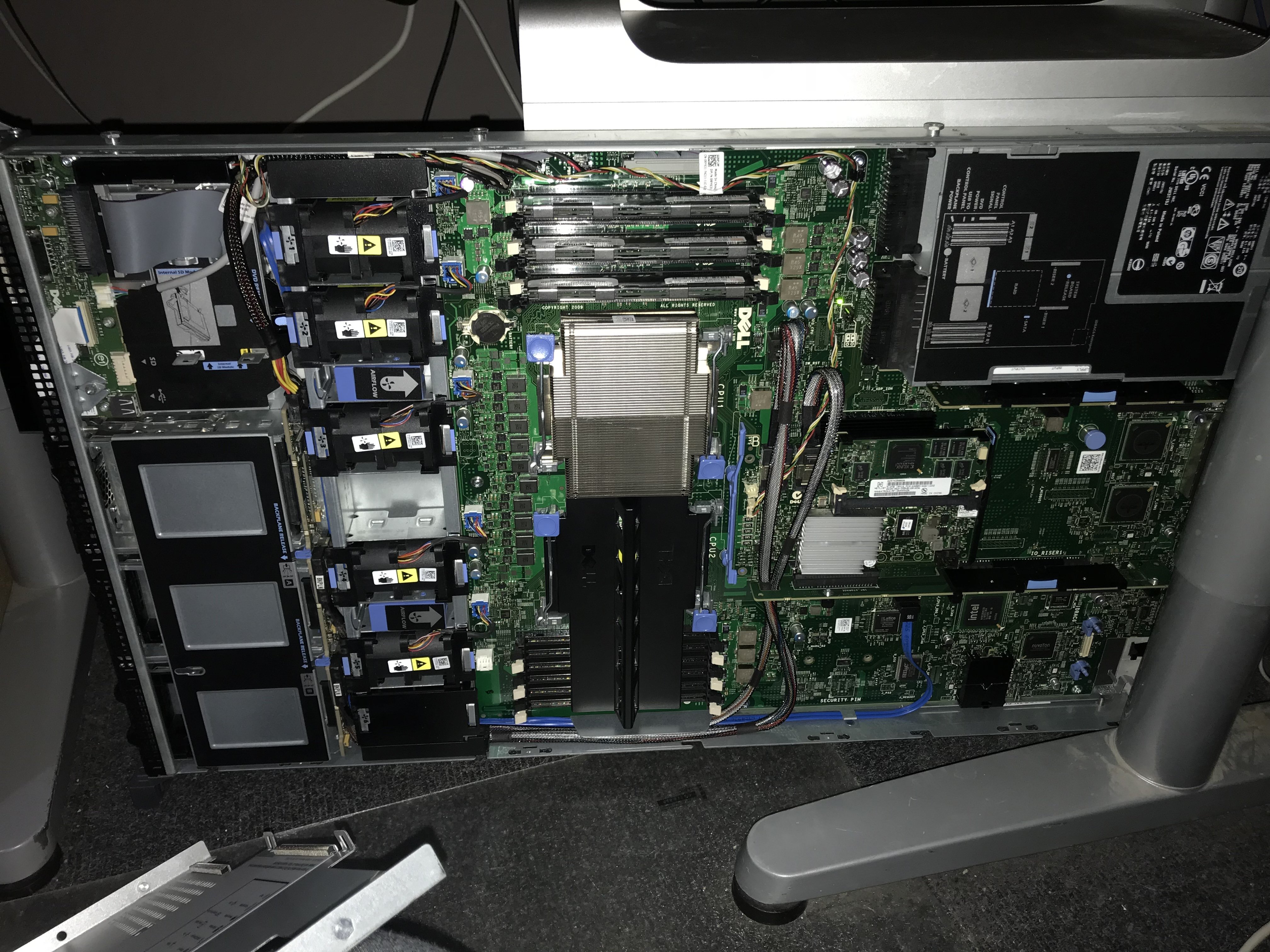

if I bought a H200 or H310 already flashed to IT mode would it be plug and play? Plug into existing cabling and still use the existing backplane?
Heres the inside of my R610...

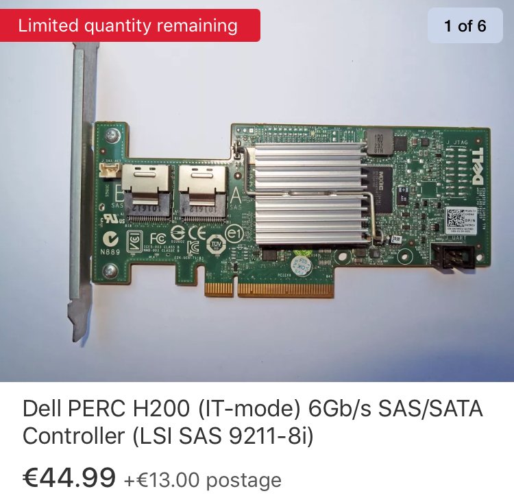

Cheers, I’ve ordered a pre-flashed H200 from eBay. ?
