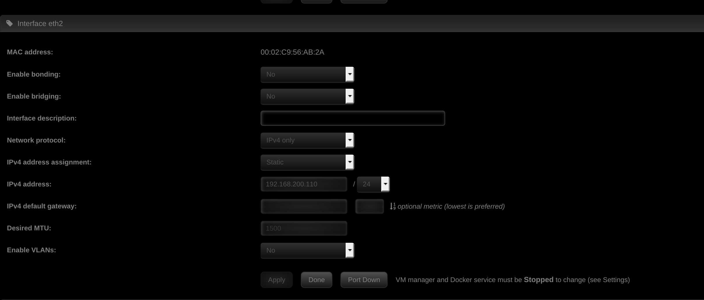

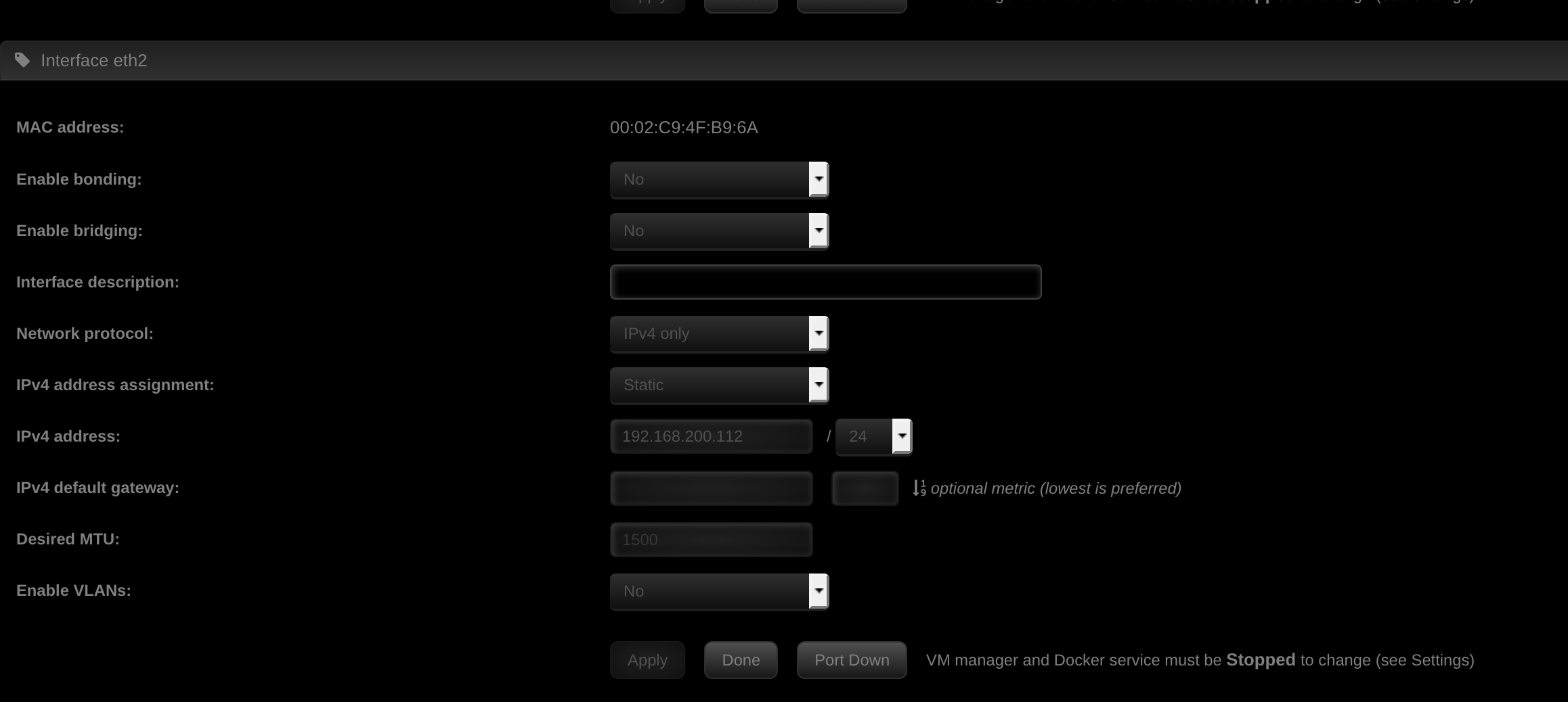

Here is config. Seems that when both interfaces are up, i run ping command, it fails and then takes link back down.
1135334663_ScreenShot2018-07-09at11_19_55AM.thumb.png.6d0b6267ace625c8c6ece9b80d8bec67.png830066125_ScreenShot2018-07-09at11_19_32AM.thumb.png.ec389f498f89d87be8103f7380fe3ef4.png

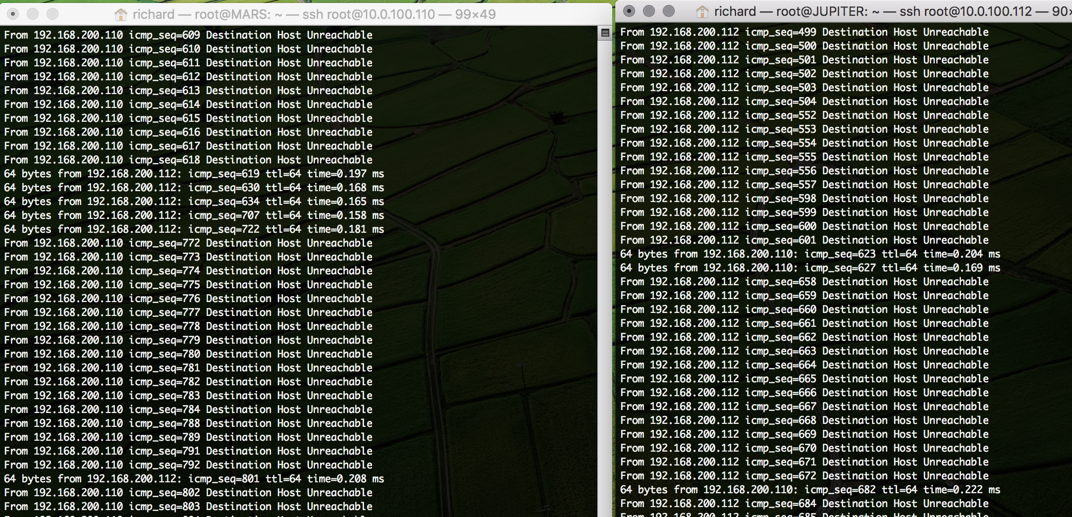

weird, seems every now and then it will ping successfully.. Thoughts?
19 minutes ago, unsainted said:
Thoughts?
Not really, maybe if you can try between unRAID and a Windows desktop to see if it's the same.

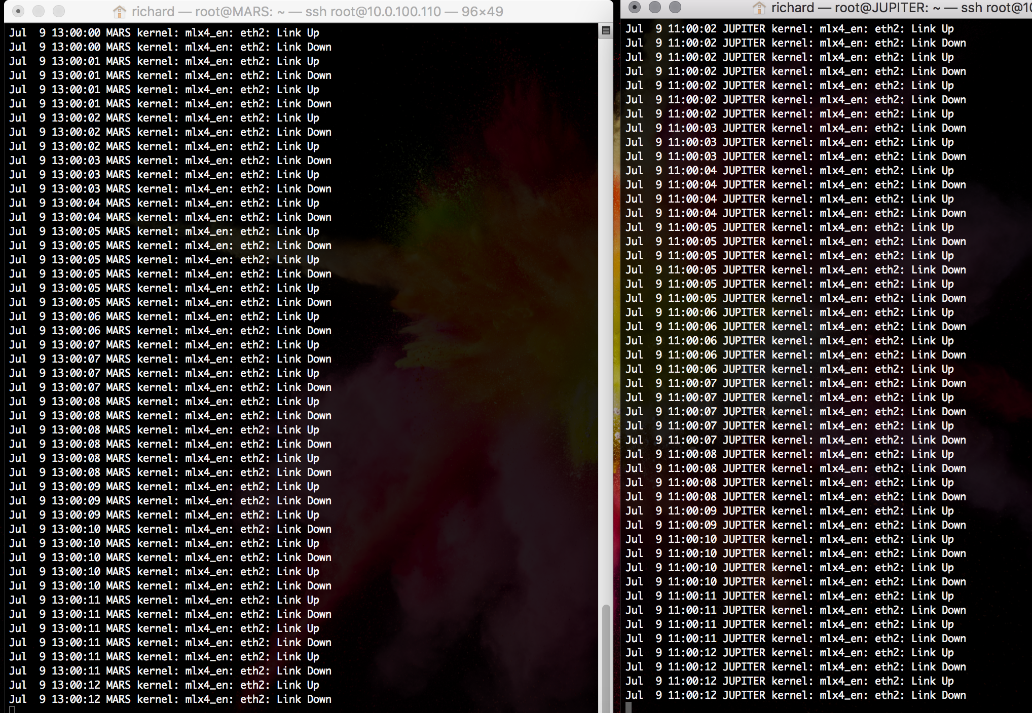

one other thing of note. I ran tail -f /var/log/syslog on each system..
Yep, link is not staying up, that would explain it, but no clue why it's happening, I never used them between 2 unRAID server, but I would expect that once up the link would stay up, until possibly a reboot or power cycle.
