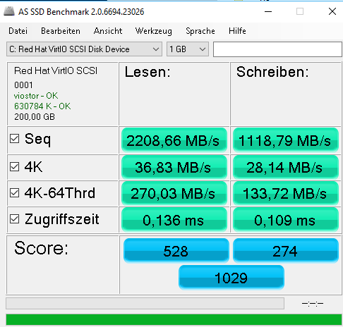

On 7/18/2018 at 3:14 AM, nuhll said:
i did a quick test on my windows 10 VM (which is running just on the cache pool) - no direct passthru
I use 2 850 EVO 500GB

Nothing special. Everything standard.
Just 2 cache SSDs, like i wrote. The VM is Windows 10, on the cache drive(s). Not even "raid", just the standard cache option.
I have relative old CPU Intel® Core™ i3-4370 CPU @ 3.80GHz, but has good single core performance, and only 16 gig ram. Via network i nearly get 1GbiTs (985mbits), but like i said, i didnt touched any special configuration. And there are plenty tutorilas for 10GiG or bonding 2 1gbits.
In the end, like i said, you cant make a wrong choice with unraid, it only cost one time and you can do EVERYTHING with it. If you go any other way, you will have to make compromises somewhere and also its """pretty""" and easy.
Edit: 985mbits from array, not from cache :)
Edited by nuhll

@nuhill is getting these numbers because it is inside a VM that had direct access to the disks. (not over 10gbit network)

The disk speeds i have inside the VM, without unassigned disks, VM is just on the Cache.
The Lan speeds are from a PC to/from the array. (to lands first on cache tho)
Edited by nuhll
