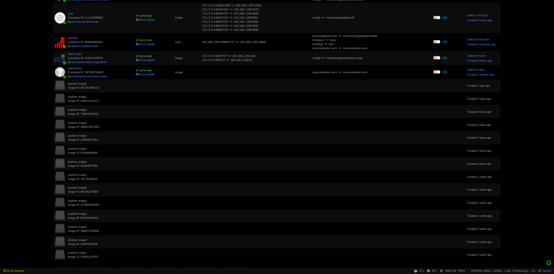

I am using 6.5.3, but i had the problems since my first installation as new unraid paid user with 6.5.0 but the problem persisted with updates.
- I don't have advanced buttons installed. I removed it after seeing other posts about orphan images. The problem persists.
- Any "manual update" from my part, appears that don't create any orphan image  ¿?¿?
- Some dockers has customized ports or variables, but others aren't modified. but since I can not know where each orphan image one comes from ... :(
- I haven't seen any relevant info about this problem on logs or I have not known how to see.
I attached my diagnostics logs. Any help will be welcome.
Thanks in advance.

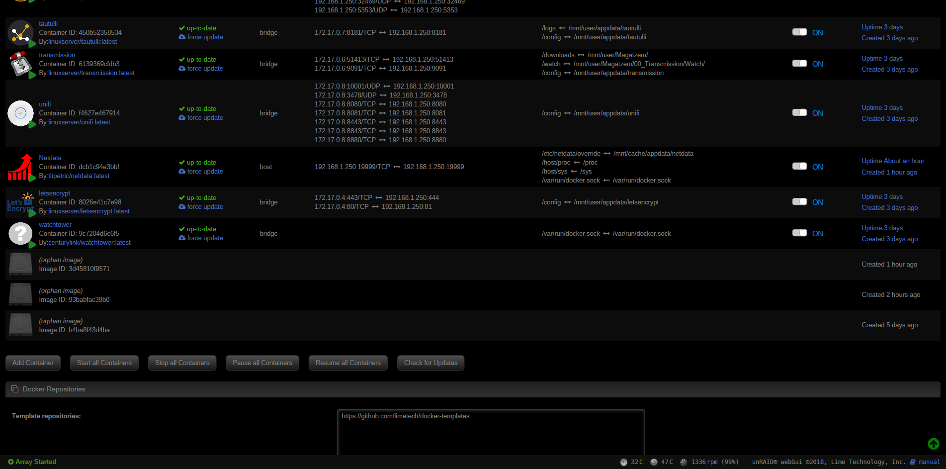

New orphan images appeared.
Anyone has some other ideas to try :)  ???
thanks!

Well after the change the problem persists....
No log errors make me crazy about how to solve the problem. :s
Trying it... i will comment..
Watchtower removed... After some days it is working perfectly.
I will use CA autoupdate for dockers, etc.
Thanks Squid for your help ?
