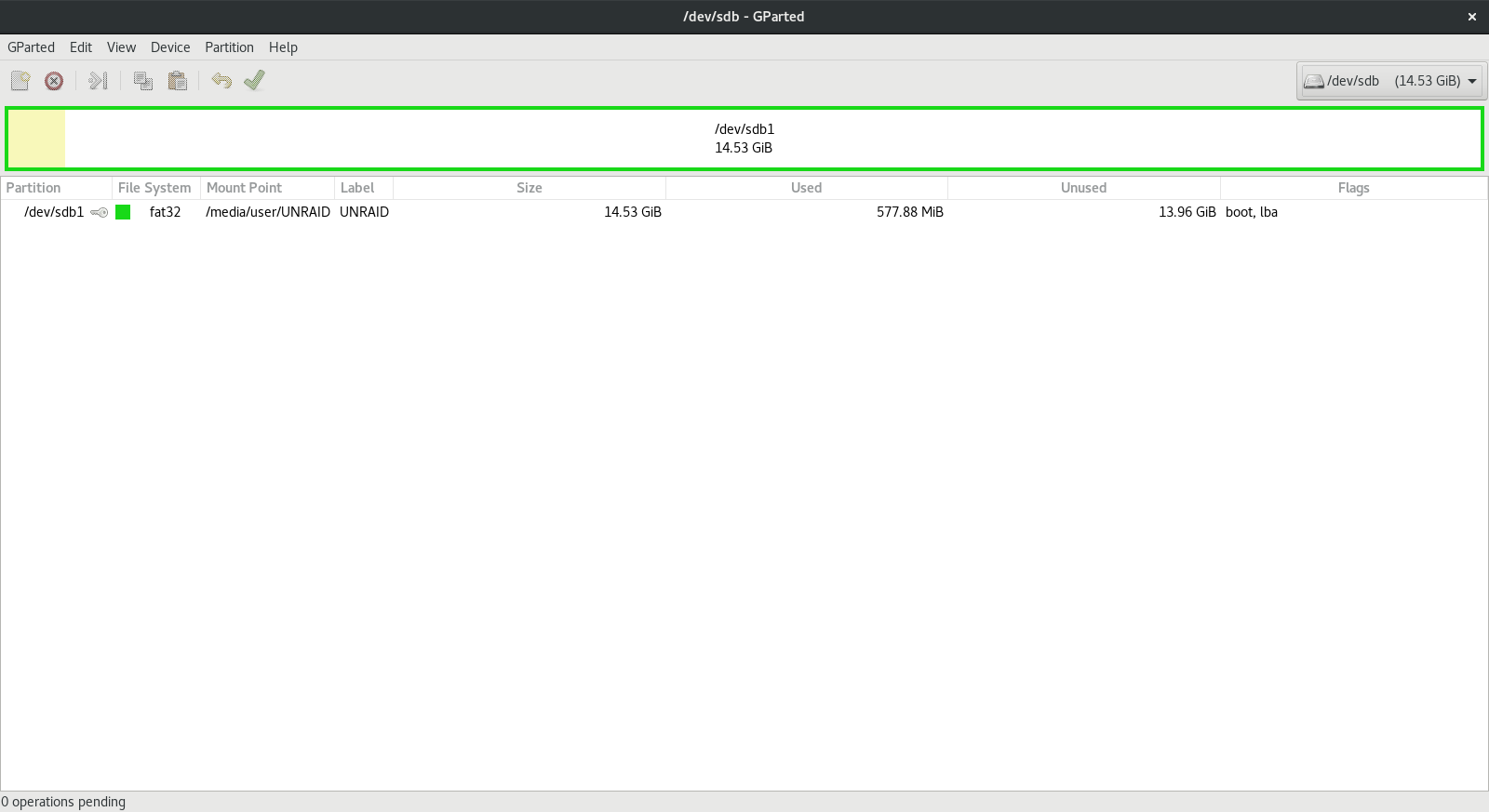

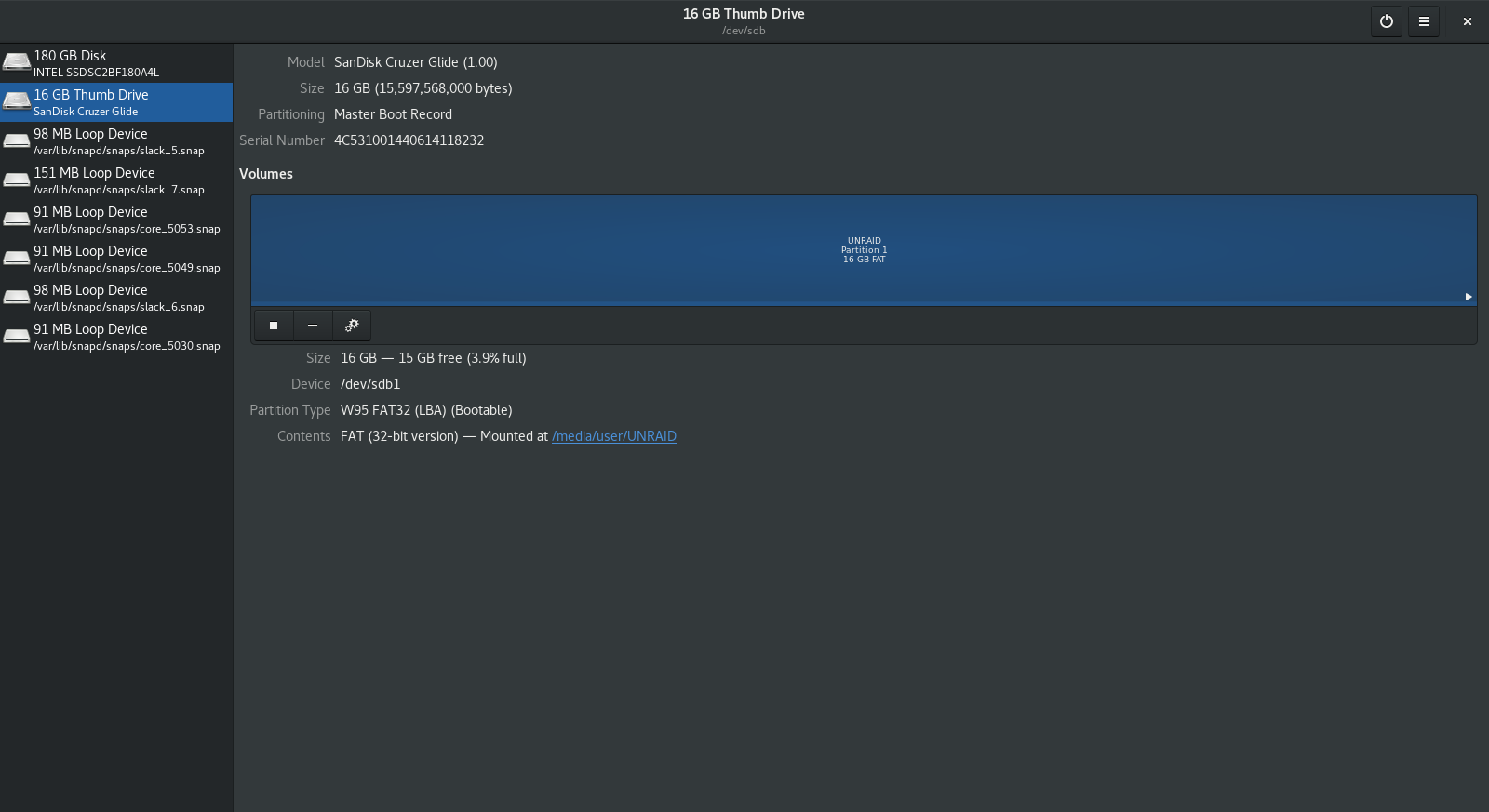

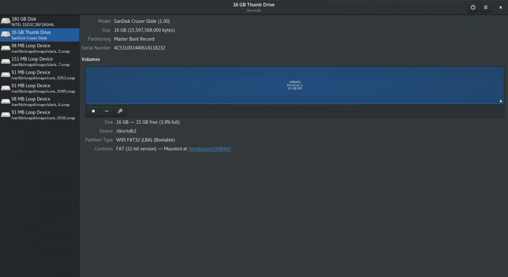

July 15, 20188 yr Author I found the solution. `syslinux` is not installed by default in Debian 9 amd is needed for `mcopy` Steps to create bootable unRAID USB on a Debian machine Insert USB drive Format to FAT (or FAT32) or create FAT partition Download unRAID zip Extract zip Copy files inside extracted unRAID directory to the USB Install `syslinux` with sudo apt install syslinux Navigate to the directory you originally extracted to. For example: cd /home/username/Downloads/unRAIDServer-6.5.3-x86_64/ Run the `make_bootable_linux` script from here (NOT from on the USB drive): sudo bash make_bootable_linux Each time I tried this it failed the first time (I think because my file explorer was open to the USB drive). I run the previous command a second time and it succeeds. Here is the output: user@debian:~$ sudo bash Downloads/unRAIDServer-6.5.3-x86_64/make_bootable_linux INFO: make_bootable_linux v1.3 INFO: The following device appears to be the unRAID USB Flash drive: /dev/sdb Permit UEFI boot mode [Y/N]: y INFO: unRAID USB Flash drive currently mounted to /media/user/UNRAID, copying temporary installer files to /tmp/UNRAID To continue you may need to enter your admin password sudo: /tmp/UNRAID/syslinux/make_bootable_linux.sh: command not found user@debian:~$ sudo bash Downloads/unRAIDServer-6.5.3-x86_64/make_bootable_linux INFO: make_bootable_linux v1.3 INFO: The following device appears to be the unRAID USB Flash drive: /dev/sdb INFO: Temporarily mounting unRAID USB Flash drive to /tmp/UNRAID_TMP_MOUNT Permit UEFI boot mode [Y/N]: y INFO: unRAID USB Flash drive currently mounted to /tmp/UNRAID_TMP_MOUNT, copying temporary installer files to /tmp/UNRAID To continue you may need to enter your admin password INFO: Installing Syslinux bootloader on /dev/sdb1 INFO: Writing MBR on /dev/sdb 0+1 records in 0+1 records out 447 bytes copied, 0.000162011 s, 2.8 MB/s INFO: the unRAID USB Flash drive is now bootable and may be ejected.

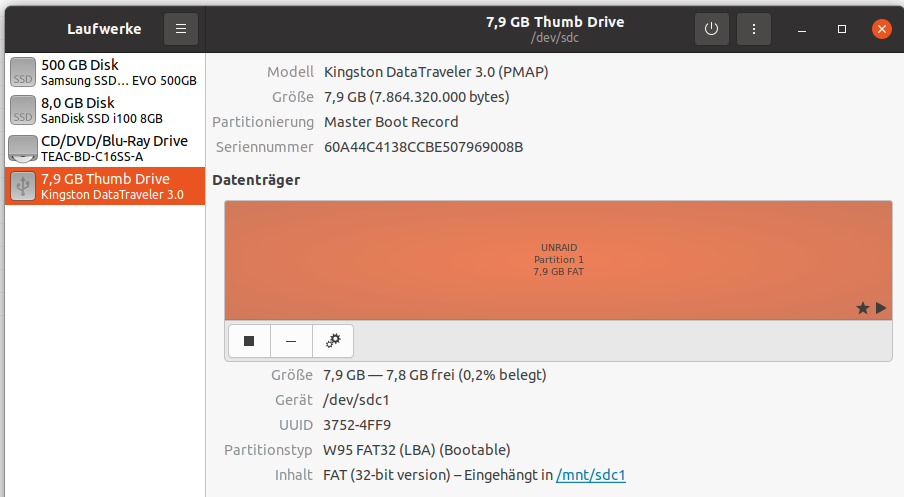

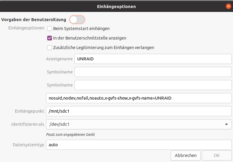

January 19, 20215 yr Hi, i get always the error: phil@phil-700Z7C:~/Downloads/test$ sudo bash make_bootable_linux.sh INFO: make_bootable_linux v1.3 INFO: The following device appears to be the unRAID USB Flash drive: /dev/sdc FAIL: unRAID Flash drive detected but unable to detect where it is currently mounted, aborting! But the USB is mounted. What did i wrong? Best regards, Phil Edited January 19, 20215 yr by horphi added Picture
