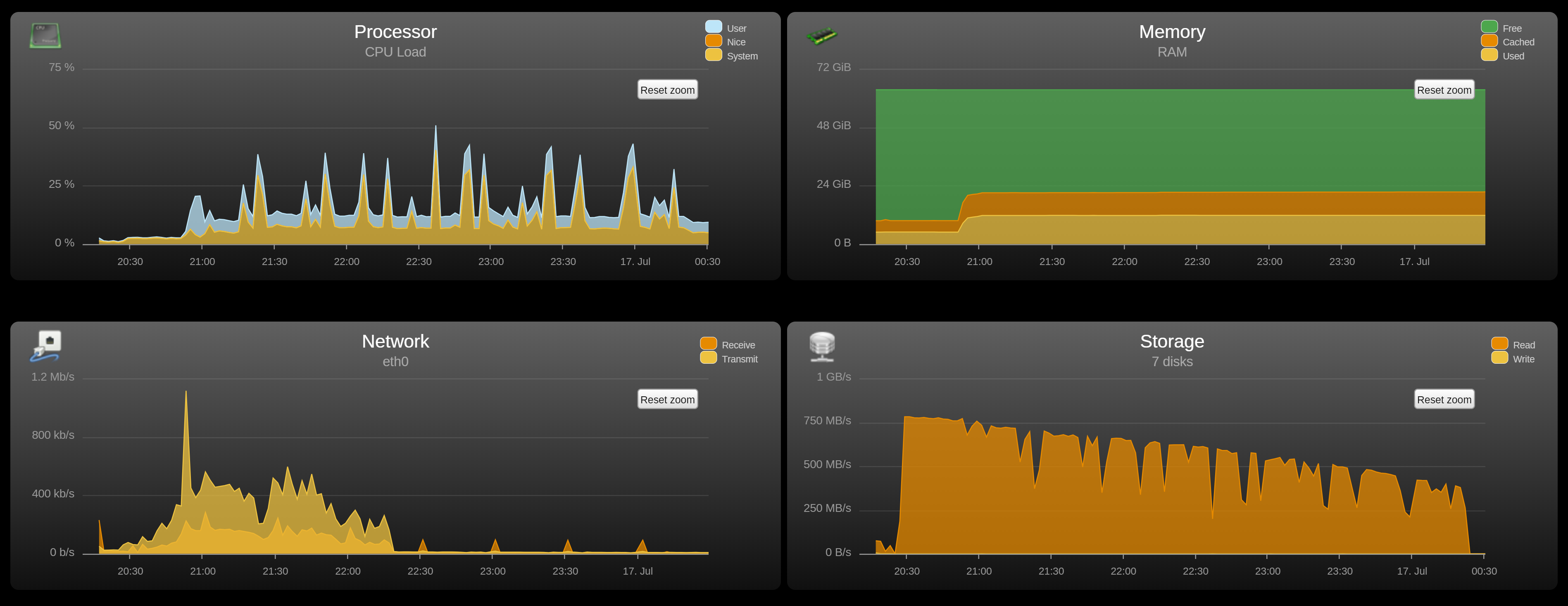

Last weekend I got myself a new Storage-Controller, the HP Smart HBA H240. Previously I was using the embedded controller (HP Smart Array P420i Controller) in HBA mode. However speeds were not as I expected, that's why I bought a plane HBA. With its firmware updated to the latest version it just works great!

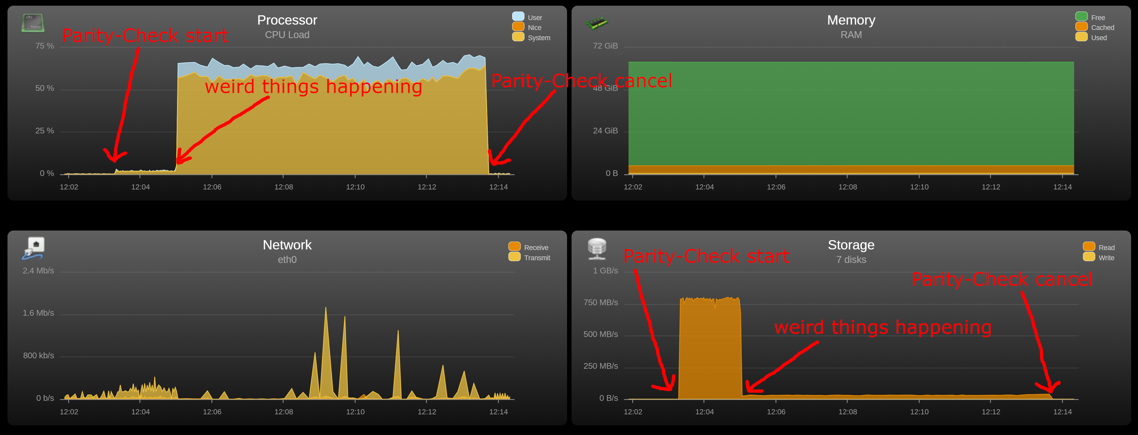

But today, along with my first scheduled Parity Check at 4:00 CEST, I ran into a problem: Disk Speeds were at < 10 MB/sec and CPU usage was very high. The WebGUI, the Terminal and all VMs were therefore very unresponsive.
This is how it looks like, when I start a Parity Check manually:
At first everything looks normal. But not even a minute into the Parity-Check the disk speeds suddenly go below 10 MB/sec while at the exact same time the CPU usage rises.
Here is an excerpt of my syslog from the time, where I started the Parity-Check:

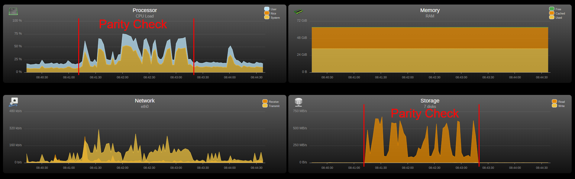

Yesterday I uninstalled the HP H240 HBA and connected the SFF-8087 cables from the backplane to the embedded HP P420i (which I previously configured to operate in HBA mode).

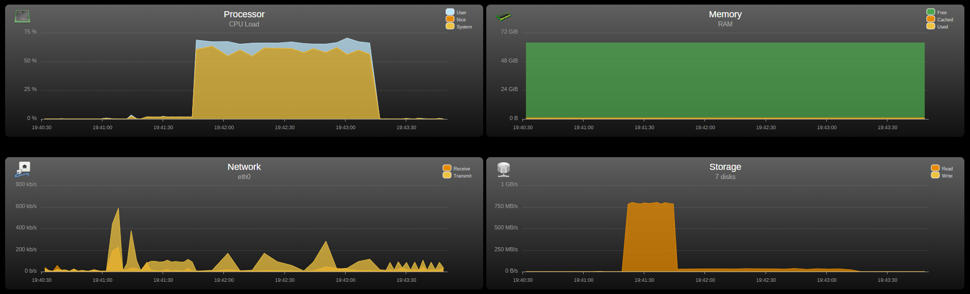

Overnight I successfully completed a Parity Check, however I noticed some strange "spikes":
It's the same thing happening here like with the HP H240 HBA. The disks read speeds suddenly drop while the CPU usage rises. The only difference here is that with the HP H240 HBA things remained bad. With the HP P420i it looks like it could sort of "recover" somehow.
I am suspecting the new SFF-8087 cables since I had to swap the original ones that worked perfectly with the embedded controller with the ones that came with the new HP H240 HBA. (The original cables had angled connectors so they didn't fit in the ports of the HBA.)

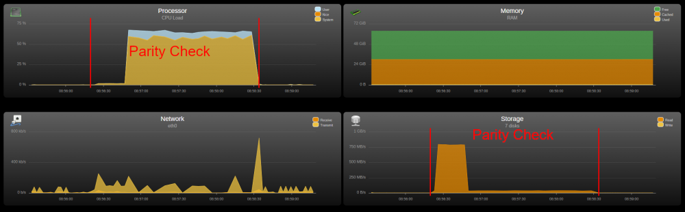

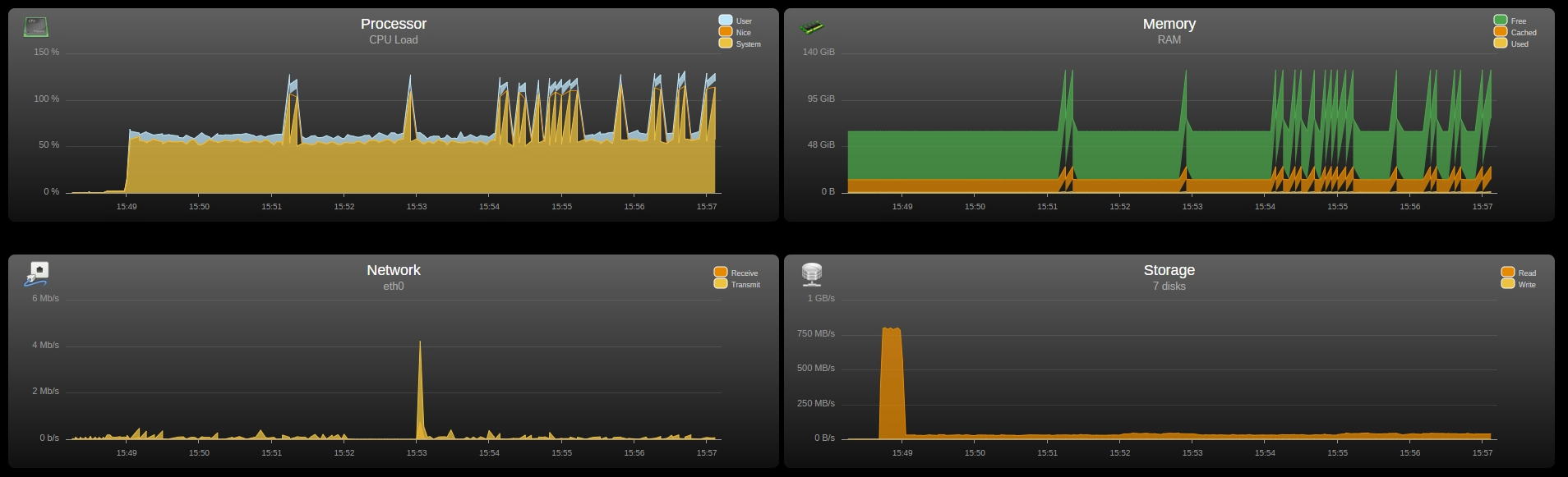

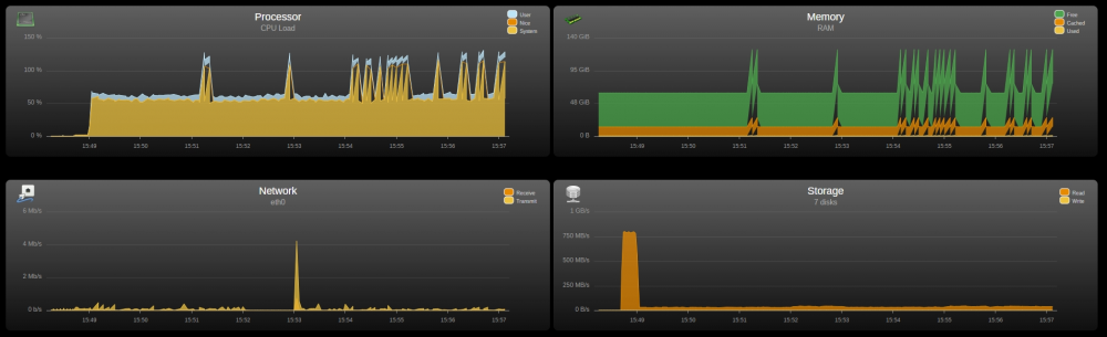

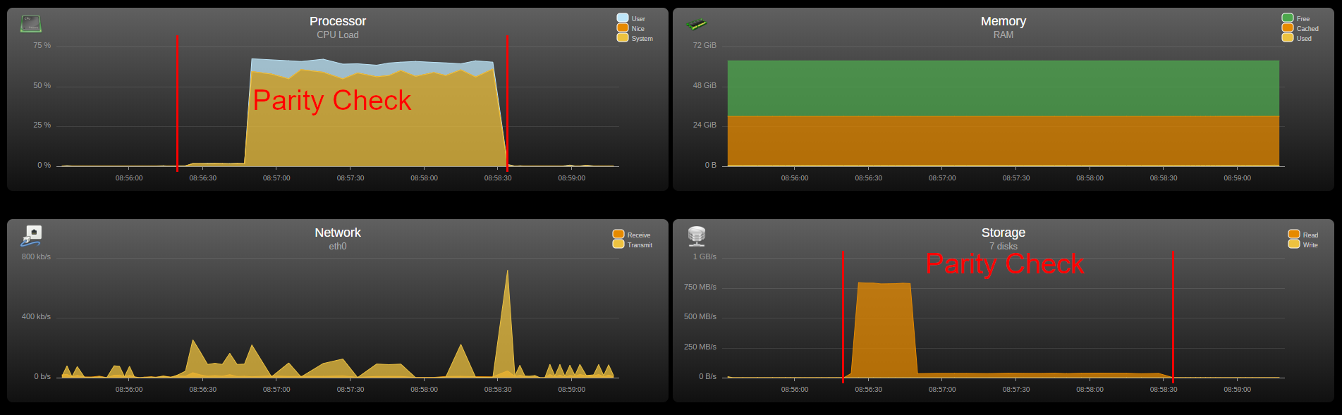

Hello again,
my LSI SAS 9207-8i just arrived. I have installed it and it works perfectly. Except during Parity Checks... NMIs are still there.
Even the plugin system.stats is outputting improssible values because of the "system overload".
I dont't even know anymore what to do now. I'm very frustrated right now.

An excerpt from my syslog during the parity check (started at 19:41:20):
Jul 26 19:41:20 unRAID-Server emhttpd: req (2): startState=STARTED&file=&cmdCheck=Check&optionCorrect=correct&csrf_token=****************
Jul 26 19:41:20 unRAID-Server kernel: mdcmd (40): check correct
Jul 26 19:41:20 unRAID-Server kernel: md: recovery thread: check P ...
Jul 26 19:41:20 unRAID-Server kernel: md: using 1536k window, over a total of 1953514552 blocks.
Jul 26 19:42:12 unRAID-Server sSMTP[5210]: Creating SSL connection to host
Jul 26 19:42:12 unRAID-Server sSMTP[5210]: SSL connection using ECDHE-RSA-AES256-GCM-SHA384
Jul 26 19:42:14 unRAID-Server sSMTP[5210]: Sent mail for [email protected] (221 2.0.0 fwd26.t-online.de closing. / Closing.) uid=0 username=root outbytes=760

Edit: I saw some "Advanced CPU Settings" in the BIOS but I did not touch them. Maybe some of these setting is causing those errors?
Edited by JuliusZet

When all of my VMs are running (mostly game servers) and a Prity Check is being started my system stats look like this:
During the Parity Check all my gameservers have very bad performance drops.
When I stop all VMs and start a Parity Check my graphs look like this:
I have no clue what is going on here. :(
unraid-server-diagnostics-20180727-0908.zip

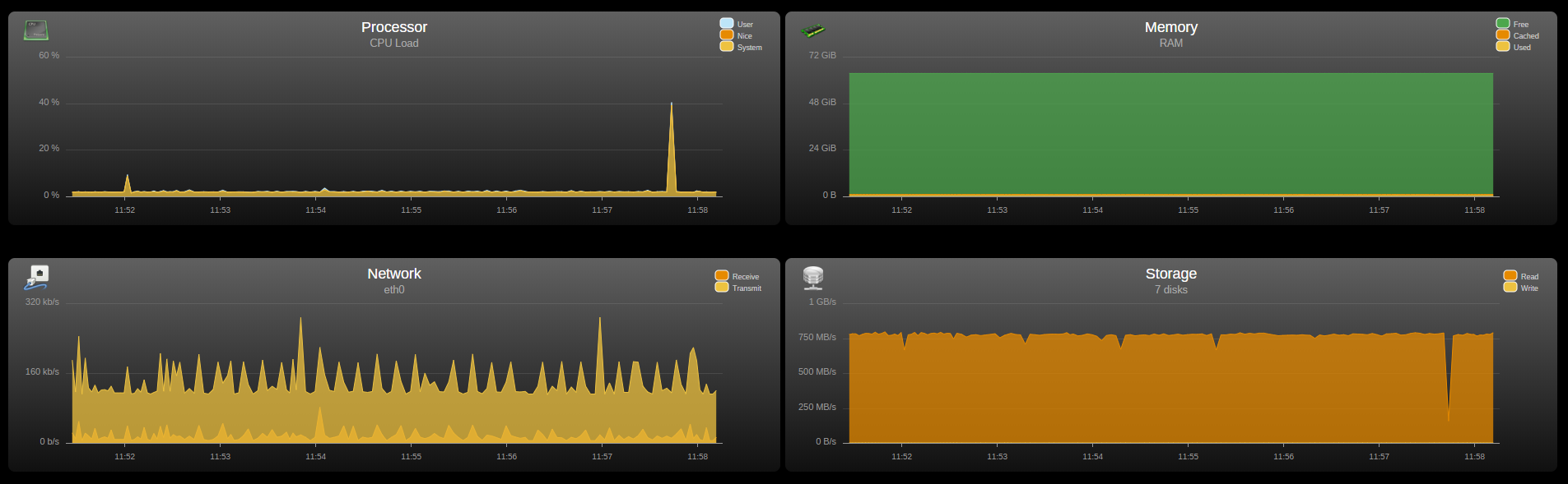

I just figured it out!
What I just did is I applied your Tunables from your previous post and started a Parity Check. The NMIs started immediately. Canceled the Partiy Check and started it again just to double check ... Yep ... disk speeds are bad and CPU usage is high right from the start of the Parity Check.
Then I reset the Tunable values to default. Started the Parity Check again and ... it happened like before: At first everything looks normal (disk speeds as expected from 4 HDDs and CPU usage ~2 %) but after a few seconds the NMIs start.
So I went like: Hmm... When I increase the Tunables it goes worse. What if I now decreased them? I thought taking the default values and halving them would be a good start:
Tunable (nr_requests): 64
Tunable (md_num_stripes): 640
Tunable (md_sync_window): 192
Tunable (md_sync_thresh): 96
Wow! I did not think that this would work! Look at the system stats graphs:
The only thing I need to figure out now is what these strange "spikes" are. The syslog shows no NMIs, no errors, nothing! Don't get me wrong, I'm really very glad that it is finally working! However these spikes are not normal.
I think that it would help if I had some up-to-date information about Tunables what exactly they stand for and what they do. I'm sure that this was discussed already on the forum somewhere but I can't find it. Could you link a post where it is explained? That would be very great!
Thank you very much!
Edited by JuliusZet
