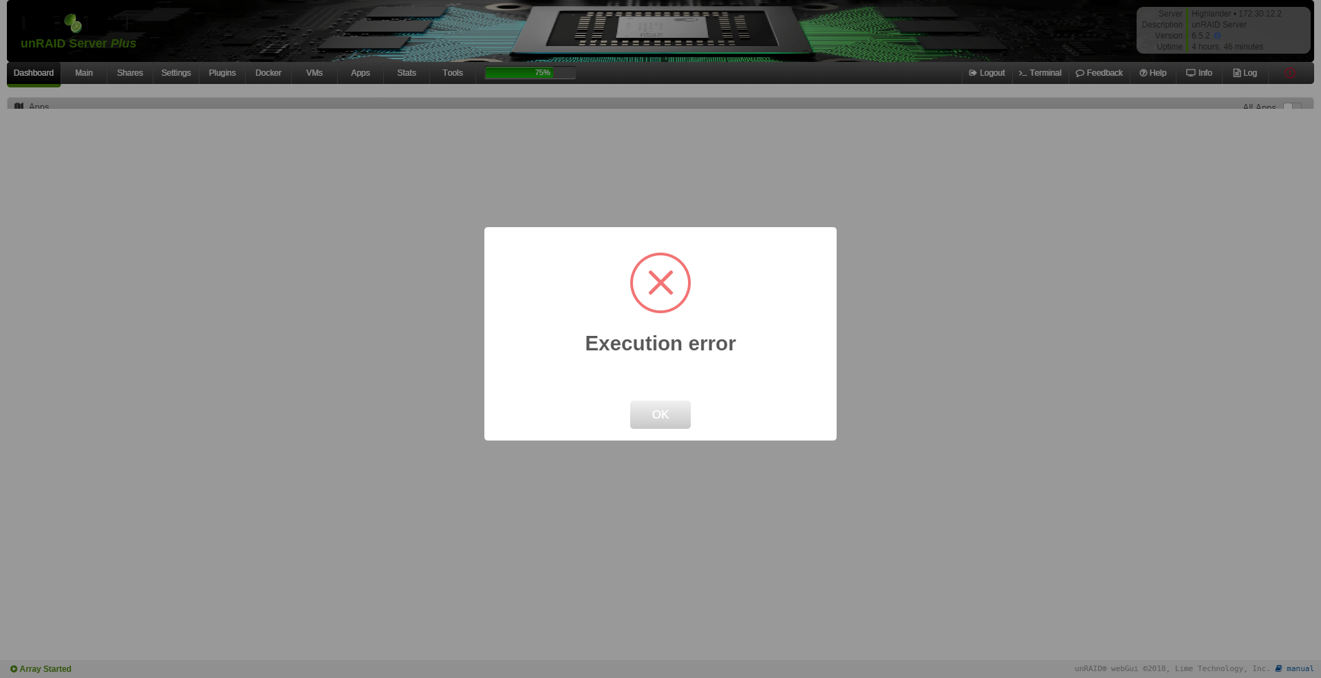

I tried disabling ssl and I just stopped nzbget - took forever (mins) to stop then threw up an error message:
89469298_FireShotCapture138-Highlander_Dashboard-http___highlander_Dashboard.thumb.png.421b6d468c9b6de05c2c9800d4bc2a40.png
