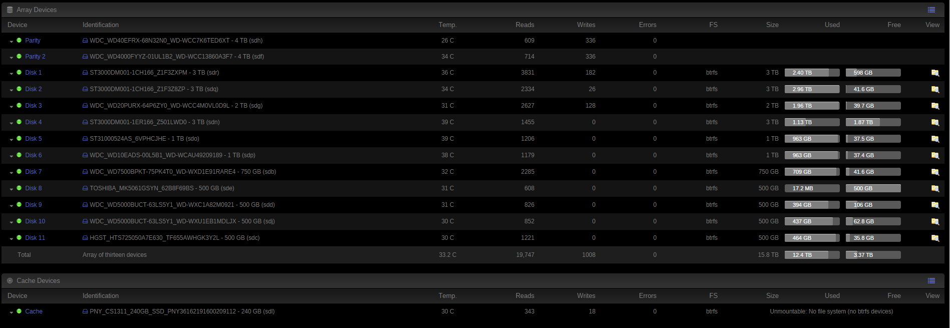

i need some help im soso with linux so any help would be appreciated. Currently im having a problem with my cache drive see screenshot below. i have tried replacing the cache drives with others i have and i still get the unmountable error. i have tried booting into maintenance mode and running the repair and it said it had no errors.
i should mention this started happening earlier in the week after a power outage. i used to have 2 SSDs in raid 1 i have since removed one thinking it might have been the issue but now it seems to be more along the lines of anything assigned to cache.
