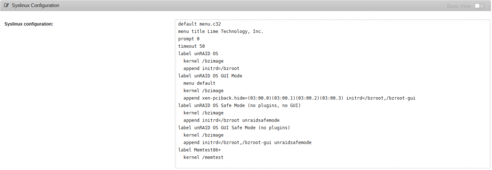

I am having the same issue, I have tried the above suggested method but upon reboot after adding xen-pciback.hide=(01:00.0)(01:00.1)(01:00.2)(01:00.3), my network ports are still showing in unraids network settings? the command doesn't seem to do anything.
Then you have done something wrong. Post your syslinux.cfg here.
Edit: Looks like you didn't read the first number correctly. It's 81, not 01.
Edited by saarg

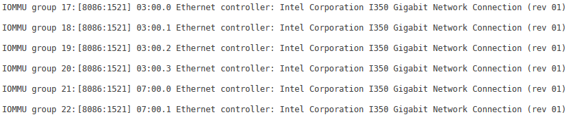

IOMMU
IOMMU group 17:	[8086:1521] 03:00.0 Ethernet controller: Intel Corporation I350 Gigabit Network Connection (rev 01)
IOMMU group 18:	[8086:1521] 03:00.1 Ethernet controller: Intel Corporation I350 Gigabit Network Connection (rev 01)
IOMMU group 19:	[8086:1521] 03:00.2 Ethernet controller: Intel Corporation I350 Gigabit Network Connection (rev 01)
IOMMU group 20:	[8086:1521] 03:00.3 Ethernet controller: Intel Corporation I350 Gigabit Network Connection (rev 01)
IOMMU group 21:	[8086:1521] 07:00.0 Ethernet controller: Intel Corporation I350 Gigabit Network Connection (rev 01)
IOMMU group 22:	[8086:1521] 07:00.1 Ethernet controller: Intel Corporation I350 Gigabit Network Connection (rev 01)
syslinux.cfg
default menu.c32
menu title Lime Technology, Inc.
prompt 0
timeout 50
label unRAID OS
  kernel /bzimage
  append initrd=/bzroot
label unRAID OS GUI Mode
  menu default
  kernel /bzimage
  append xen-pciback.hide=(03:00.0)(03:00.1)(03:00.2)(03:00.3)initrd=/bzroot,/bzroot-gui
label unRAID OS Safe Mode (no plugins, no GUI)
  kernel /bzimage
  append initrd=/bzroot unraidsafemode
label unRAID OS GUI Safe Mode (no plugins)
  kernel /bzimage
  append initrd=/bzroot,/bzroot-gui unraidsafemode
label Memtest86+
  kernel /memtest
I have since tried the card in different slots.
Edited by WingsGB
2 hours ago, WingsGB said:
IOMMU

You need a space after the last bracket.
Label unRAID OS GUI Mode
  menu default
  kernel /bzimage
  append xen-pciback.hide=(03:00.0)(03:00.1)(03:00.2)(03:00.3) initrd=/bzroot,/bzroot-gui
I have tried with and without a space at the end, it makes no difference.
Any other suggestions.

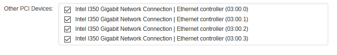

If everything is on one line and there is a space after the last bracket, it should not show up in unraids network settings.
It will show up in the list of all devices on unraid though.
You need to post your diagnostics.
I have attached my log file and below are some picture.
appreciate the help.
screenshot-4e99bf1cbe33ef4ea018254411cbd67e1f68a95b.unraid.net-2018-08-14-16-48-58.png.e9159bb4ea51ad2338c7a44aa840f9ba.png
screenshot-4e99bf1cbe33ef4ea018254411cbd67e1f68a95b.unraid.net-2018-08-14-16-50-32.png.475d0ab2e365cbef75189ad46d917d47.png
screenshot-4e99bf1cbe33ef4ea018254411cbd67e1f68a95b.unraid.net-2018-08-14-16-49-55.thumb.png.523e676189a5f79428550c1ed6cb9f58.png
screenshot-4e99bf1cbe33ef4ea018254411cbd67e1f68a95b.unraid.net-2018-08-14-16-51-10.png.0abc839a6100f2509cc74075157bef02.png
htpc-diagnostics-20180814-1653.zip

I tested on 6.5.3 and it works as expected here. I have no idea what is going on on your side, but there is something strange going on.
You shouldn't get anything in the other devices list using pciback. Or was that screenshot taken after trying to pass it through to a VM?
Yes the screenshot was taken after i added the <hostdev> to the xml, i didnt do this untill after editing syslinux and rebooting. I have not tried running the VM yet as the ports are showing in the "network settings" so decided not to go any further
How do you edit the syslinux.cfg?

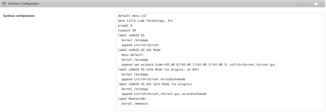

I edit it via the webui but after you saying that i thought i would open up the actual file on the flash drive, /boot/syslinux/syslinux.cfg
the changes i had made was in the file.
I was thinking that there might have been some weird characters in the file. I have seen others had that problem lately.
Maybe try to edit the file in a linux file editor (or notepad++ on windows) and write it again. Do not copy/paste it.
It looks like the xen-pciback.hide= is not recognized from the boot command by the kernel, as it loads the igb module instead of pciback.
? I opened up the file in different editors first to compare, i noticed some margin alignment being out but thats it. To be safe though i copied the default cfg- and started again without copy/ paste.
rebooted and same issue?
