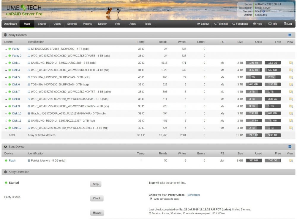

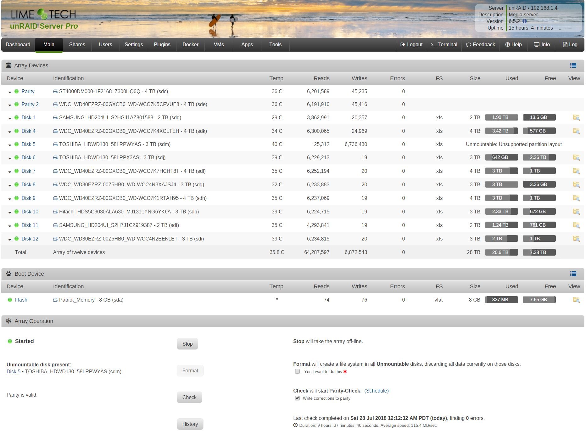

The second drive just finished overnight.  However, now with this latest 3tb Drive 5 I get this 'Unmountable: Unsupported partition layout' message.  There is a format checkbox at the bottom.
1)  Is my data okay?  The 9.5 hours must have rebuild the array on to to other drives.  (I still have the 1tb drive it replaced untouched.)
2)  What has happened with Disk 5?  Do I just tick the format box and presume all is well?

First time I see this, but it should be OK after a reboot:
Jul 27 14:34:27 unRAID root: Creating new GPT entries.
Jul 27 14:34:27 unRAID root: Warning: The kernel is still using the old partition table.
Jul 27 14:34:27 unRAID root: The new table will be used at the next reboot or after you
Jul 27 14:34:27 unRAID root: run partprobe(8) or kpartx(8)
Jul 27 14:34:27 unRAID root: The operation has completed successfully.

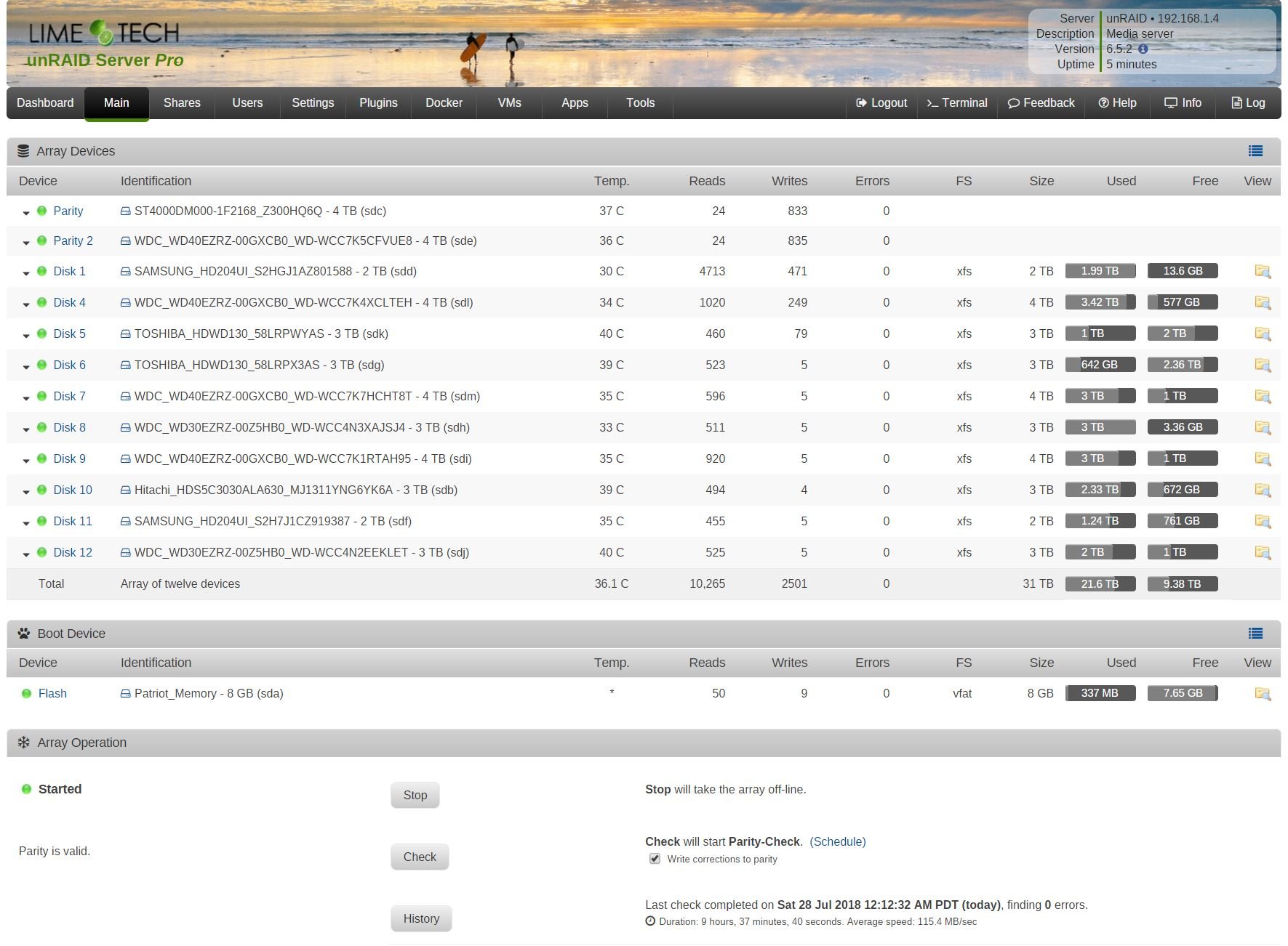

Thanks, after reboot it did resolve.
