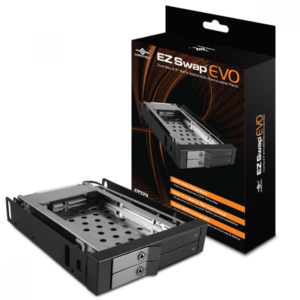

so either way i will have to start from scratch using unraid? i dont have any important data on the driver really. i would just like to avoid having to download the games on each vm due to it taking 4 hours and i am not able to copy it. also the ssd is easily removable with the ez swap evo so thats not a problem. also now that you mention "cache slots" can i use the ssd for a cache drive? if so that would be awesome.
